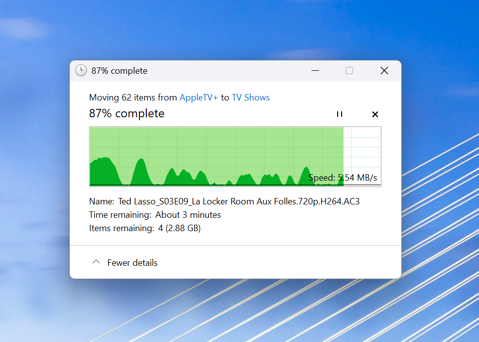

I am trying to improve transfer speeds between external computers and my unraid. i feel as if the speed dropped after the new update. The screenshot shows the transfer speed between my laptop on wifi and my unraid through hardline. I can deal with maybe 5 MB/s of transfer speed but it will periodically drop to 0. when it first starts it ramps up as you can see. The transfer was approx 20GB over 30 minutes. Any tips would be appreciated.
image.png.40e827f2488ea8743669371b87a3c3b9.pngzenithicus-diagnostics-20250512-2315.zip

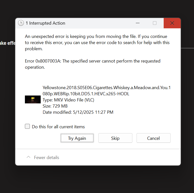

Below is a file transfer between shares too. i can only think the speed stayed at 0 for too long and triggered this error.

its transferring from my laptop (high performance) and into the share designation. so far it is still happening. Goes from 50 mb transfer speed for about 5 seconds then dips to approx 5 to 0 mb
