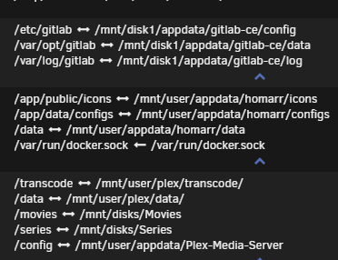

4 minutes ago, Maertuerer said:
18, of which only 6 were running all the time.
Do any of them have a host path that isn't to a user share?
I am not completely understanding that question (noob), but is this what you are inquiring about?
Both homarr settings, as well as gitlab data are gone
Vaultwarden is still completely fine: /data/mnt/user/appdata/vaultwarden
Data in /mnt/disk1/JDownloaderDownloads is fine, Data in /mnt/disk1/appdata/jdownloader2/ has been reset
So it looks like only docker data in  /mnt/disk1/appdata/ has been reset to the default values?
Unfortunately, for homarr that would not explain the problem...
Edited by Maertuerer
