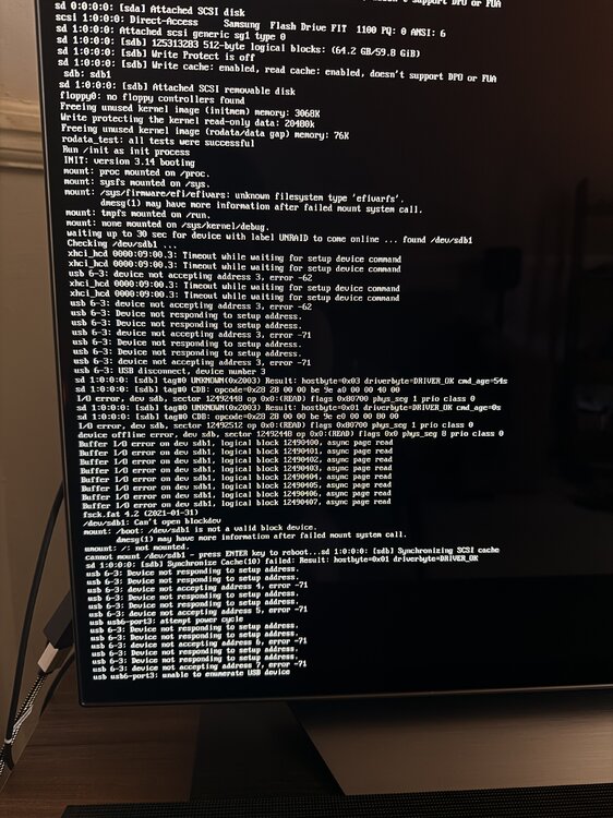

I've been running unraid for over a year, decided to update today from 7.0.1 to 7.1.2, surprised it didn't come back online. So I plugged an HDMI cable to check what was up and noticed it was booting straight into the bios, I changed the USB drive to another port, force reboot and it started booting but to this error. Apologies for being a photo, as I have the server in my living room, never plugged to a monitor. Any idea on what to do here?IMG_0932.thumb.jpeg.50c7f8c609fa226804550b31795edbc1.jpeg

is this samsung disc your cache SSD?
It looks like it died and keeps unraid from starting.
Plug it off completly and see if rebooting works again.

Samsung Flash Drive FIT 1100 is the flash drive I use.
Cache SSDs are both a Sabrent and a Crucial. As can be seen in my signature.
How would it die with an update though? When it's been rock solid oO

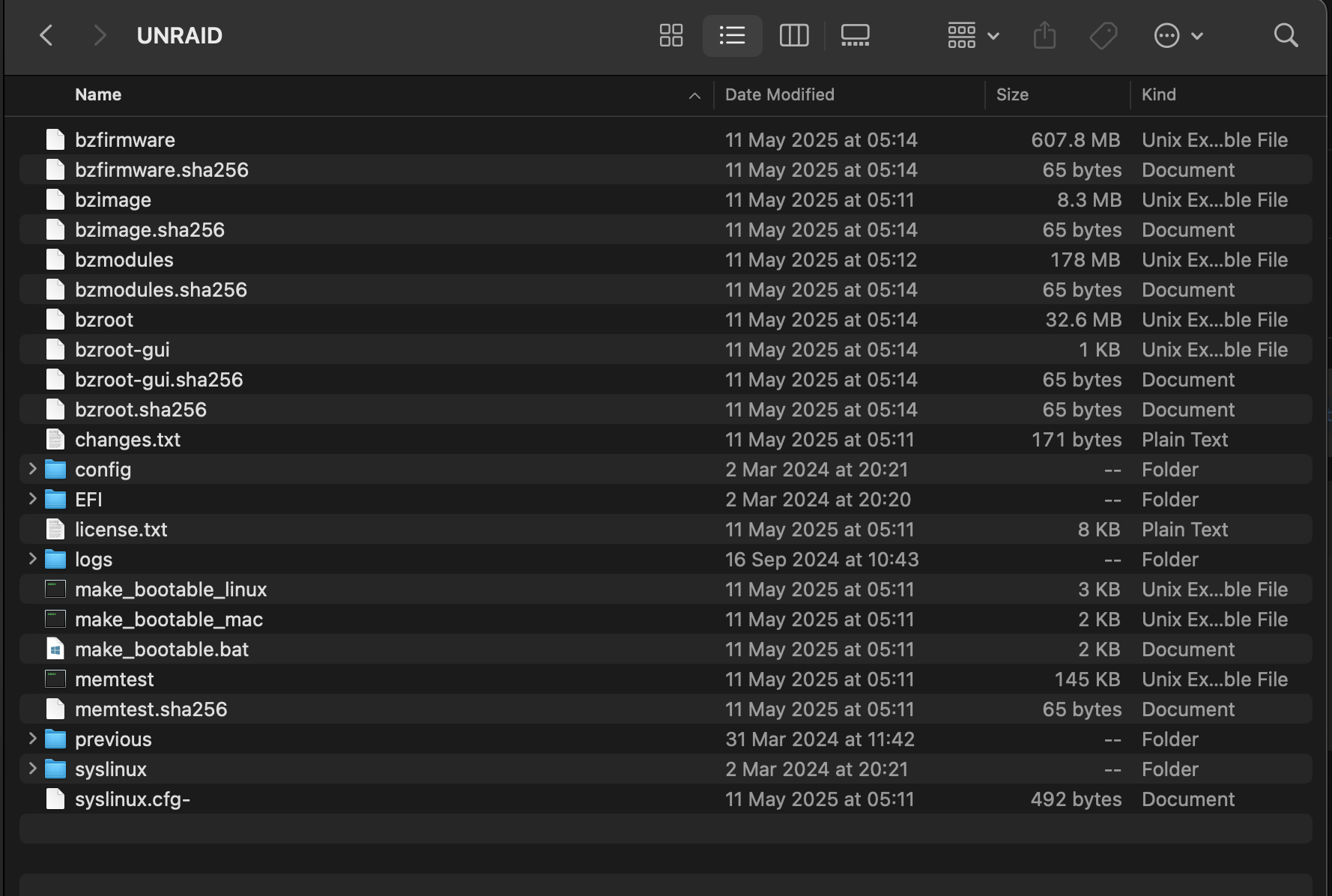

I just plugged the flash drive on my mac and it looks fine.

You could try downloading the zip file for the release and extracting all the bz* type files overwriting the ones on the flash drive.
An update is one time a lot is written to the flash drive so it can sometimes cause errors accessing it that would not otherwise be seen.

Yep, that worked. Wow lol. That simple. Just replaced the bz* files and instantly booted perfectly.
