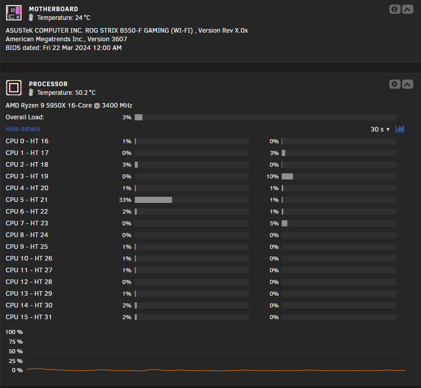

Just to update on the server crashes. I have turned off the C-power in bios and seems like its stable I have been running the server for 4 days without issues.
Below is my system just in case someone runs into same issues. I hope C-power was the problem 🙂
