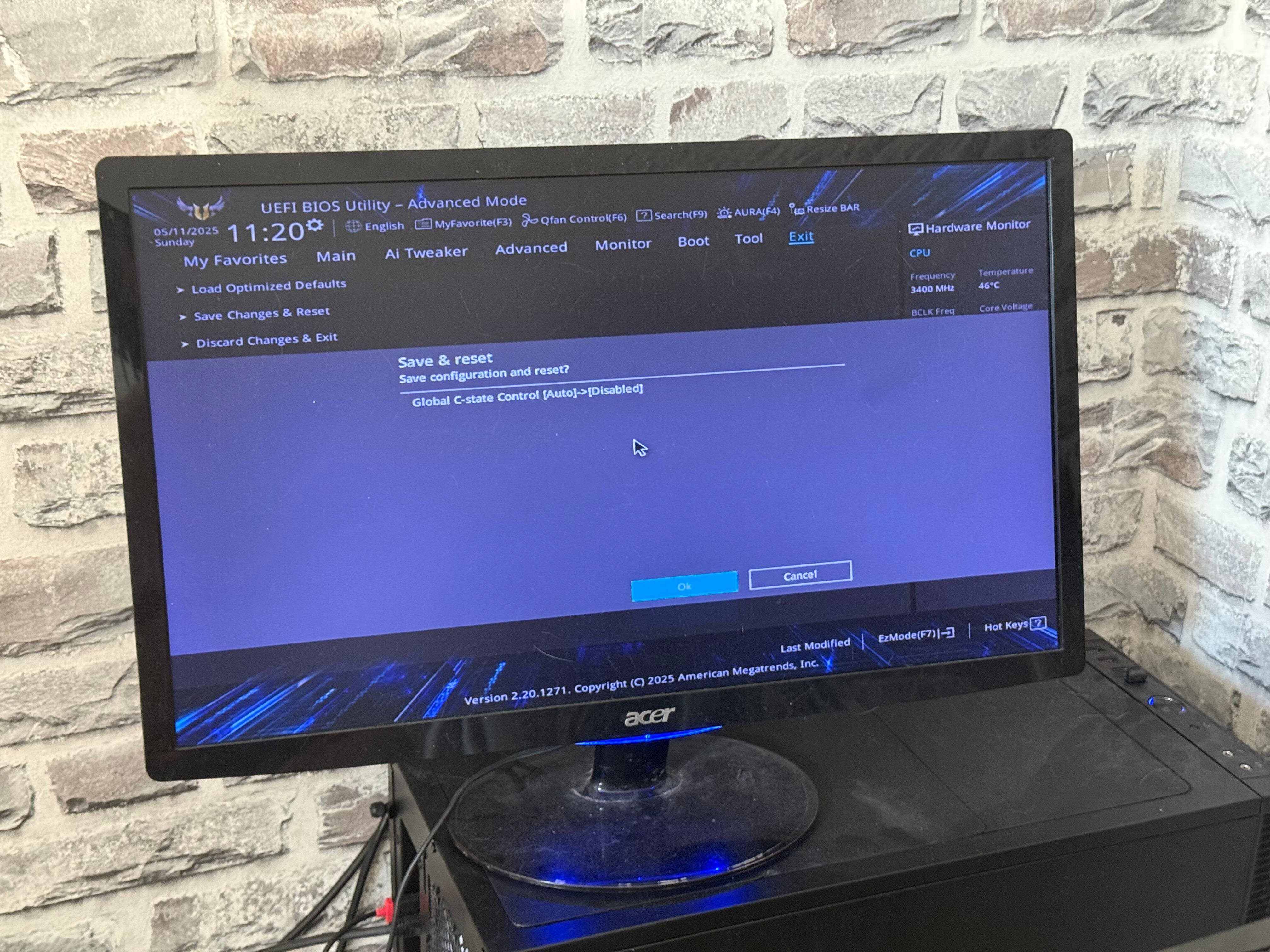

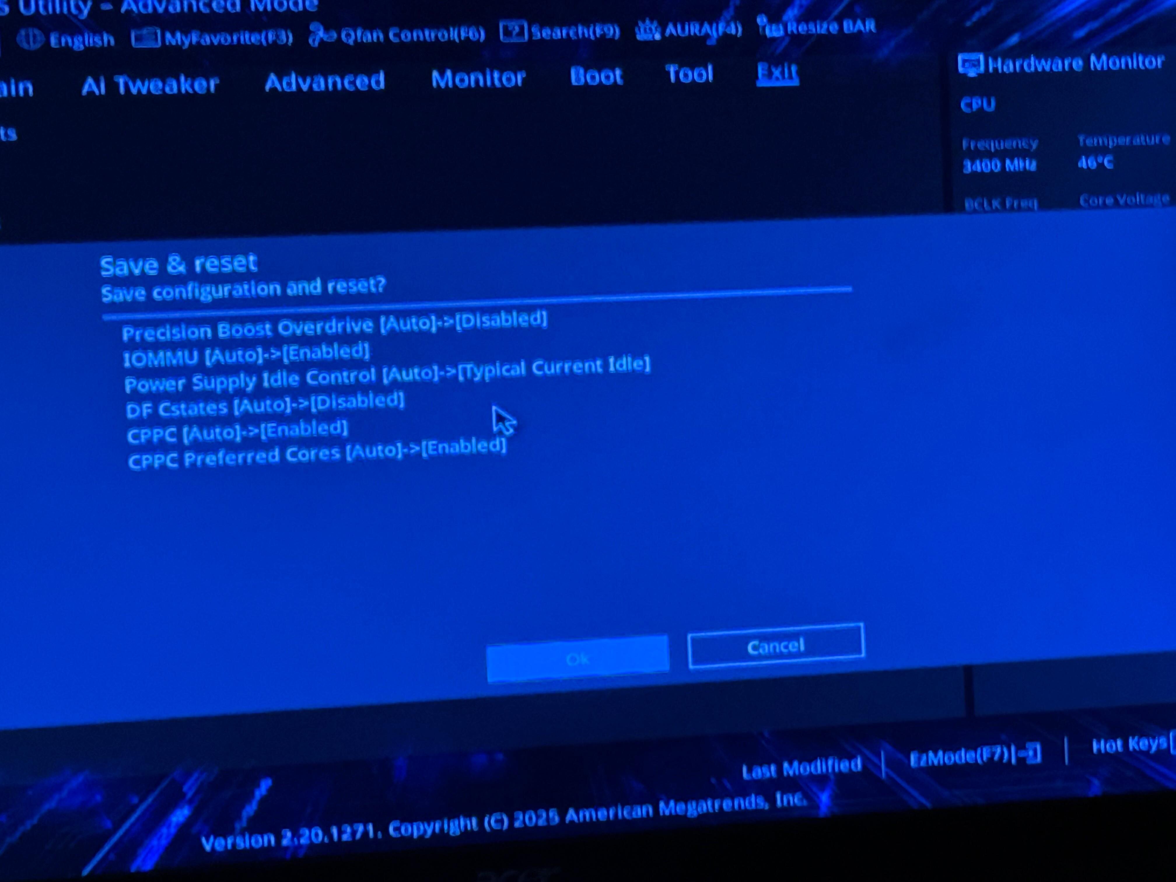

What I am currently doing: After consultation with the support & a few ideas from the WWW (see screenshots - these are the latest changes i did - the one with the many changes is done 5 minutes ago. So im not shure if its working with that)
I am attaching the the LOG. The last crash was reported by the monitoring at 23:45. (+-2 min.)

The current BIOS changes were the last effective ideas.
If that doesn't work, the last thing the support team suggests is to run a parity check on the array twice during the same uptime (1st time to make sure the parity is working and the 2nd time to rule out RAM errors).

The array crashed this morning. So it was not the last BIOS settings.

@JorgeB I've already disabled C-States to my Knowledge, i'll have a look into the Voltage tweak.
26 minutes ago, technikfrek said:
Besides that im not shure how to change the power on my CPU, could you elaborate?
There's a link in that FAQ entry about that
