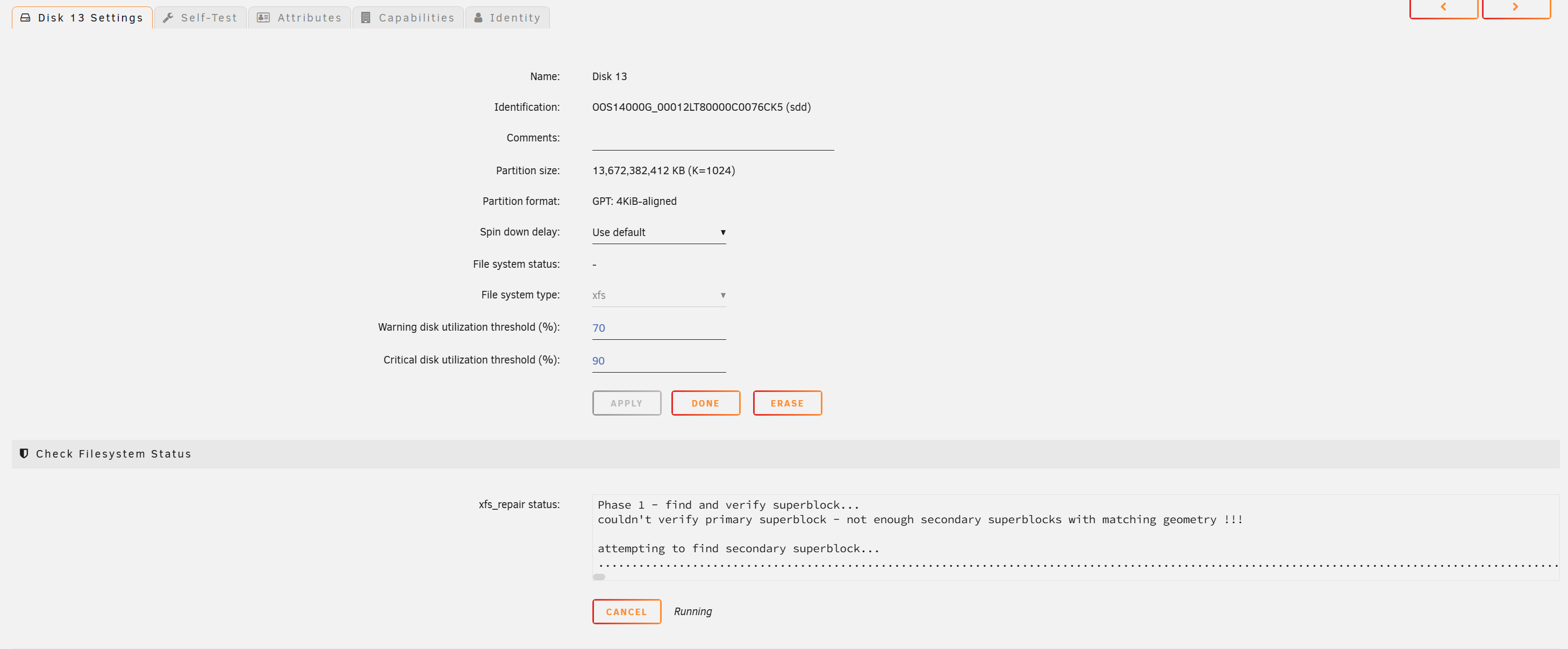

Alright, I refreshed the page after waiting a while and this is what's displayed:
This is checking the file system on the emulated disk and not the new drive I put in the failed disks place correct?

Sadly this is still running on the disk, should I cancel the process?  It's been roughly 11 hours without any apparent progress.
If it hasn't found a backup superblock by now, it won't, upgrade to 7.1.2, and try again, since it has newer xfs progs, if the same, the best bet is to restore from the old disk, or a backup, or use a file recovery app like UFS explorer.

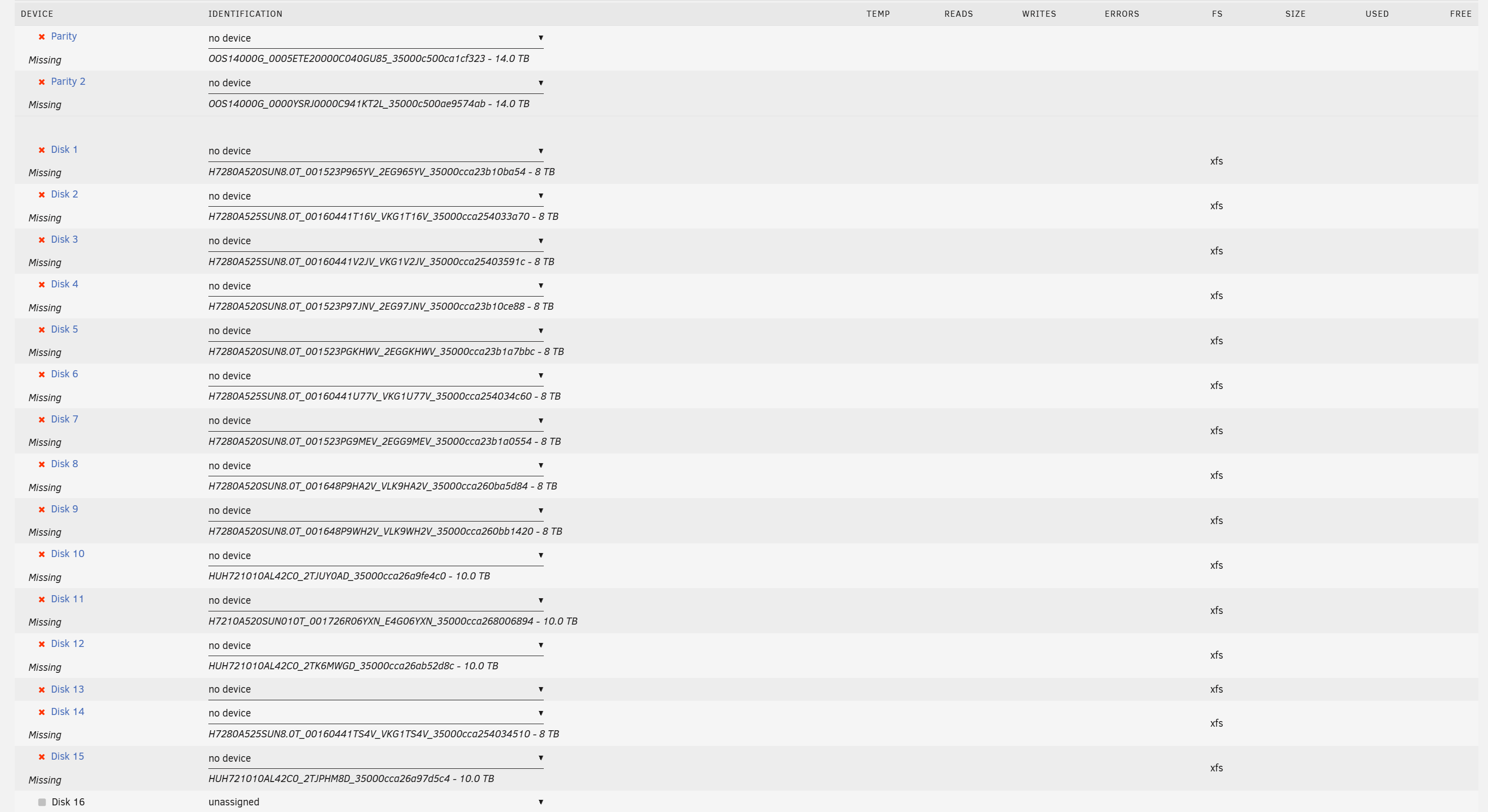

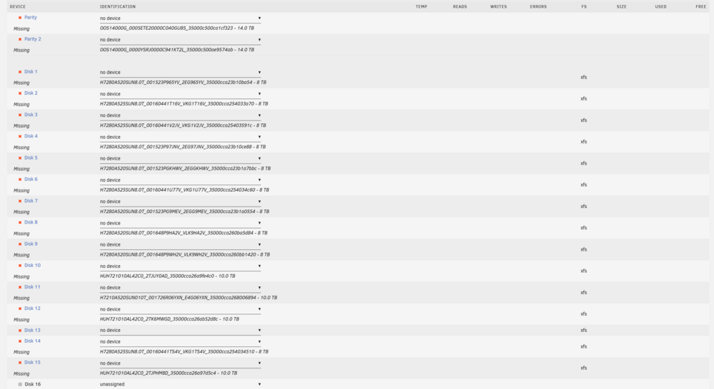

Server booted seemingly normally, found the disks and then it started freaking out over a drive that failed previously, but was only in unassigned devices.  Now, it seems every drive has been dropped out of the array and there are issues with my HBA card?  :'(
Edit: no drives are detected and LED lights on the card are off...
tower-syslog-20250515-1659.zip
Edited by chris206

I may have screwed myself further.  Rebooted and it's taking a while to come back...
Edit: the LEDs on the card are back and are active, but no idea how to read them...
Update: server came back up, recognized the drives and it's attempting to read that disk again.  I have a feeling I need to shutdown and remove it entirely before moving forward.
Update 2: It went through the same pattern, so I've shutdown and plan to remove the offending disk and will try to work from there.  I should've removed it over a month ago in hindsight...
