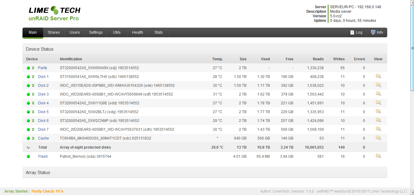

Array is now starting during boot.  Seems to be working great, flying through parity test at ~95MB/Sec.  Will post syslog when it's done (<6hrs for 13TB of parity protected data).
Unrelated, and I'm sure this is a fix required by whoever developed the custom UI you are using (which looks fantastic btw) but shouldn't that say "Array of seven protected data disks" ?
a) There are technically seven data drives which are protected
b) Parity drive is not included in the total size (nor should it be)
c) Cache & Flash are also not protected disks
Alternatively it could be reworded to something like "Array of eight protected disks (including parity)"  or "Array of eight (including parity) protected disks" 8)
