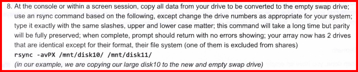

Back in the olden days when it first announced that the Reiserfs was going to be removed from the Linux Kernel there was a set of instructions for converting to XFS (the only choice at the time).  I am attaching a screen capture of the rsync instructions to copy the contents of one disk onto another disk.
A link to these instructions is found here:
     https://forums.unraid.net/topic/35815-re-format-xfs-on-replacement-drive-convert-from-rfs-to-xfs-discussion-only/page/40/#comment-1454446
