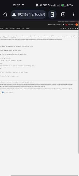

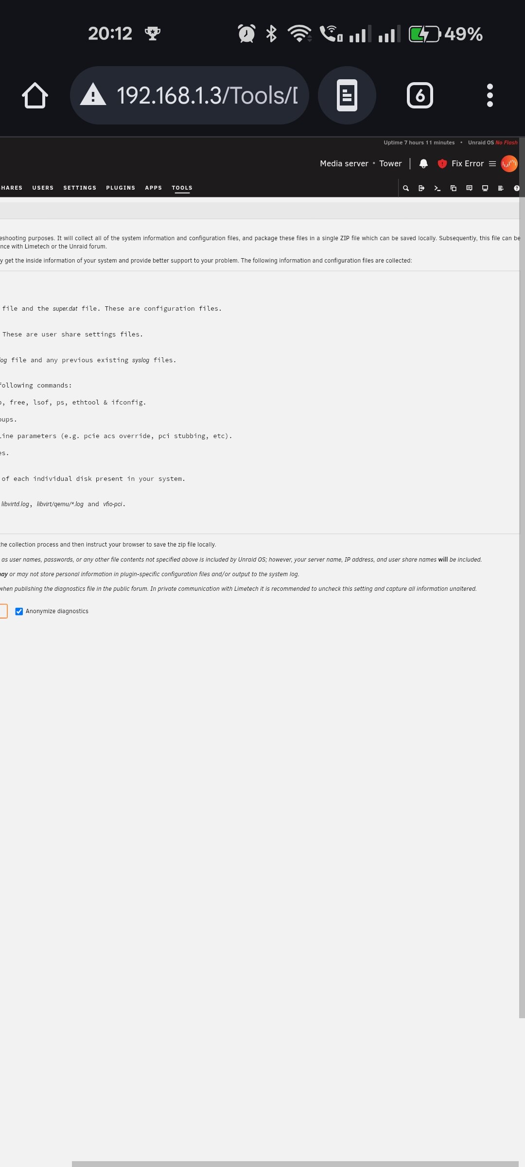

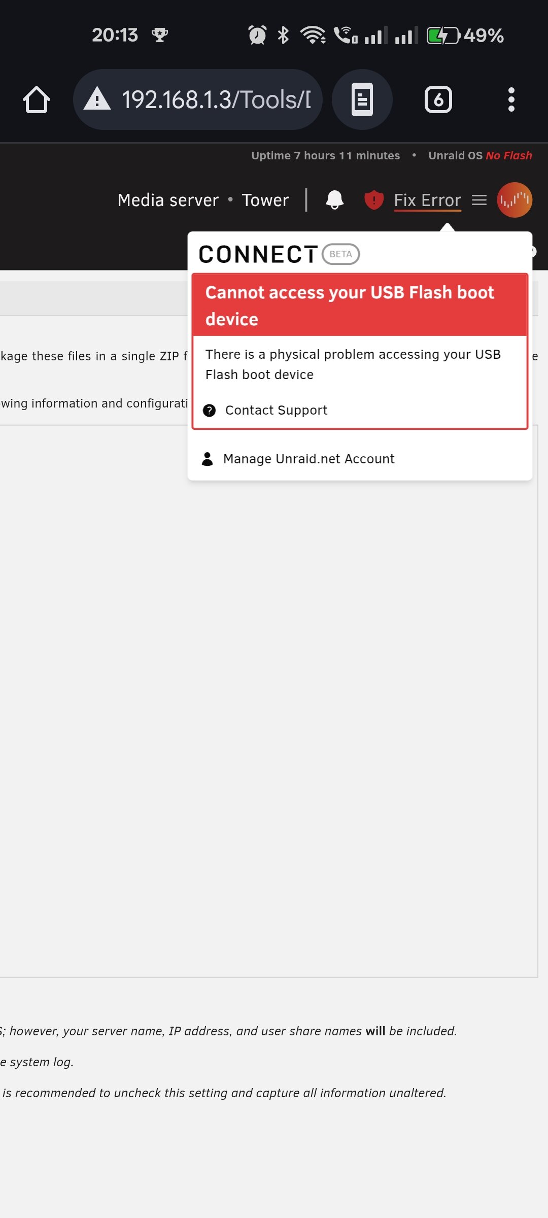

Spoke too soon. Was on the interface main page tried to get to dashboard took ages then loaded with a error about the usb and to get the diagnostic tried that but then web GUI stoped working so it wouldn't download it.
Managed to grab these screenshots of the interface on my phone before it refreshed.

i did but that was all i could find log related nothing on the share that was selected that was on the usb drive. just checked now and logging is disabled again urgh, it has fallen over again complain usb is missing, tried to download the diagnostics while gui is still up but its not downloading nothing happens. im guessing the web gui is only still up as discord group recommended putting the remount flash plugin on.

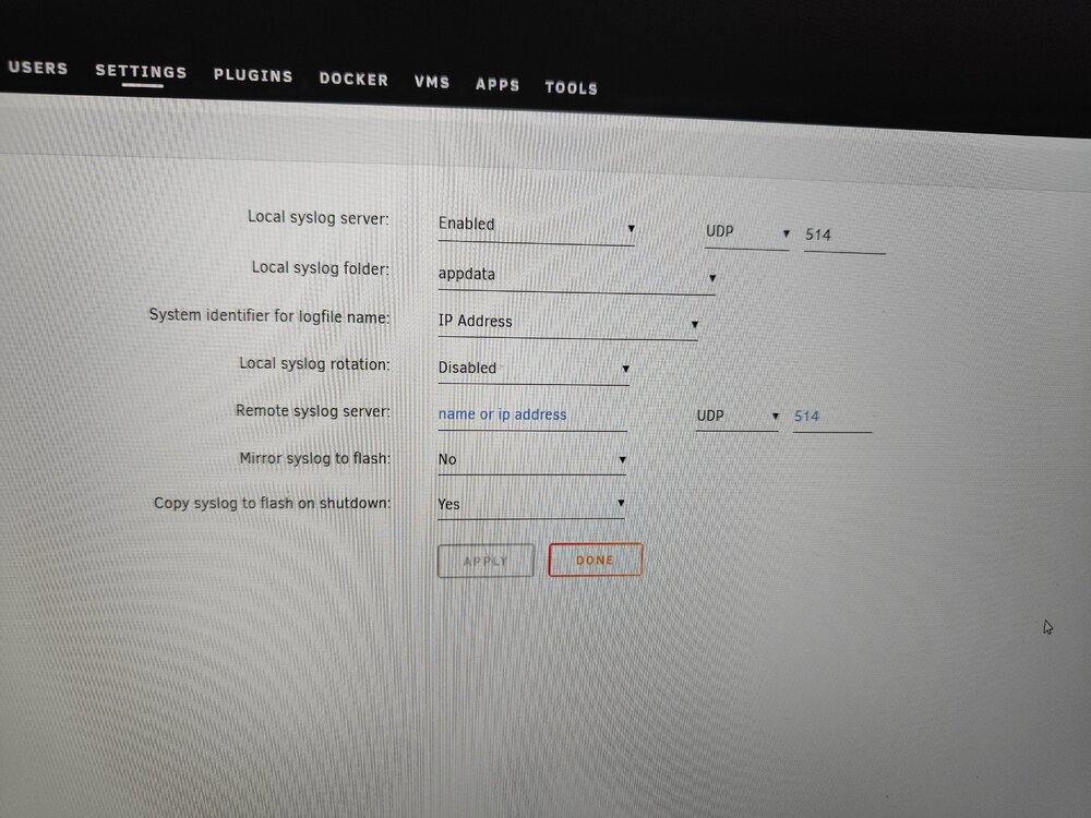

it wont let me make changes and save in the current situation. just to test its not the motherboard usb i've just made a trial usb i'm going to leave it running with to see if it falls over or not. ill then put the original back in and boot back up and try enable syslogging before it dies again.

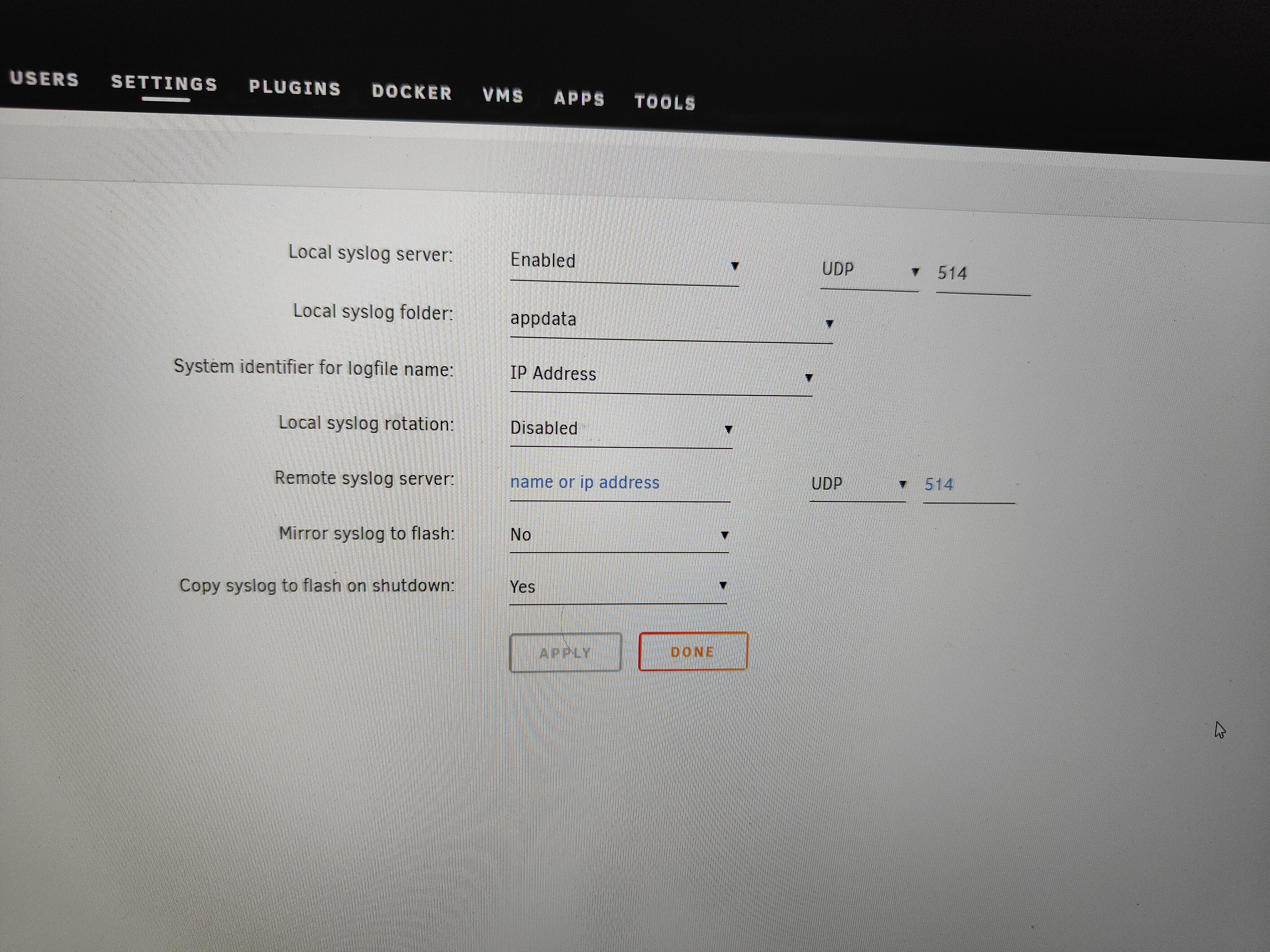

Test usb has been running most of day fine so scandisk the original usb on a Windows laptop and put it back in server and started up attached how syslog is set up currently.

At the moment you only have the Syslog listening for messages.   To get the server to log to itself you need to put your server's IP address into the Remote syslog server field.

Yea someone on discord pointed out my flaw. But I think the drive is failing/failed as ran a test usb on for several hours no falling over. Have now moved my backup onto a new usb when I last tried to plug my original into a laptop it came up with a different name not unraid and wouldn't open any longer.  So far it's been running all day and last night on the new usb so fingers crossed it's all ok.
