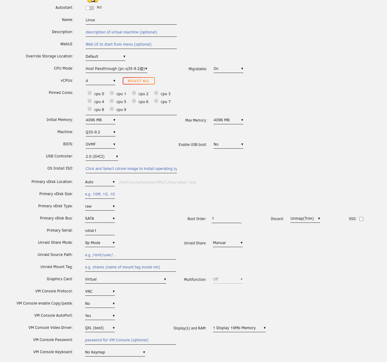

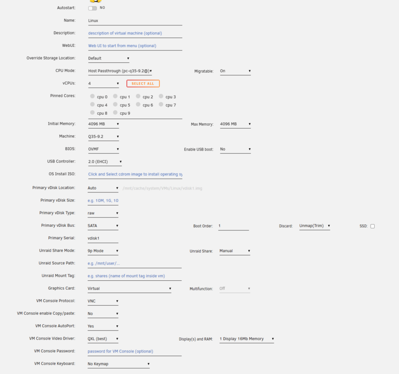

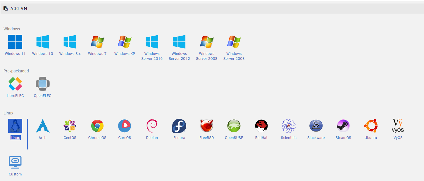

at the vm screen, I normaly use the defeat Linux options...
making some chagnes in teh add configuration...
deselct all setting 4 vcpu
set inital memory to 4 GB (not this matches and sets max memory...
change the vdisk bus to sata...
and add my iso and install...
up at the top right with edit vm you can go to xml view..
