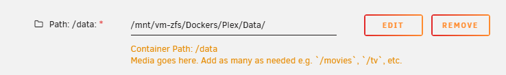

so plex data foldder will be the media / data folder...

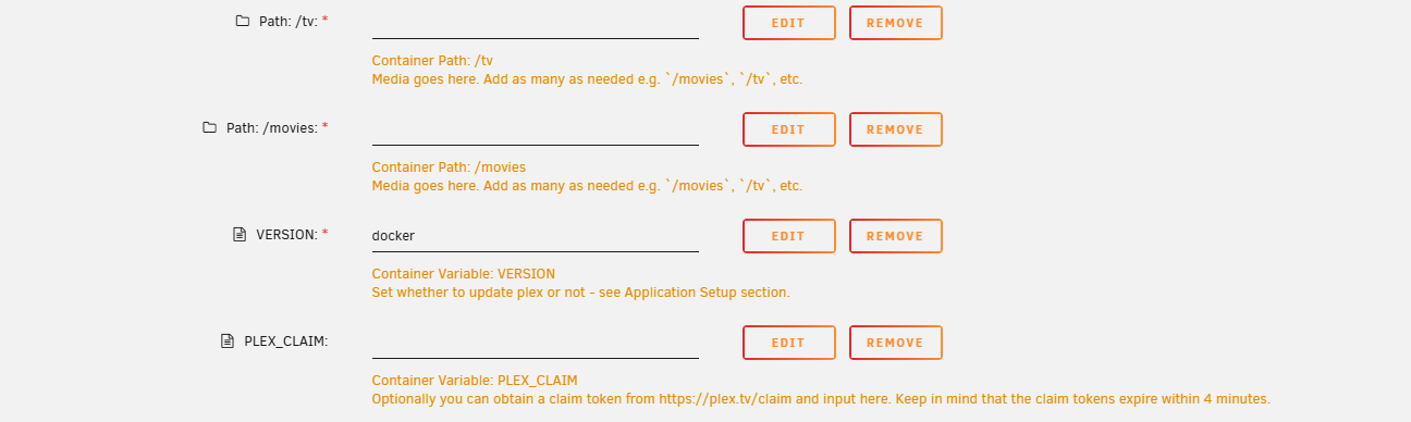

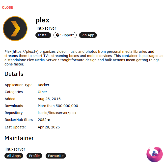

I recommend using the linux server plex CA template

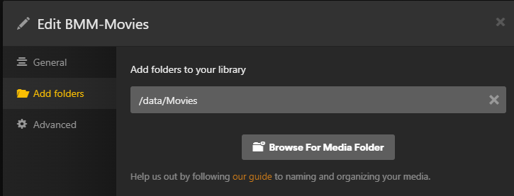

filling in the folder structure where you movies, tv shows are located at..
as you can edit this to be any continer folder pat such as /data and map it to teh unraid conting folder.
then in plex libaries you add the continer pat folder that has the content...
this will keep your meai content that you have on unraid and reload any and all video metadata downloaded from plex movie database.

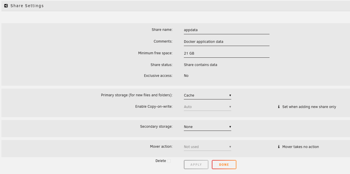

you may need to double check unraid shares for appdata and make sure only a primary storage location is set.
