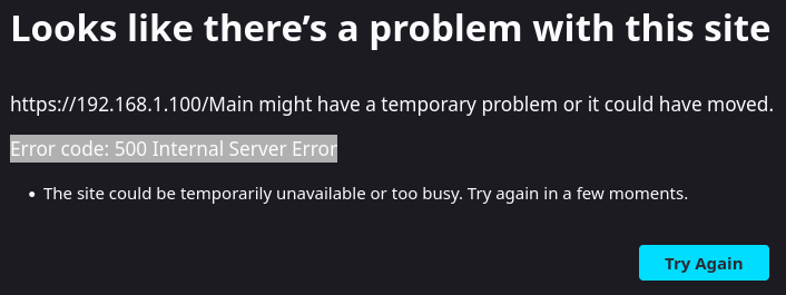

Error code: 500 Internal Server Error
Hi
What is this and how can I fix this?
I was moving files from one share to another (via Unraid WebGUI) and suddenly my browser is showing me the above. I can not connect to Unraid GUI anymore. Dockers, and VMs are running fine though and I still have access to Unraid via SSH.
Thank you very much.
Restarting nginx service via CLI does not fix the issue. After the login page (which Brave suddenly insists is not available via https but only via http) I'm right back at the above error message.

Reboot should fix it, is this a regular issue or a one time thing?
Yes, reboot did fix it. So far I had this particular issue only once.
I wouldn't worry for now, if it happens again, post new diags.
