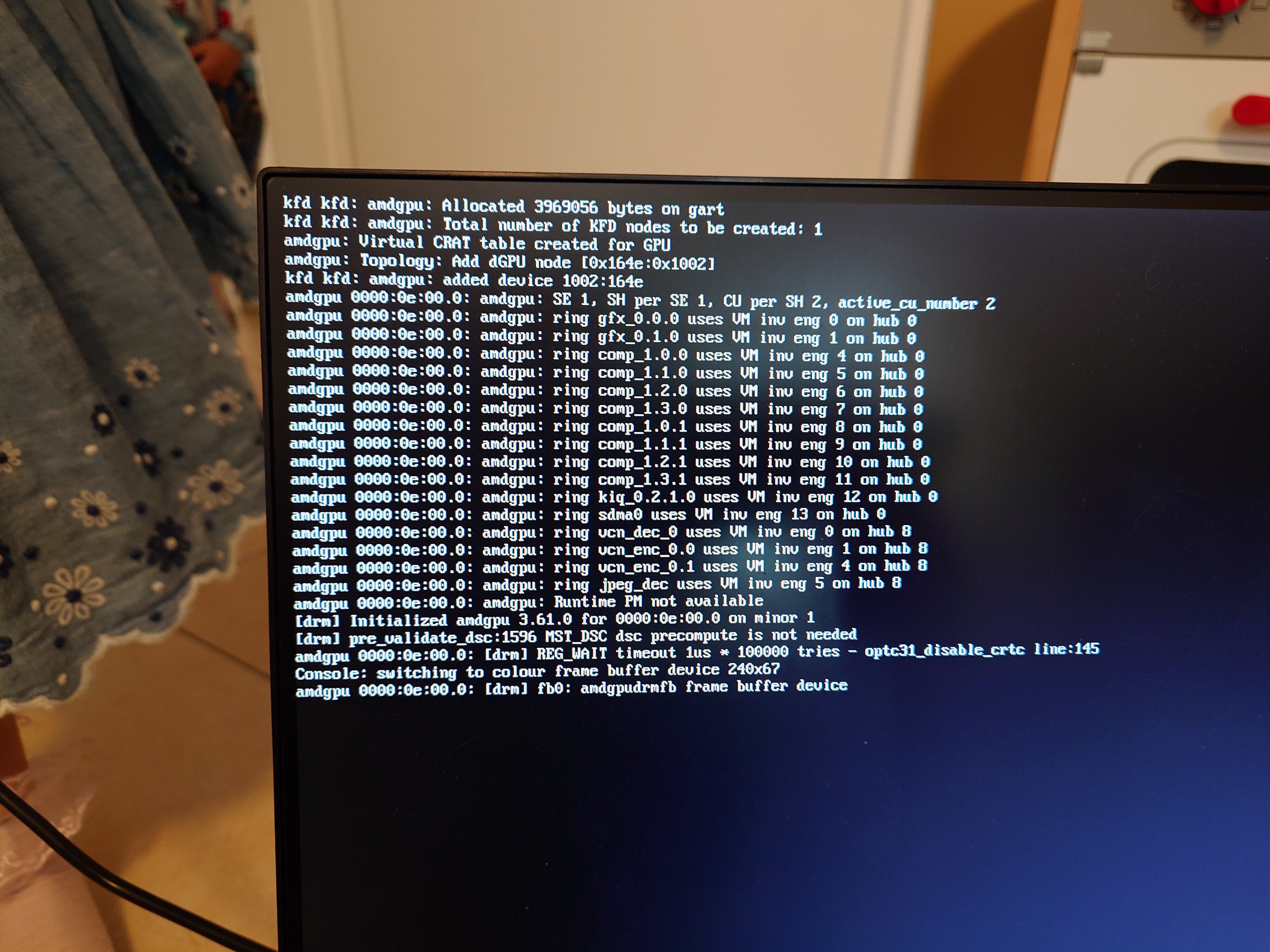

Hello,
I am trying to set up my homeserver and keep getting stuck with this screen. I have tried two different USB sticks and also different USB connectors. I have a B650D40 motherboard with a Ryzen 9 7900. It gets stuck with the attached screen. 20250518_175209.thumb.JPG.56c33fd12db01018a55aa992203128bf.JPG
Hello Jorge, the issue also happens with non-GUI booting. I also tried other systems (truenas, Ubuntu server) and none of them work.
1 hour ago, JorgeB said:
Okay, I did blacklist amdgpu driver and radeon (created that file mentioned in the documentation) still the same result. I tried doing memtest from the unraid boot - this does not start. I also disconnected my SSDs and HBA. Just the nvmes remained. Memtest does not start and also the same error when i try to start unraid.
Edited by Liefab
That suggests a hardware issue.
I was hoping not... Which component do you suspect? MoBo or CPU? Anything else?
It could be any of them, if you have multiple sticks try using the server with just one, if the same try with a different one, that will basically rule out bad RAM.
I will try different memory sticks. I would hate it to be the mobo or CPU. All are new.
Okay, i solved the problem. Without a screen connected (or only through the VGA port instead of display port/HDMI) the system boots normally and is accessible through the lan.
