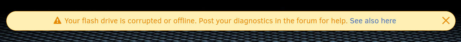

Warning : Your flash drive is corrupted or offline.
Hi All,
I just replaced my flash drive 6 days ago (with a minor hiccup) and it's been running fine since then. However I just got this message and it seems like the USB drive I replaced it with is failing. Granted it wasn't a new stick but didn't expect it to die in less than 6 days.
As advised I've attached my diagnostics. I also attempted to take a flash backup which I think mostly worked. Looking into the backup all of the config/*.cfg files are intact except for the disk.cfg file which I thankfully still have a copy of from when I took a backup last week (attached) when I replaced the USB Drive.
What are my options here?
I'll go buy a fresh new USB stick tomorrow morning but I'm not sure about using this current flash backup and it might be better off rebuilding from the backup I took last week.
To make matters worse I do currently have a drive disabled which I was planning on rebuilding from parity once I put better SAS-> SATA cables in place
  • disabled disk - Disk 7    ST8000VN004-3CP101_WWZ6WWKG - 8 TB (sde)
The disk got disabled during a parity check after the flash swap 6 days ago. It was likely due to poor cooling or cheap SAS/SATA cables both of which I've recitifed in the last 2 days. I just haven't gotten around to rebuilding disk 7 from parity.
However I'm very hesitant to reboot with this current USB Flash warning and a potentially bad backup.
Yikes!!!

Flash drive issue, you can try backup and reformat first if it keeps happening replace it.
As noted in the second post the backup of it's current state fails. I'll try to restore from the automatic backup taken last thurs.
Am I going to run into issues transferring the licence to a new USB since I only did this last week?
Isn't there a limit of one transfer per year using the automated system?
Note that you can also retrieve your drive assignments from a syslog that dates from the time they were valid.
You will need to contact support to once you have the replacement flash drive (so you can get its GUID) so they can do a manual transfer.
Thankfully I've got a screenshot of the current config if it comes to that.
My only concern was if one of the disks is currently disabled how I would tell UnRAID to rebuild that from parity. Probably getting ahead of myself as the backup last thurs might be good enough as the disk was in a disabled state then.
Cool thanks I suspected that might be the case. Hopefully the server can limp along without a reboot until I get everything ready.
Edited by phoenixdiigital
