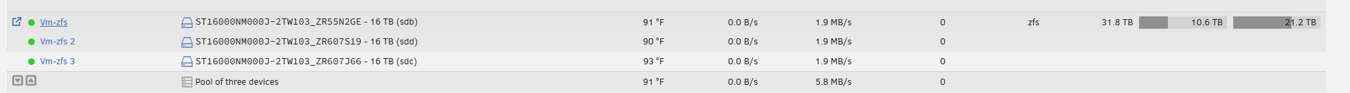

make a zfs pool with that grouping of disks.
Then under pool devices. you will add a 4 slot disk
I don't know call it data. Come up with a name... as this will become the array moving forward...
Click data(the pool name you chose) and select filesystem type zfs and chose raidz1 (or raidz2 you can lose 2 disks and keep all the data similar to your current setup)
Doing this will set your disk up as a true nas raid array for redundancy in disk.

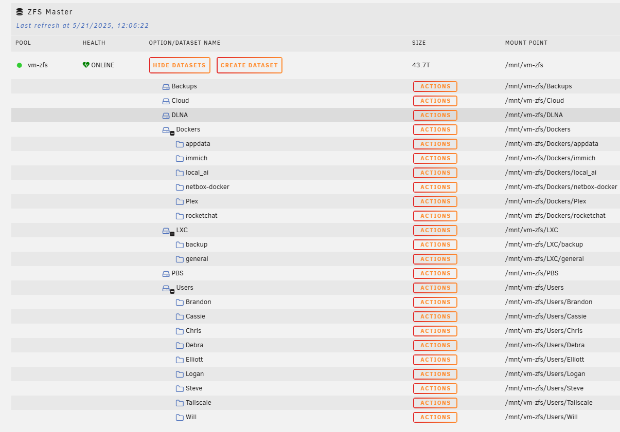

we can then make "datasets" which become shares and use datasets for the start of your file hierarchy
review for examples as this need to be though out and setup before data is compiled making location where xyz will be stored...
https://trash-guides.info/File-and-Folder-Structure/
With each dataset, we can leverage zfs for snapshots of the data for backup purposes..

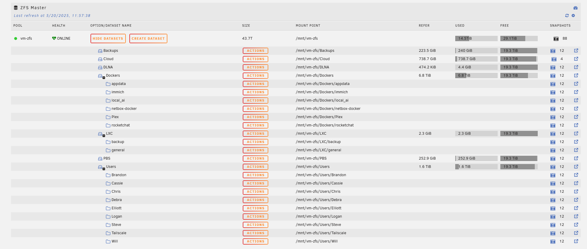

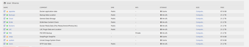

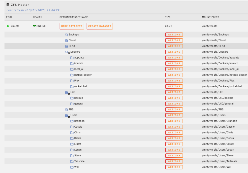

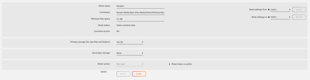

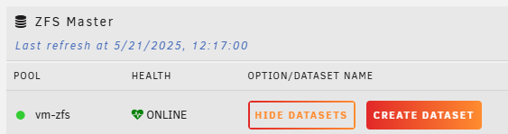

Example OF my main screen and some datasets...

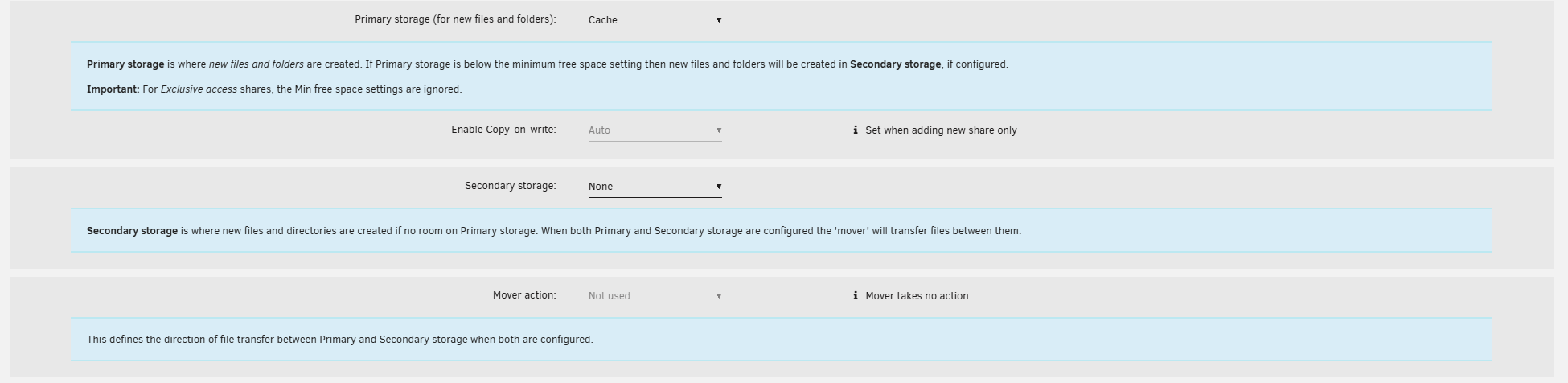

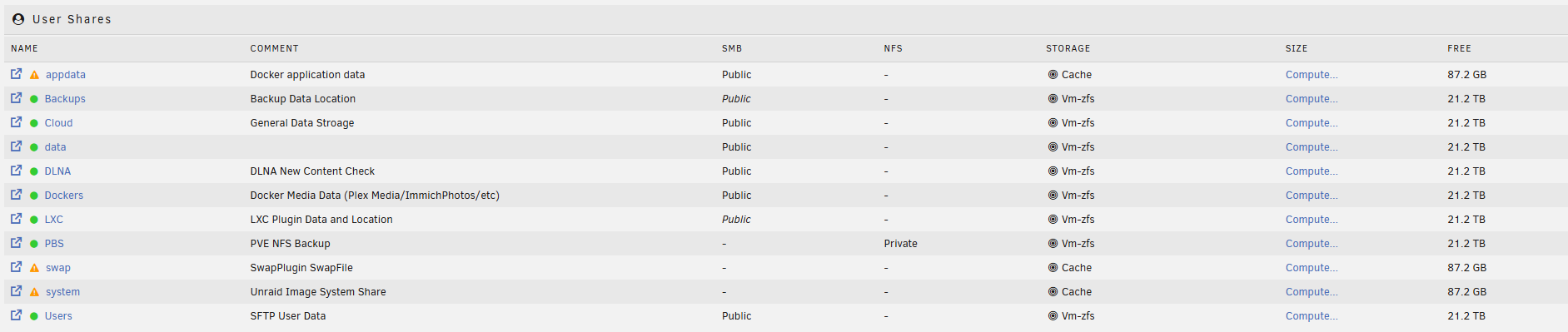

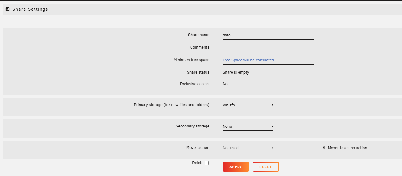

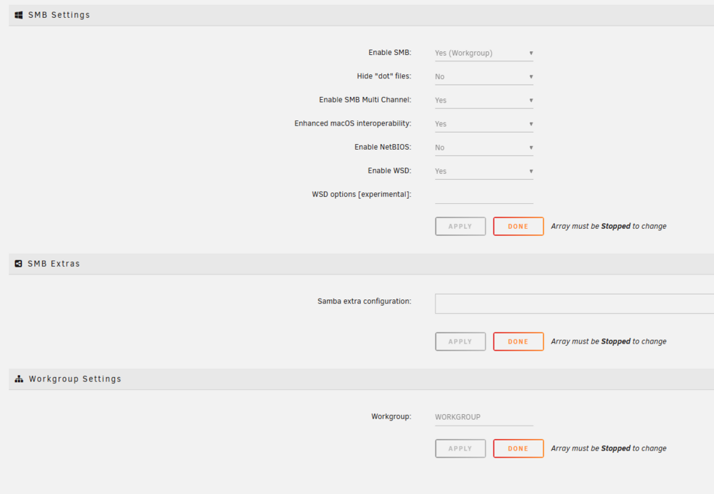

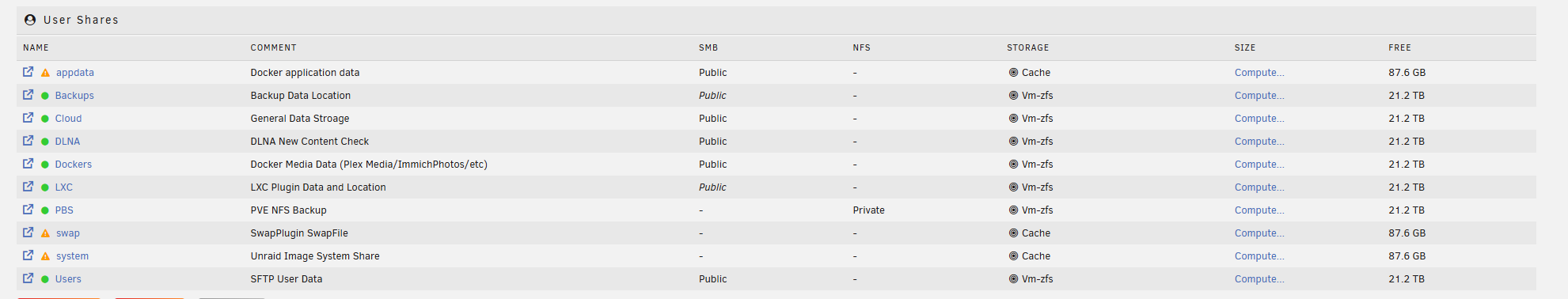

Then we can go over editing the shares tab and fixing the sahres to make sure primary is set to the corect disk example of my dataset file hiracry
then at each share and other unraid setting, we can leverage nfs/samba to share that off the machine...

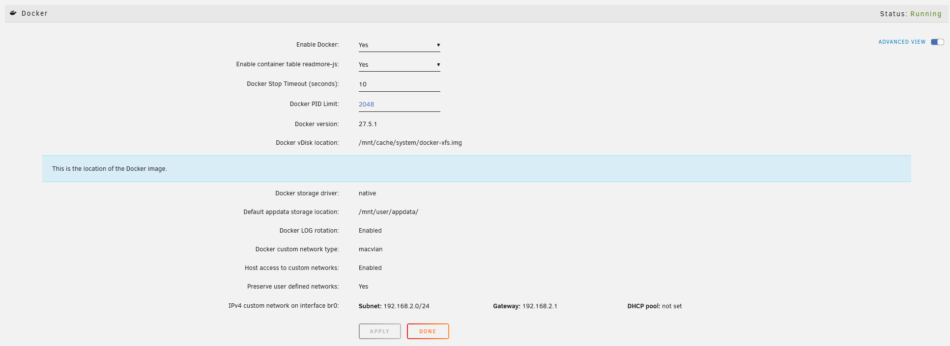

I would advise setting the docker and vm system image on cache and potential install the swap plugin and making a 2 GB swap volume for a just in case Out of Memory...
then we can go over some side improvement script such as automatic backups, tweaks and user script settings to run automatic snapshots...

in zfs all datasets would exist at /mnt/pollname/datasename
so I have a pool called vm-zfs and a dataset called docker
Unriad system host is called Docker...
root@Docker:~# cd /mnt
root@Docker:/mnt# ls
addons/ cache/ disks/ remotes/ rootshare/ user/ vm-zfs/
root@Docker:/mnt#
using unraids fuse system after making the file hierarchy uses the datasets and setting up the shares of where data exist...
root@Docker:/mnt# cd vm-zfs/Dockers/
root@Docker:/mnt/vm-zfs/Dockers# ls
Plex/ appdata/ immich/ local_ai/ netbox-docker/ rocketchat/
root@Docker:/mnt/vm-zfs/Dockers# cd /mnt/user/Dockers/
root@Docker:/mnt/user/Dockers# ls
the unraid fuse system for default pathing will be hard/sym link to the array for data...
then its a mater of updating docker setting and vm setting where on disk or fuse system is the data to be used...
as example plex temple pathing:

Alright so i started over and didn't go with array and did a zfs pool as you suggested (set it up as raidz2 for more redundancy), have my cache pool, no shares/data sets, installed all the plugins you suggested in your first post linked thread. As for backups/snapshots and the like ill worry about that after the fact cause right now i don't have any data to snapshot/backup and i have an external machine i will back up everything to once i get my unraid setup and going. My question is: where do i go from here?
1. How do i move my data from my gaming pc to unraid? do i just make a share (or dataset?) and map it to my gaming pc and move it over?
2. make sure i have my docker containers point to that data
3. do i still need mover?
4. will i just use my cache pool for docker configs and the zfs pool for the actual data?
i appreciate your help so far! Let me know if you need anything to help you help me.
Perfect now that your on zfs we need to come up with a file hireachy. yes using the zfs mater plugin you can make a single dataset called samba and use unraid to share the one folder. per example

1. First we need soem datasets and come up witha file hiarchy.
We will want to enable some protcall samba, nfs, sftp via ssh etc..
genearl saved data, docker data, backup stagin data, and even sub fodlers...
As shared earlier, as I can name them in the share tab:
I have a Backup Dataset where I can place files for stagin off the machine... such as the appdata backup plugin to flash backup adn backup dockers...
I have a cloud dataset, this is my general samba share that all pc conect to dump files.
I have a Docker dataset this is where docker media data is set for my use such as large video file for jellyfin/embry/plex or storage for docker appication like pictures from immich...
I have a dataset for the LXC Plugin for VMs
I have a specail dataset PBS use to connect proxmox and use it as a nfs backup sertver for VMs
I have a SFTP dataset I use with a specal Docker I run sftp-fail2ban that the ring network I have between friends as we rsyn via sftp and use each other as remote backup...
Each dataset then becomes a share and edits are done to make them avalbe to share to antoher machine.
Your needs may be different.

Unraid Doen't support subfolder sharing. you can use zfs terminal comnad and make a subdataset with n a folder.
as icon shown above example my Users datraset. I could have made the names a dataset there icon is folders. as I have zfs directory listing enabled to see data disk status.
I Don't know your needs. I don't know how you want to struture your data. how you want to interact with it and what you want it to do.

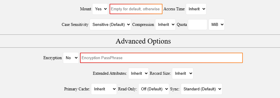

As we first need dataset then we can go to the share tab and setup samba/nfs access.
just fill the top partion
leave everything else default
empty
then hit create
This will make a dataset used later for snapshots
this will make a share that needs edited latter.
Make your Necessary Dataset as this is the pre file structure. as later we can make sub folder as example my sftp docker uses dataset user but acautl uses data in the usernames folder...

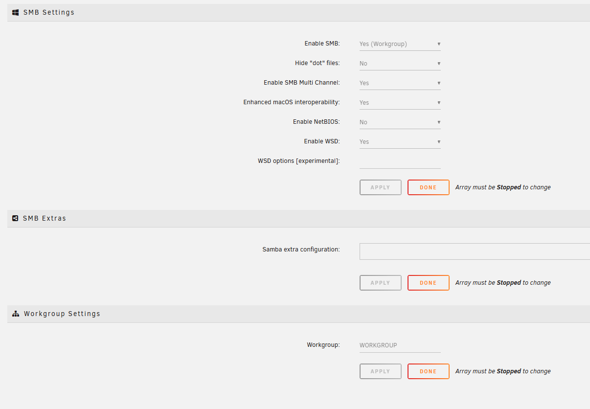

Next we need to go to setting and fix some things...

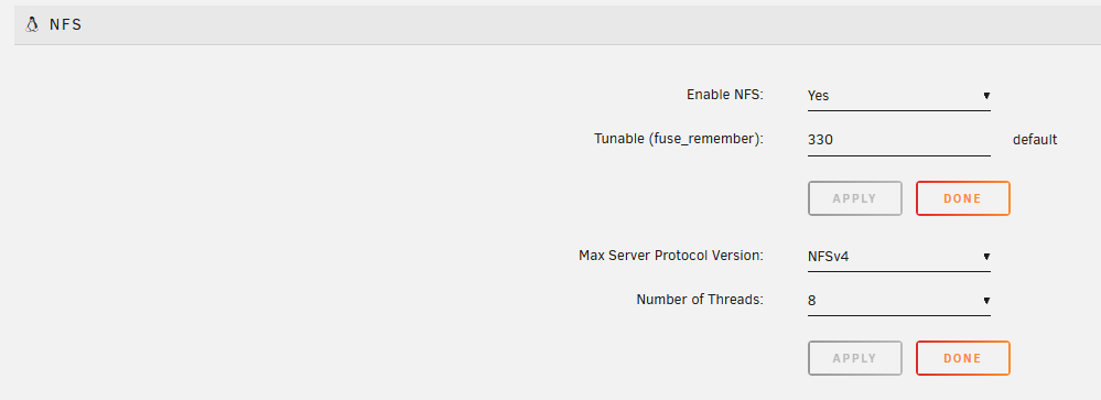

Under network services click smb and nfs
NFS is the share protcal to share data via Network File System.
Here we want you to mimic the same settings...
At the very least turn it on.
Next Settings SMB:
This is Samba server the default windows sharing protcal
Note the warning the array needs stopped before you can edit these settings..
Notes:
In your case you may not want the apple addtions with so macOS interoperability should be no (adds adational appl settign to smb share latter) non configruatble in unraid web UI
If your unraid only has 1 nic turn off SMB Multi Channel
Its fine if you don't some just some side performance tuning...
this tells me that your basic NAS needs are now enabled and we are ready to edit sahres.

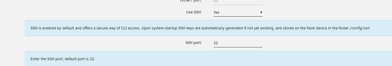

Unless your want to use file zilla and tranfer your file to unraid as it can be quite long and ftp has some nice protcal pause features...
While too ealy to use teh sftp-fail 2 ban as we are just setting up... You can use Unraid sbuilt in ssh server and conect with your root user and passowrd you use to loign to the unraid web ui...
Setting > mamagnemt access
this will allo you to conect to you unriad via filezilla at
sftp://x.x.x.x
x.x.x.x being the unraid ip and port 22
where you can go to /mnt/zfs/DATASET NAME
and start dropping files...
We need to fix share web UI tab settings frist before any file copy as this will dictate where files are stored..
So we made a data datase:

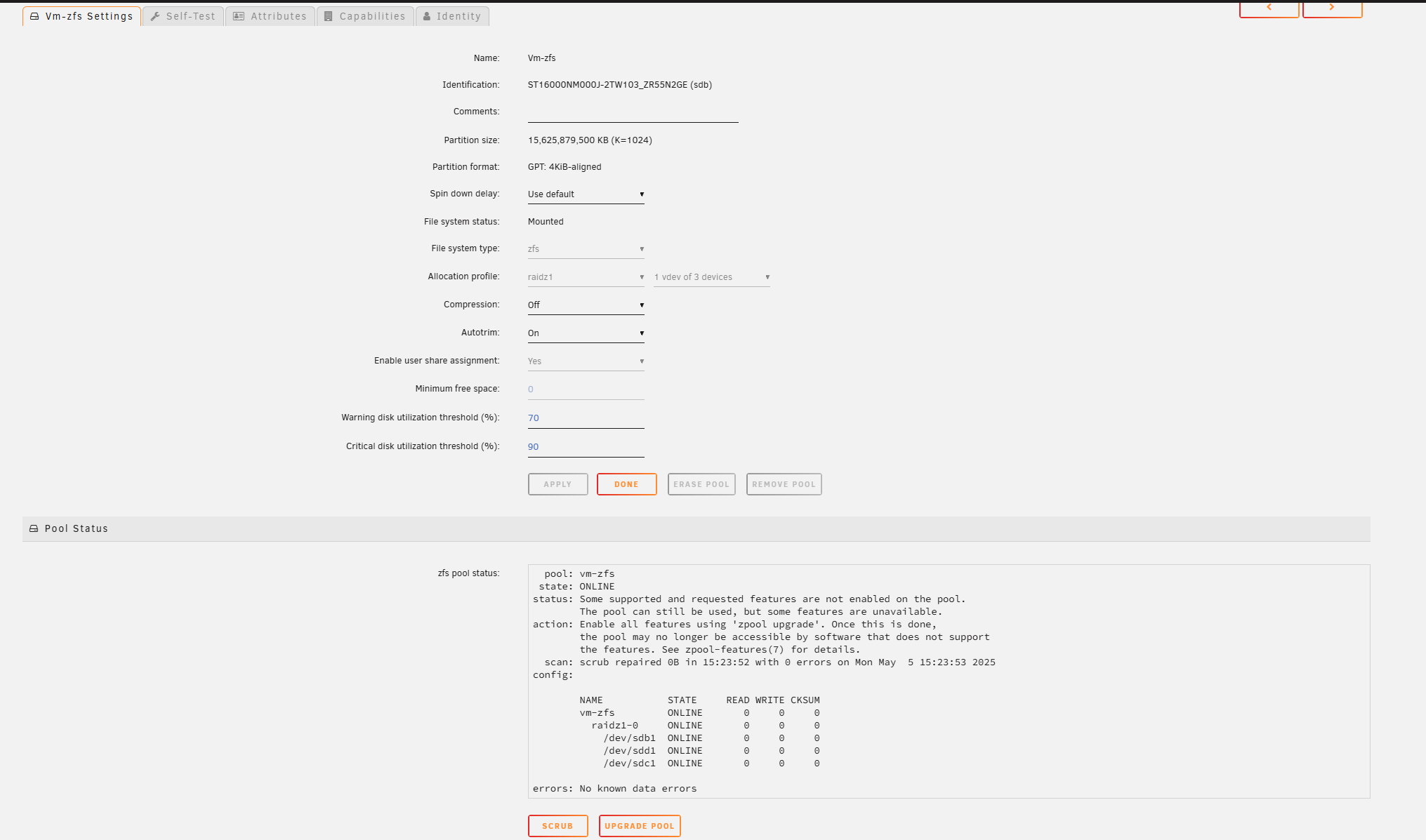

ZFS Master will show the new dataset
this will be located at
root@Docker:~# cd /mnt/vm-zfs/data/
root@Docker:/mnt/vm-zfs/data# ls
on disk /mnt pool name per picture its zfs / dataset name this is case sensative in my case its data
data will now exist in teh share tab its contens and subfodlers will not
using smb exta option we can make sub folder share there own share latter...
Now lets look at teh share tab...
Note the storage files this share option is teling new data to write to the 1TB nvme cahe pool
here we need to corect the share setting:
click data
and under primary stoarge select zfs
then hit apply under it
now when data write to /mnt/user/data it write to the corect location /mnt/zfs/data with is teh 4x 14 TB disks
otherwise the unriad fuse system will write to /mnt/cache/data which is the 1 TB nvme

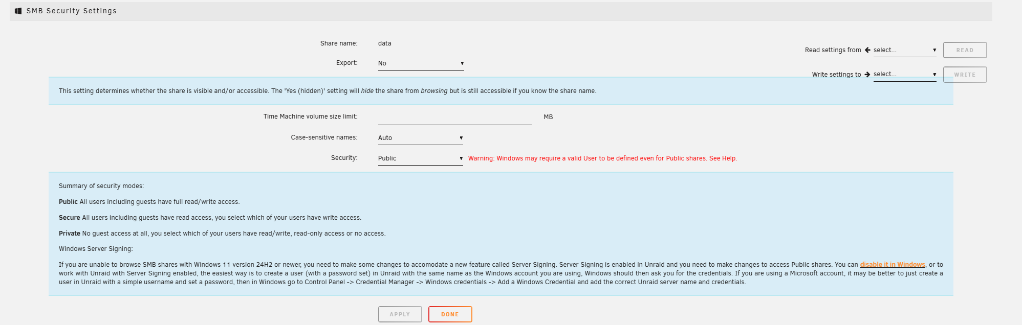

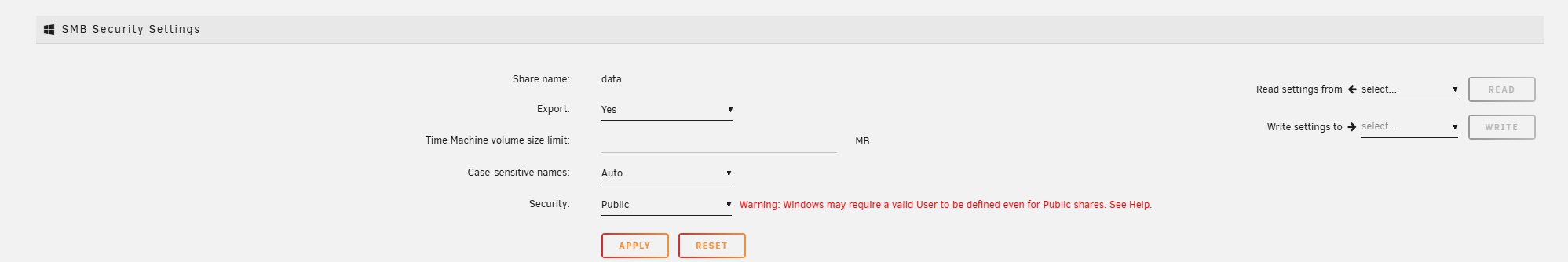

we then scroll down we see nfs setting and smb setting...
we care about 2 things 1 is this being shared off unraid and how secure is the share
to use windwos expolre to conect to data we need to export the smb setting
I want all user be abvle to access data
click apply to save that setting (If you didn't clcik apply above it will not save the settings as this page is ficle and will only save the setting of that section...
clicking the sahre tab you should now see the trabel filled out with the corect data
Repreat for each share setting and each dataset!
since you reused the cache disk (if you didn't format it)

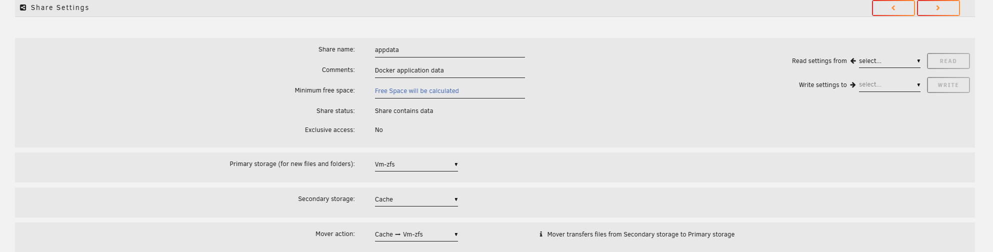

If you made a appdata dataset we can leverge unraid mover and secodary setting...
YOU MUST HAVE A DATA SET MADE FIRST! IT IS BEST PRACTICE TO MAKE IT VIA THE ZFS MASTER PLUGIN!
Here we can invkde unraid array mover task to move data off teh cache disk and into the zfs array
Note VM-ZFS in your case it will be zfs
that zfs is primary any new folder or file will be stored in that dataset.
since appdata existed previous and is on cace now when we invoke mover it will move the files off Cache and put them into the dataset.

so now that the Q/A is over lets visit the docker setting and template settings to correct setup

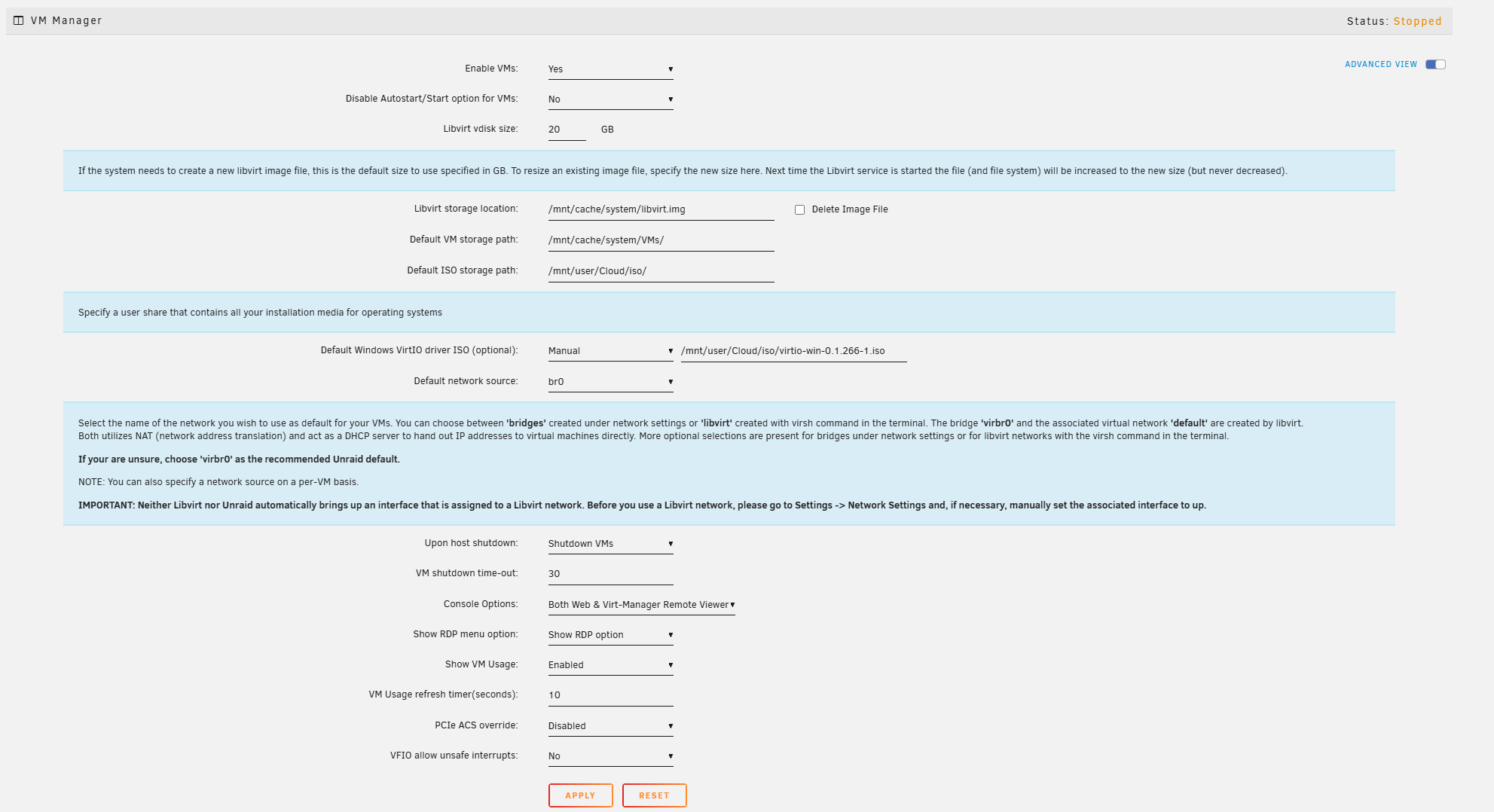

If you chose to run VMs on unraid some recommend Generic settings.
Note I'm using the direct disk path and not the fuse system /mnt/user
this is also set to use 20 GB on the 1 TB NVME for general kvm/qemu libvrit application required by unriad to run VMs
with ZFS full support on kernel 6.12 on unriad v7.1.2 following the release notes and announcements.
They recommend using the xfs vdisk image and a different overlap driver.
I Personlay Prefer macvlan due to lan identiy and mac different address set per each macvaln docker container
The big one here is the vDisk Location and the storage driver.
I highly recomend using the xfs docker img file...
see docs: https://docs.unraid.net/unraid-os/release-notes/7.0.0/#add-support-for-overlay2-storage-driver
If storing on zfs use overley2
Note I went with a direct disk path and bypassed the unriad fuse system of /mnt/user
This way I can guarantee that the storage for new file and folders doesn't breaks as long as the storage is set to a single primary disk location and we bypass the need to use mover out right.

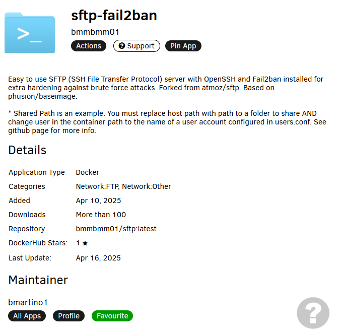

lets lookg at CA sftp-fail2ban
As I prefer transferring large files with filezilla

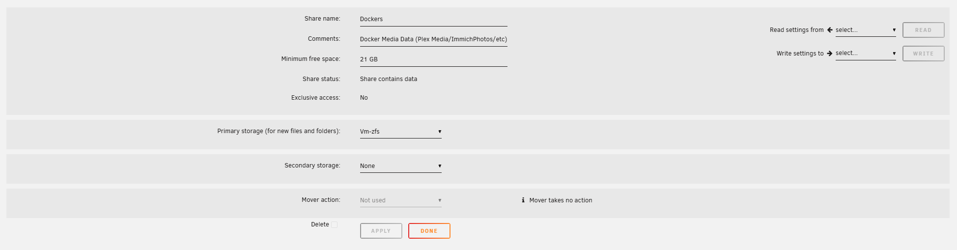

Thank you! I have thoroughly read through both of your replies and made a lot of the recommended changes. I would say the only changes i have not made (as they are currently not applicable) is setting up nfs/ssh/and sftp fail2ban. I have no current need for nfs connections, don't plan on sshing to my unraid machine, and wont be sftping. I don't think what you said is bad advice and i will definitely keep them in mind if the time comes for me to need these services. This is my new current main screen with zfs setup and using data sets. zfs main.png
Its not 1:1 how you explained i should set it up as i have my data/config files in different folders but i do have the cloud and backup datasets and think those will be useful.
And this is my shares page:
The only question i so far have i guess is why is zfs master showing 50.9tb but the zfs pool itself shows 23.2? is that intended or?
Awesome. Looks good. Glad i could help. yeas, nfs and sftp / ssh are all optional. They are things I would do and use thus mentioned.
Looks like your coming along nicely...

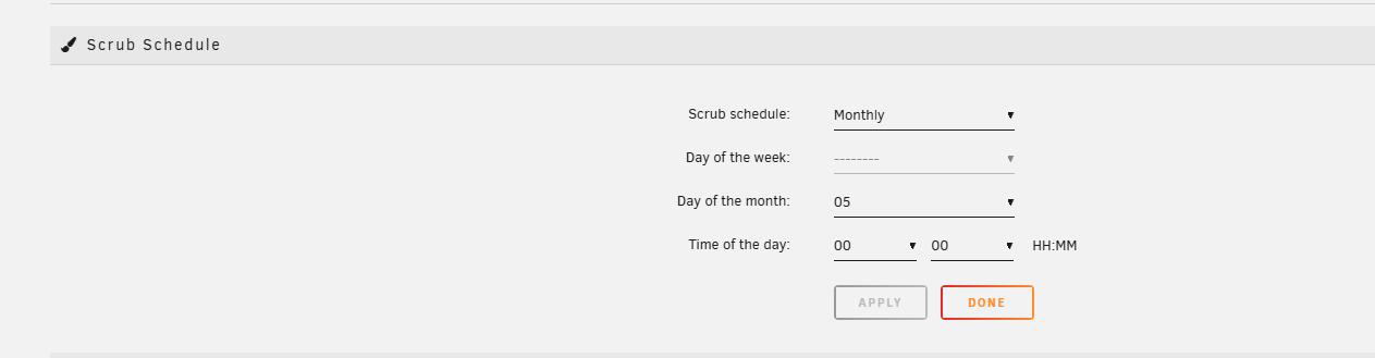

Since your using zfs you need to monthly automte and monitor from time to time a zfs scrub between disk
if you click zfs you will get additional disk option above the zfs master in the main web ui tab
you can set a scrub schedule:
this is when zfs will scrub the disk and confirm parity recommend doing one once a month.

using the snapshot plugin and or the zfs action snapshot manger you can view and restore data to a earlier snapshot.
A system is only as good on how you handle recovery form a backup.
https://www.youtube.com/watch?v=UR5RCItyCsw
I find zfs to be easier in maintaining data and drive replacement then the array.
https://www.youtube.com/watch?v=36moTWdxjnI
some other specal disk configuration. Additional storage latter adding nvme as l2arc or special vdes to zfs to improve performance
https://forums.unraid.net/topic/185453-zfs-special-logs-and-cache-drive-options/#findComment-1514833
A side mention for future...
as a x8 pcie device to add additional nve drive as l2ark or special disk...
-I still receommend keeping atleast a nvme as a btrfs caceh disk for legacy unraid setting.
Thanks a lot! I have implemented the script (actually fairly easy to do when reading the directions for user scripts) so now i have scrubbing and snapshots. Tomorrow i will watch those videos and learn more. I appreciate your help and patience.
