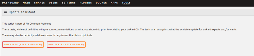

with teh FCP plugin installed I usualy run update assistnat to verify and check before hand.
then go to tools update OS.

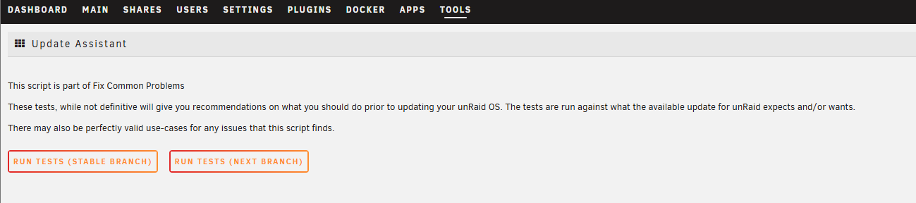

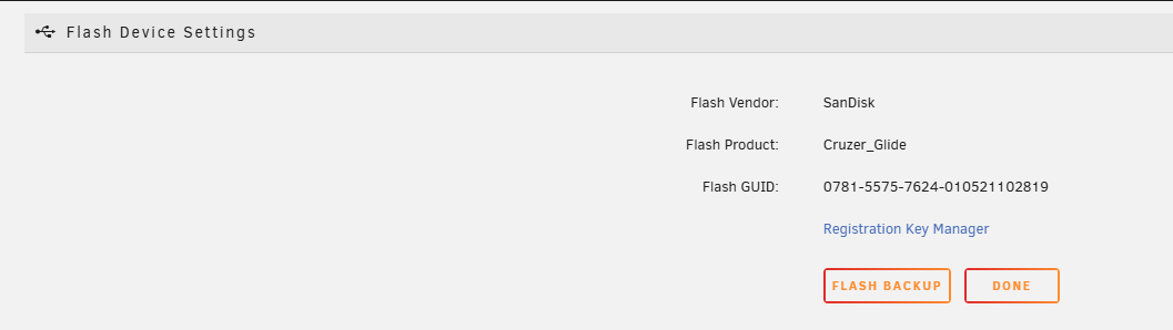

Go to main > click flash >
MAKE A BACKUP!!!

then go thought he key license change, which is easy with the flash backup as it a record and acknowledge the old flash drive guid is blacklisted for your key.
contact support for license issues
