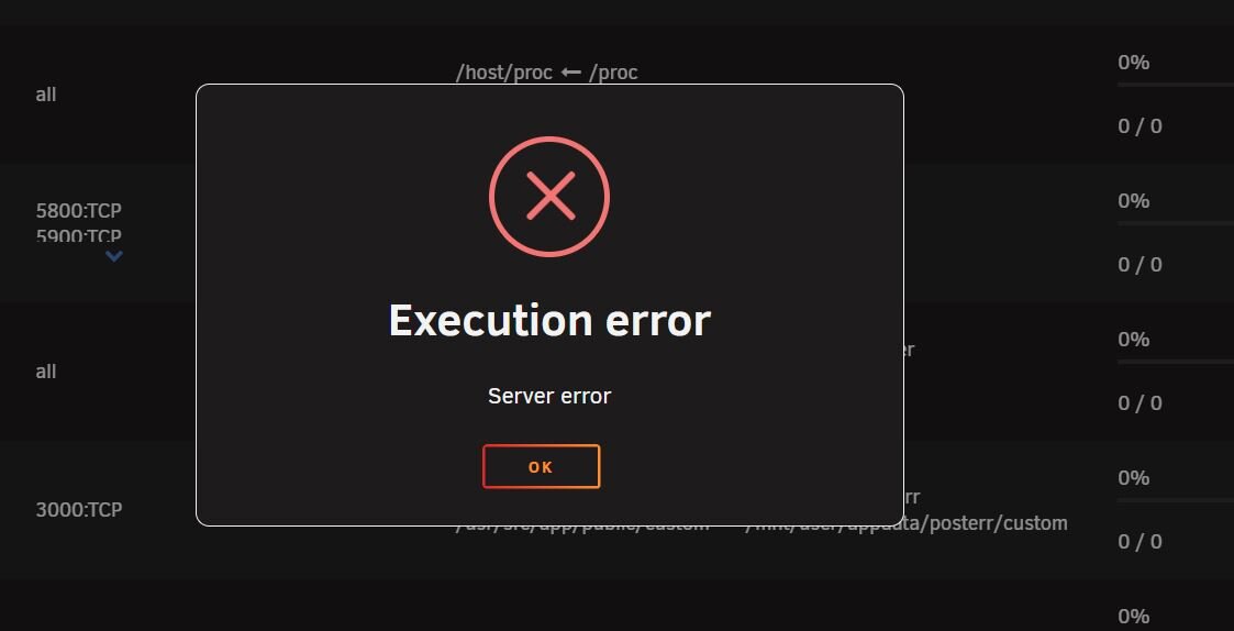

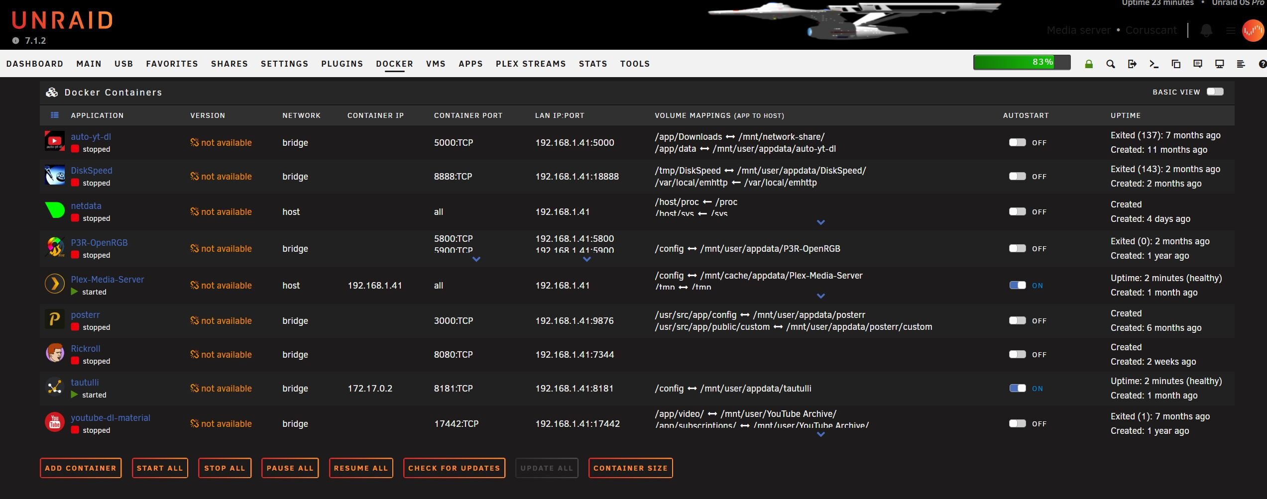

But now docker and my all containers are completely unusable. I can’t launch any containers or even delete/update them. Only Plex starts up because I have it set to launch automatically when the array is started. But once I stop it, I cannot re-launch it. When it’s running, I can view my library like normal, but when I play something, I get a playback error.
I’ve tried disabling and re-enabling docker in docker settings and that did nothing to fix my problem.

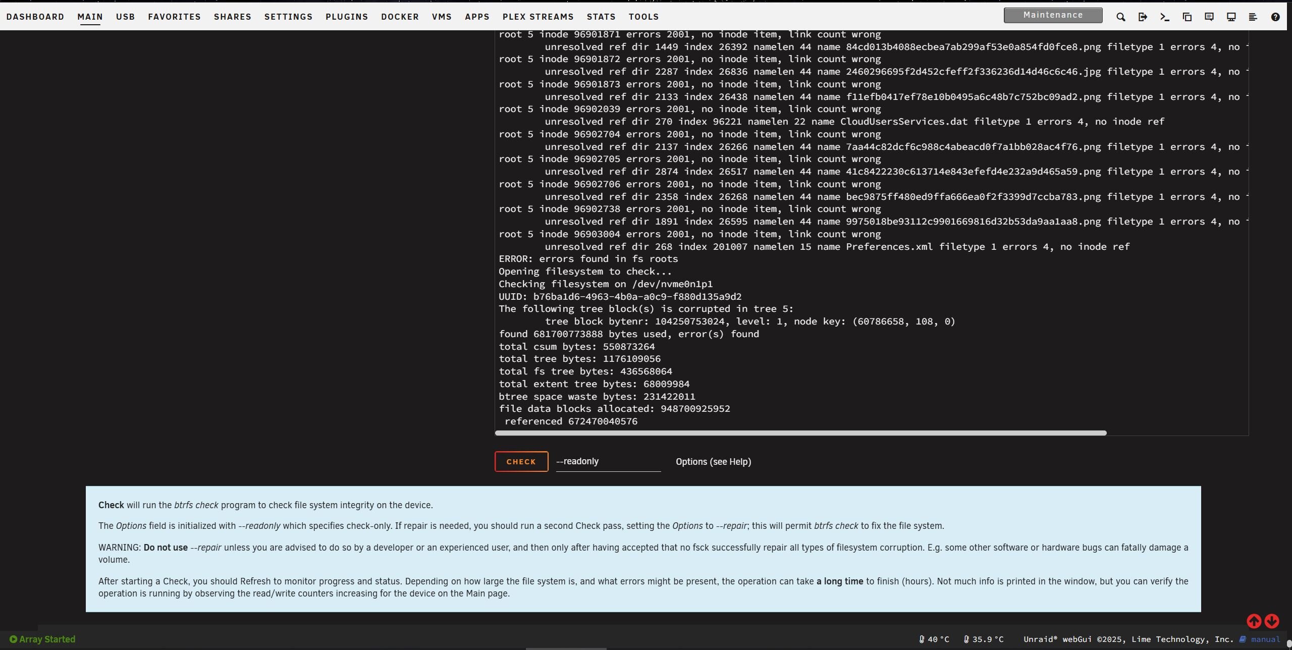

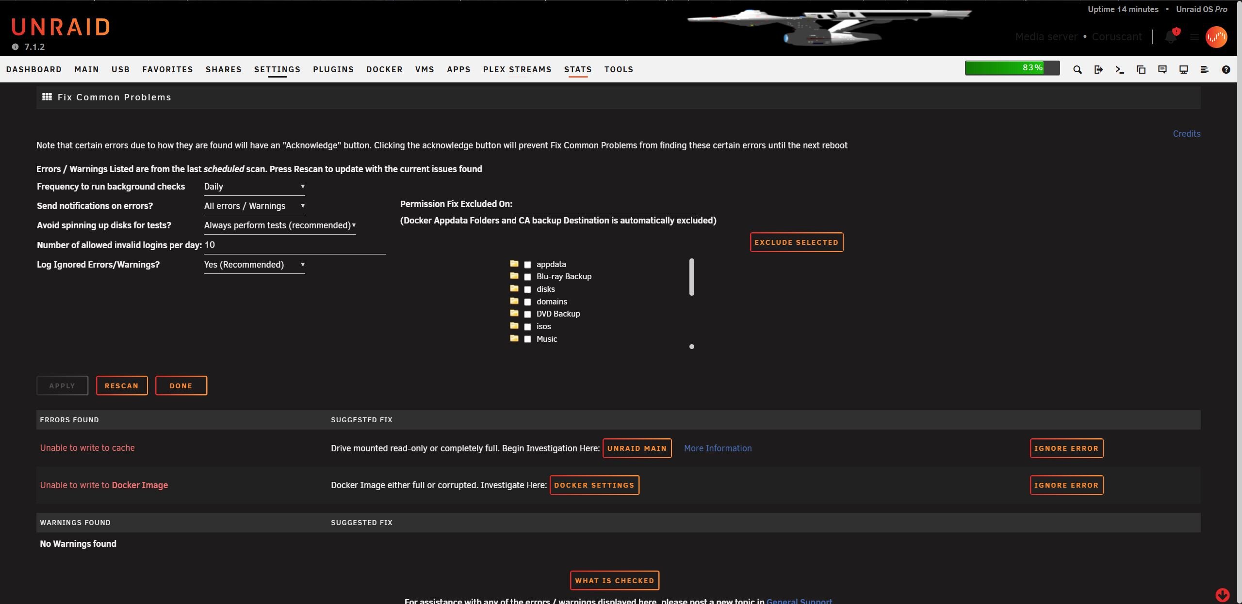

I ran memtest86+ off of a separate flash drive and found 1 of 4 of my ram sticks to be bad with several thousand errors. So I think I found the cause of my problems. I will try to warranty my bad ram stick and run just two sticks for now, but I think it caused problems with my NVME 2TB cache drive file system. I ran a file system check on the drive and it shows a lot of errors. it gives me an option to “repair it“, but it says don’t do it unless told by someone in the community with experience or someone from Unraid. I’ve posted a screenshot of what it says and a text file of the complete file system check report. Also, the plug-in “fix common problems” says that the drive is in read-only or full.

May 19 23:33:46 Coruscant kernel: BTRFS error (device nvme0n1p1): parent transid verify failed on logical 140856475648 mirror 1 wanted 1608823 found 1739895
May 19 23:33:46 Coruscant kernel: BTRFS error (device nvme0n1p1): parent transid verify failed on logical 140856475648 mirror 2 wanted 1608823 found 1739895
This error is fatal, you will need to backup and re-format the pool, but I also see data corruption errors being detected, so would recommend running memtest first.
