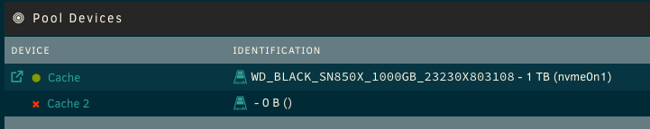

Pool looks like this:
You typically need to power cycle the server to get the device back, just rebooting won't be enough.

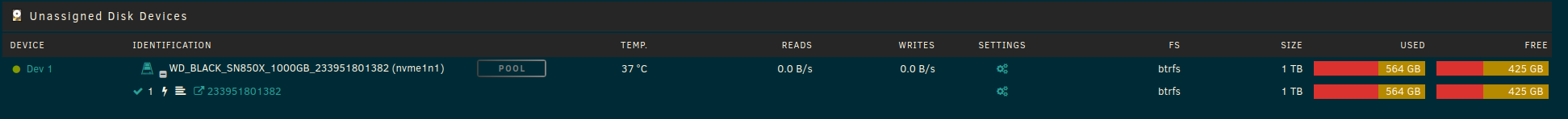

Okay power cycled and the old drive has appeared in unassigned devices, so that's good.
However, the other cache drive, that is part of a RAID1, is now showing as unmountable!

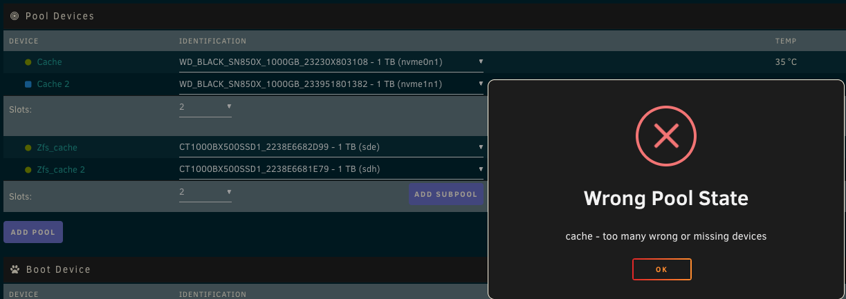

If I change to 2 slots and add the drive in it will not let me start the array. I get the following:
What's my next step please?
Cheers!

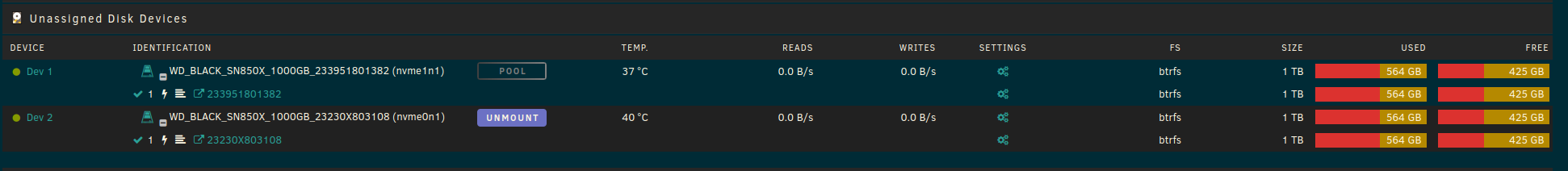

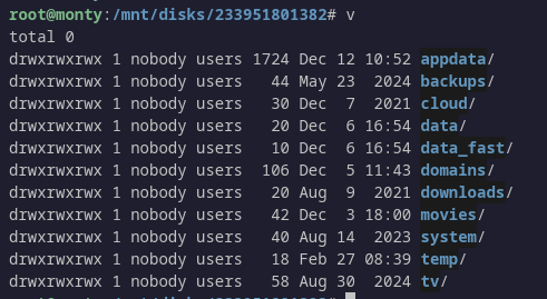

Interestingly, if I mount the supposedly failed drive in unassigned devices I can access it and it seems ok...
If I try and stop the array and switch one drive for the other it shows the one that failed as disabled.
If I remove both but do snot start the array I can mount them both...
Interestingly, one shows up as Pool...

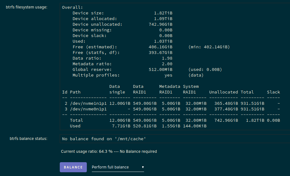

Do I need to do a rebalance or something?
Hmm, is this not in RAID1 anymore?
Balance the pool to raid1
