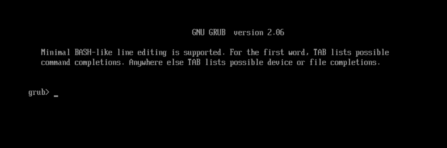

Unfortunately the location where my unRAID server is located had a power outtage and my server is not attached to a UPS. Now after starting up the system again my docker page says "Docker Service failed to start.", and my VM with the uuid 11b7f5fd-88e3-2ad8-8f6f-b1c0734a078c is also acting off and not starting up properly. It is showing a "GNU GRUB Version 2.6" screen:

Ok all of that has fixed the docker error, thank you! But the VM still starts up to e GNU Grub screen. Is the VM image corrupt or something? Is there any way to fix that?
Edited by YourNightmar3
The vdisk may be corrupt due to the pool errors, the system shares have COW disabled, meaning also no checksums, you many need to restore the vdisk from a backup if available, but recommend enabling COW for those shares (I believe you would need to recreate them to change that)
