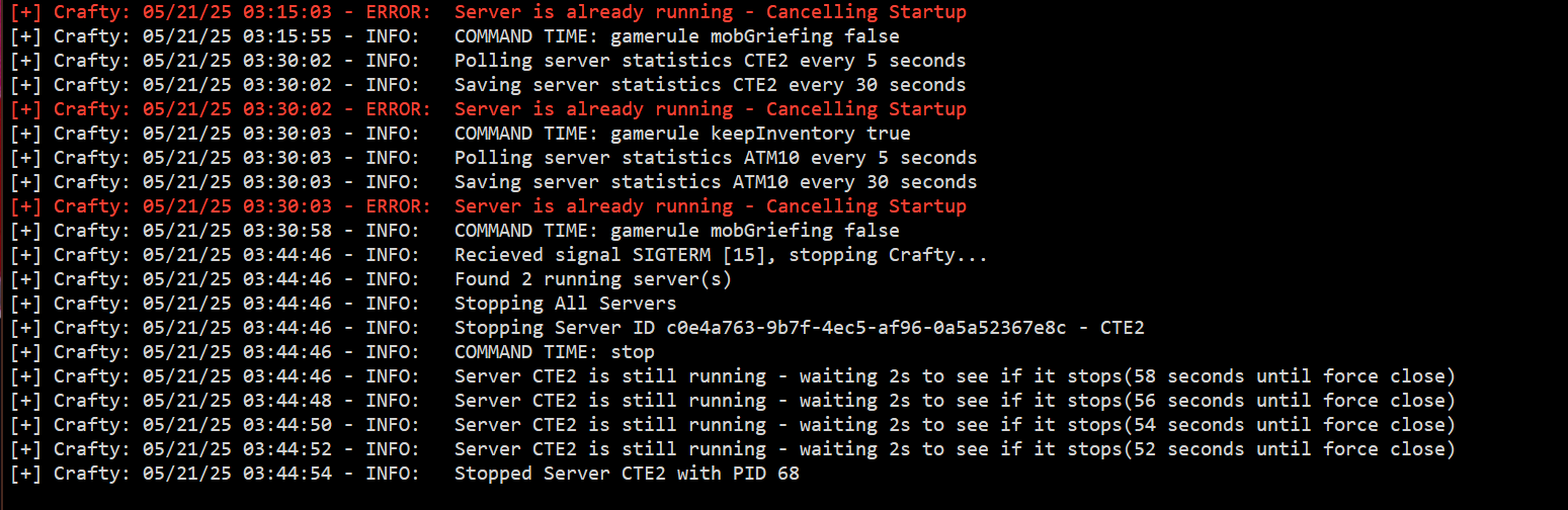

Unraid Is Shutting Down A Docker At Every Morning 3:44AM. How Do I Check Why And How Do I Stop It?
Docker log

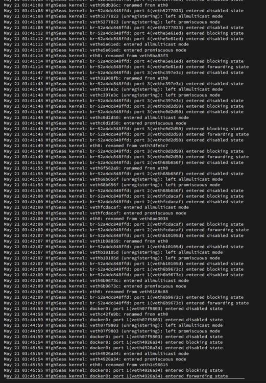

system log
What else do I need to upload? I had a mover scheduled for 3:40 am and that was suspiciously close to the time this happens so I turned that off. yet this happened again this morning? Why the hell ?

The syslog in the diagnostics is the RAM copy and only shows what happened since the reboot.   It could be worth enabling the syslog server to get a log that survives a reboot so we can see what happened prior to the reboot. The mirror to flash option is the easiest to set up, but if you are worried about excessive wear on the flash drive you can put your server’s address into the Remote Server field.

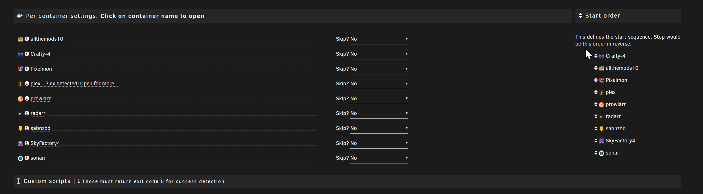

appdata.backup.plg - 2024.11.21 (Up to date)
This is probably set to backup at that time and you've told it to shut down the containers prior to the backup
No other containers shut down. Just the one. Im not sure why only one is shutting down like this
Edited by Paultimate
Might have configured only this one to be backed up.
I have several in the list and they either arnt shutting down or are starting back up properly.
