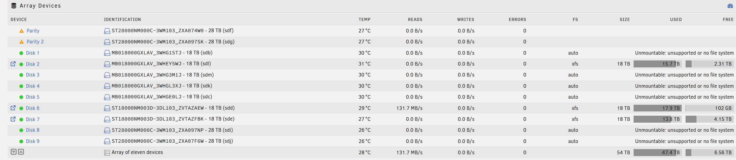

i added 4x 28TB, so 2 of them are set as new parity. Starting the array resulted in a bunch of unmountable disks that contained data from old disk setup.
Big issue because this would mean big data loss.
What are the next steps before i lose 4 disks ?

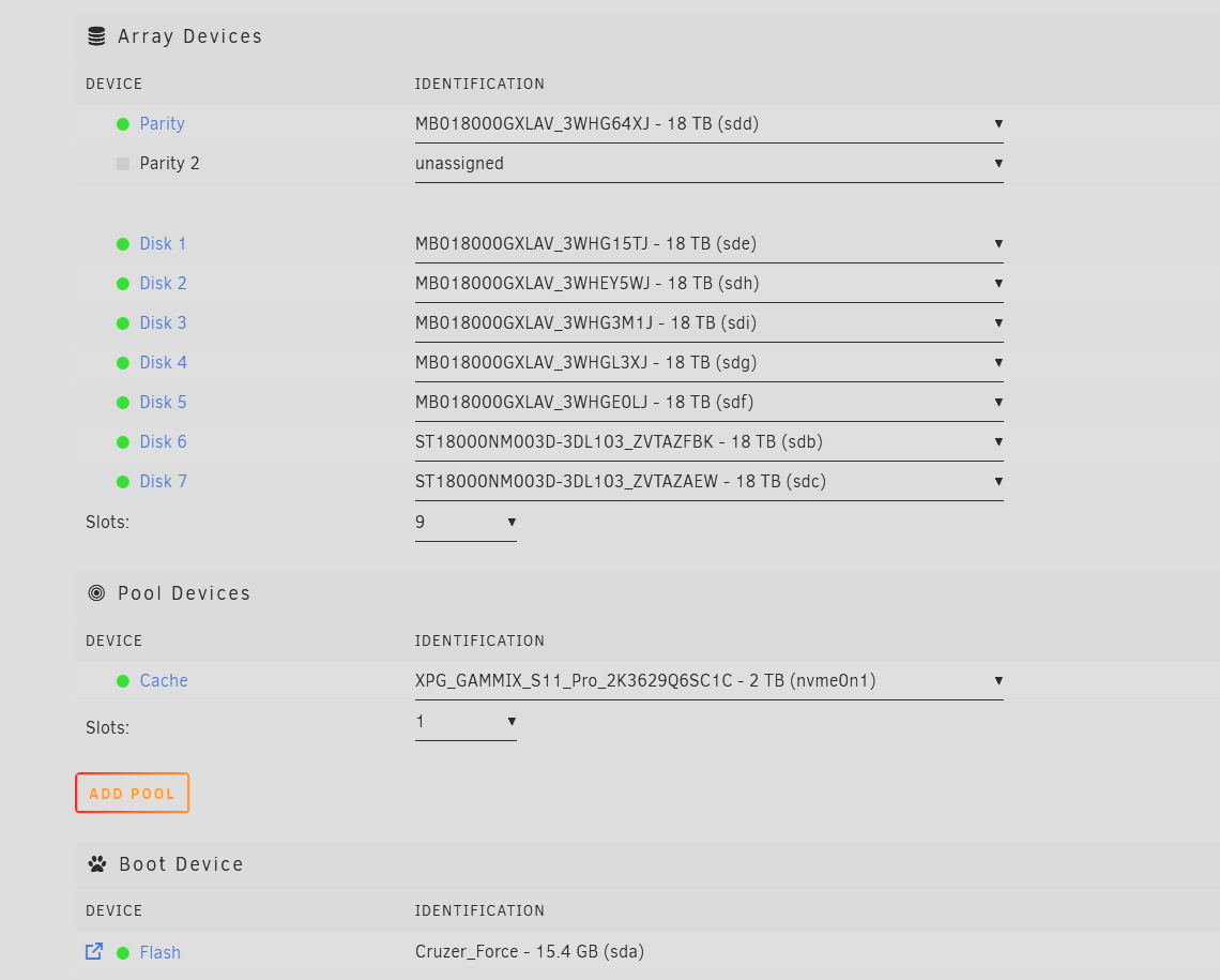

old disk arrangement:

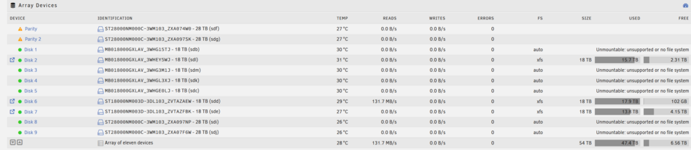

new disk arrangement:

This is the problem, quick fix is to stop the array, click on each disk and change the filesystem from auto to xfs
Permanent fix it to wipe the old zfs signature, you can use:
wipefs -a -t zfs_member /dev/md#p1
This should be perfectly safe, and I've used it multiple times myself and with other users, but always good to make sure backups are up to date, just in case.
This assuming the disks are all using xfs, of course
okay, i first stopped, clicked the 4 disks and changed auto to xfs
after that i tried the permanent fix but that was not possible, the zfs assignment was already gone
array seem to start correct and is building parity
Not sure I follow
i changed filesystem (stopped) to xfs and after that i run the command wipefs -a -t zfs_member /dev/md1p1 without success.
i ran again wipefs /dev/md1p1 which showed no more zfs assignements etc.
so i started the array and all is looking good, parity is created on the new 28db drives.
