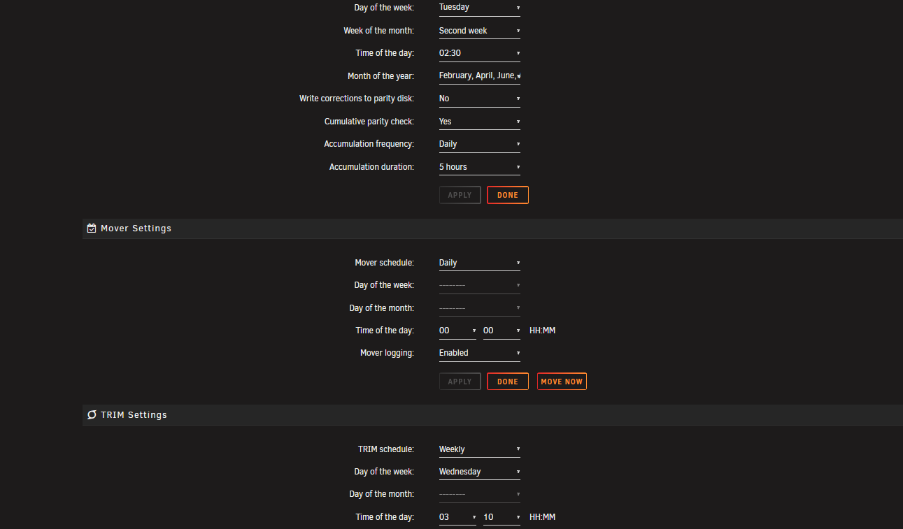

Enable mover logging, run the mover, post new diags and the names of the share(s) you expect to be moved.
Thanks for stepping up.
Mover Logging was enabled for both of those moves. I triple checked that it is still enabled, tried to move again, and grabbed the attached diagnostics.
I am expecting /data to move
unicorn-diagnostics-20250522-0932.zip
