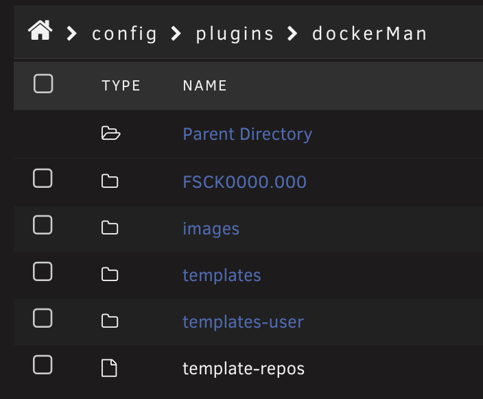

A couple days ago I decided to update to 7.1.2. The WebUI froze during this update, but when I refreshed it told me it was ready to update and needed a restart. I did and the machine was just giving me a black screen. So, I decided to create a new USB, copy the /config/ and restart. Everything worked. Then I did another restart and everything went black. I tried a new USB-device, same thing happened. First startup was fine, but restarting just yielded a black screen. So, I decided to roll back to 7.0.1. Same thing. I am not sure where to continue from here. One thing I noticed after rolling back was that the docker templates were missing. After further inspection they have been moved to another folder:
Is there something wrong with my USB backup maybe? Is that something I can fix?

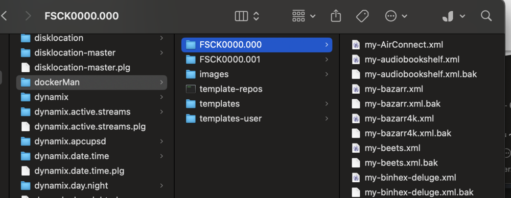

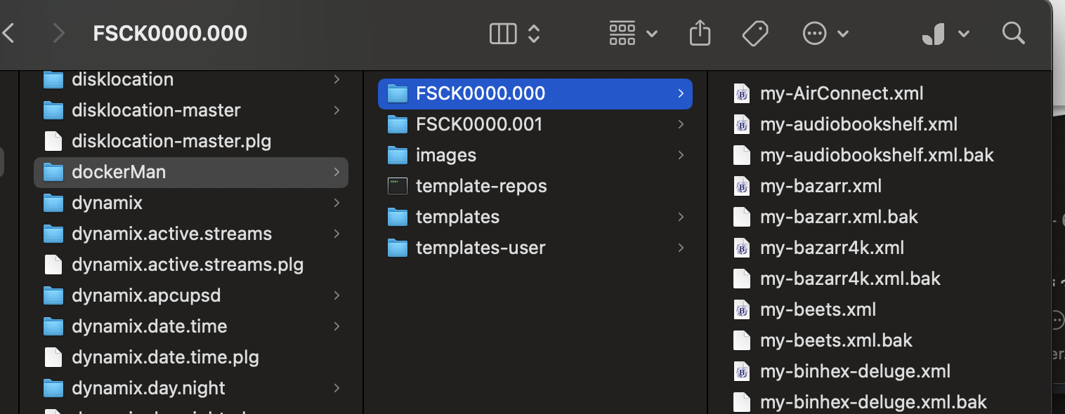

So. I tried again to start with a fresh USB but copy the /config/ to try and investigate. Unraid once again did this to my dockerMan folder and put all the templates in FSCk0000.000:
Attached is also the diagnostic file. Any other ideas going from here?

1 hour ago, Nimrad said:
FSCk0000.000:
This usually means there's a problem with the flash drive, or with the USB controller.
That means corruption was detected on the flash drive. The FSCK type files are the result of an attempt to repair the flash drive.
