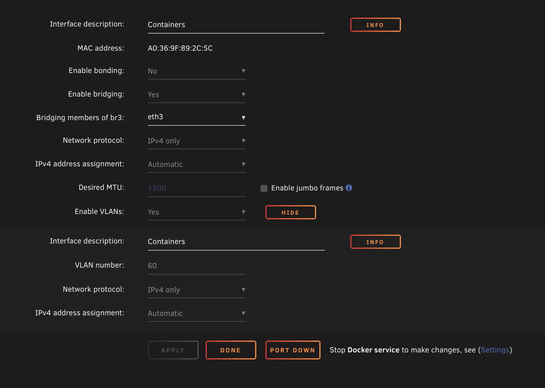

In truth I don't see how you have br3 and how it was created.
We may need to remove teh br3 interface/ and/or eidt the subnets IP and DHCP pool to the coert info that unif is using.

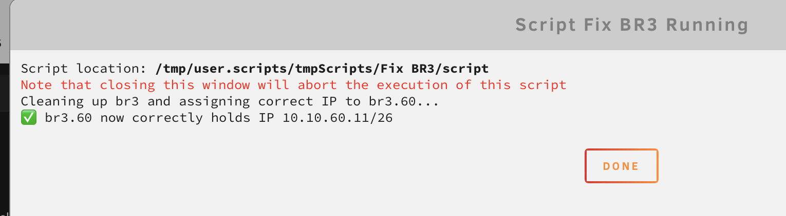

unraid v7 changed teh web UI. thus user scripts and other settings like termainl comadns. may be need to editeh unraid network configurations now.
heres a user scirpt to run (It may need to bbe a user script to run at first arr start...
fix th br3 interface ips
#!/bin/bash
# Wait for network stack to come up
sleep 10
echo "Cleaning up br3 and assigning correct IP to br3.60..."
# Remove IP from br3 if it has one
ip addr flush dev br3
# Optionally take br3 down and up again to be sure
ip link set dev br3 down
ip link set dev br3 up
# Assign static IP to br3.60 (VLAN 60)
ip addr flush dev br3.60
ip addr add 10.10.60.11/26 dev br3.60
ip link set dev br3.60 up
echo " br3.60 now correctly holds IP 10.10.60.11/26"

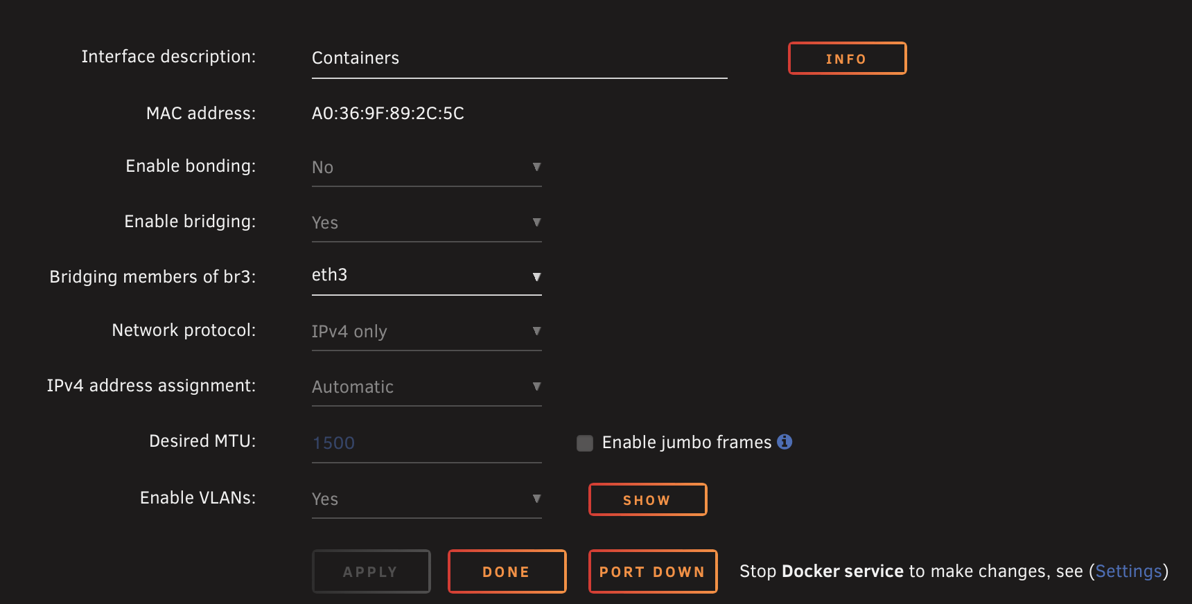

When I assign NPM to another network I can access it. However, when it is on the newly created docker I can't access it. in NPM I see this.
[app ] [5/31/2025] [8:45:46 PM] [IP Ranges] › info Fetching https://ip-ranges.amazonaws.com/ip-ranges.json
[app ] [5/31/2025] [8:45:51 PM] [IP Ranges] › error getaddrinfo EAI_AGAIN ip-ranges.amazonaws.com
that normal until you fix unraid network.

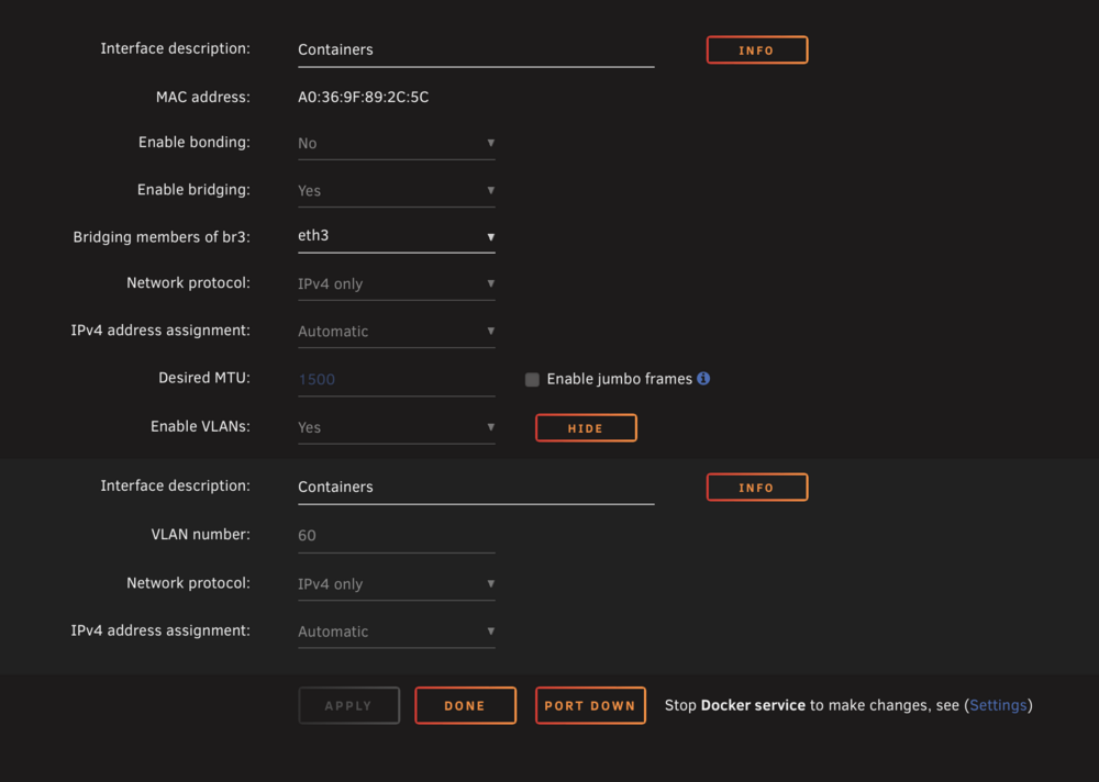

br3.60 isn't talking to the unfi vla and getting a dchp address on vlan 60
but br3 is on vlan 1
I aume yo made br3 and asigned it to eth1
given the ip a
pleas runt eh user script to flush br3 adn asing the ip addres to br3.60 the corect interface
given the ip a
I ran it and this is what I got.

OK how does uraid conect and get back to the unfi device to coenct to valn 60?
is br3 tiedt to eth1 ? eth2
what cord where is conecting to unraid (I will ned more info to define a ip router latter. Esentail we need to rebuild teh br3 interface it is not setup corectly. and shoulnd't exisits (was expecting to do this to br0
You apear to have 2 eth nics and wifi. is only 1 nic connected?

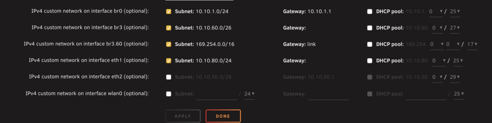

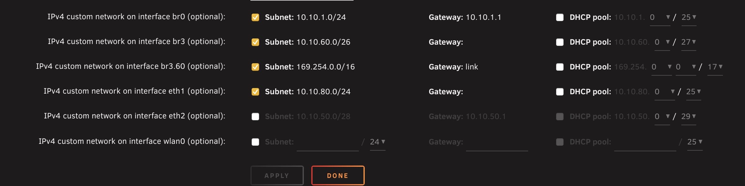

dam.. we have a broken ip route...
default dev br3.60 scope link src 169.254.227.107 metric 1001401
169.254.0.0/16 dev br3.60 scope link src 169.254.227.107 metric 1401
please run this script. we will need to manual clean the route and fix the interfaces...

169.254.0.0/16 dev br3.60 scope link src 169.254.121.232 metric 1401

BR3 is only tied to one eth03.
I'm not sure how to porceded as its mutiple nics.
unifi > vlan 60 > 10.10.60.0/26 > ??? > Unriad ethernet 3 > Br3 > br3.60 > vlan60_macvlan > Docker...
This is What's Still Wrong
1. br3.60 has a valid IP (10.10.60.11) but also an invalid fallback IP (169.254.x.x)
This means:
  • The kernel thinks no DHCP server responded on br3.60
  • But you statically assigned 10.10.60.11 in the script
  • Something is still trying DHCP and failing — probably Docker
You have both:
  • br3 with 10.10.60.10 via DHCP
  • br3.60 with 10.10.60.11 via static
This is likely wrong — you don’t need IPs on both.
The shim-br* interfaces are gone — good cleanup there!

in unraids web ui for br3 click show vlans do you see vlan 60?
I do see vlan60.

I followed everything you placed on the earlier message.
Do we even need to tell unraid that vlan 60 and not just pass BR3 to the container? would that be easier? Thank you for all your help on this. I have learned a lot so far. I really appreciate you.

Do we even need Bridge mode? Can we just take off br3 and leave it at eth3?
Correct that the plan.
The software bridges are getting in the way and causing extra network issues.

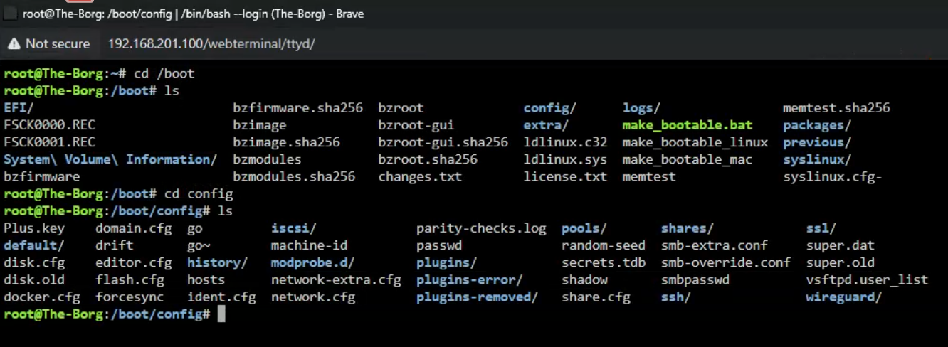

in unraid going to /boot is the flash drive.
we want to nuke the netwrok config and rebbot this way we start fresh from a unraid default network config (this has been known to fix the network names and small bugs from v6 to v7 with vhost to shimbr0
This will bring eth1 back to a dhcp IP...
Please turn vms off and docker off until this porcess is complete.
Reset unraid docker netowrk to guranteee defautl configurations.
cd /boot/config
rm network*
reboot
this reset unraids to factory default network configurations.
Then at the reboot. lets edit unraid settings and turn off bridge and turn off bond.
leave eth3 settigns alone set eth1 up for your stati ip and other interface connections.
Edited by bmartino1

I removed the network configuration like you said and took off bond and bridge for interfaces. Now, when I open NPM container and Jellyfin again by going to their new ip address, I can get to the containers. But when I setup the correct IP address in NPM and also on Unifi port forwarding, it does not forward the traffic to the container on the same network.
When I switch back to my proxy network in unraid ip network 172.18.x.x and I change the port forwarding in unraid to forward to NPM, then it works. But on the 10.10.60.x network in unifi it does not. This is so annoying. I know what I am doing network wise and still nothing. GGRRR
