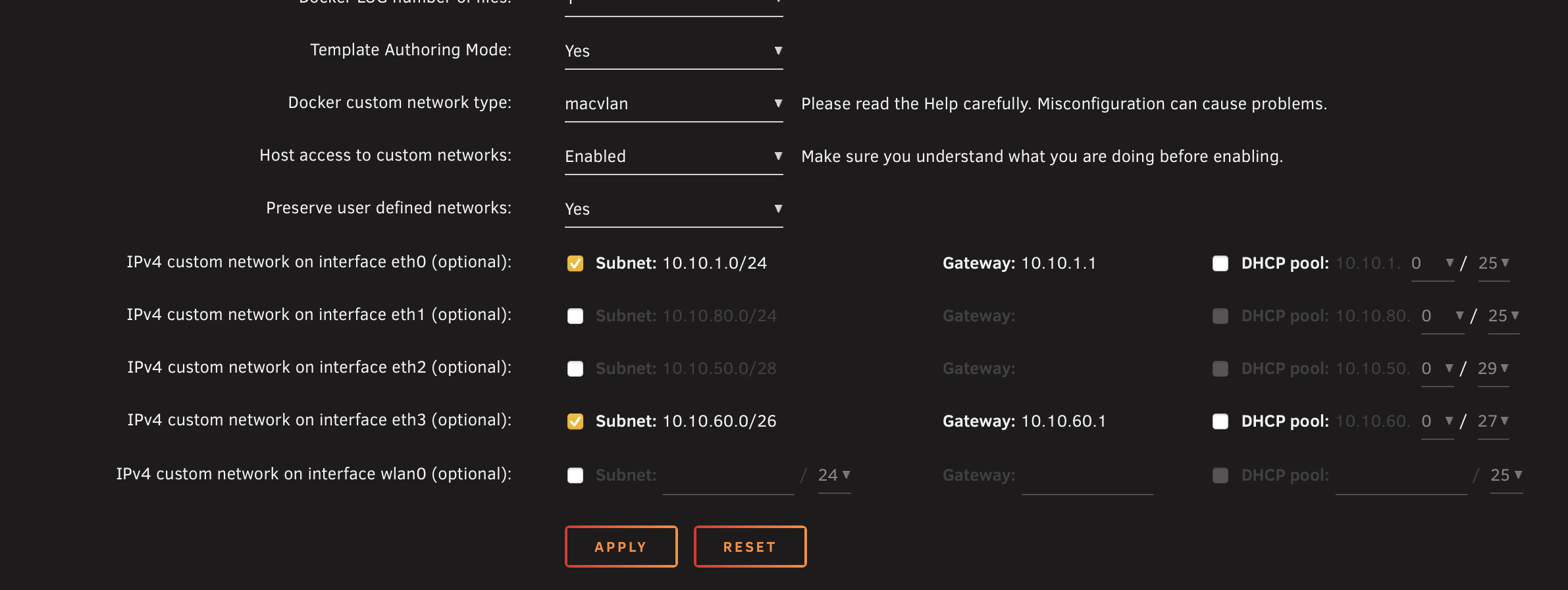

Since we/you are igging into a nuanced VLAN and macvlan setup in Unraid with UniFi, and the issue you're facing is expected behavior due to how macvlan isolation works and VLAN segmentation is enforced.
Here's a breakdown of the current situation and potential solution:
  • You've removed bonding/bridging — good.
  • You've set static IPs and created a VLAN interface (eth3.60) — good.
  • Containers like NPM and Jellyfin are reachable internally via their 10.10.60.x IPs — great.
  • You've created a macvlan docker network on eth3.60, which isolates containers at Layer 2 — correct setup.
What’s not working
  • Port forwarding from UniFi to 10.10.60.x (NPM) doesn’t work. That’s normal behavior for this setup.
Why this happens:
  1. Macvlan networks isolate containers from the host (Unraid itself), and unless traffic enters from an external source within the same VLAN subnet, it gets dropped.
  2. UniFi cannot forward from another VLAN or subnet into VLAN60 without a proper Layer 3 route or NAT/firewall rule allowing it.
  3. Port forwarding in UniFi from the WAN side into VLAN60 (a non-routed internal network) only works if:
    • There's a route from WAN → VLAN60.
    • The NPM container has a reachable gateway and firewall allows it.
Time to add unif routes for cross talk
(Hate the new forum...)Option 1: Add a VLAN60 interface to UniFi port
  • Go into UniFi Controller:
    • Find the port NPM is connected to.
    • Add VLAN60 as a tagged VLAN to that port (or native depending on your network setup).
  • Make sure UniFi has a gateway/firewall interface in 10.10.60.0/26.
  • Then set up port forwarding inside UniFi, from WAN to a VLAN60 IP.
-What I would prefer you do...

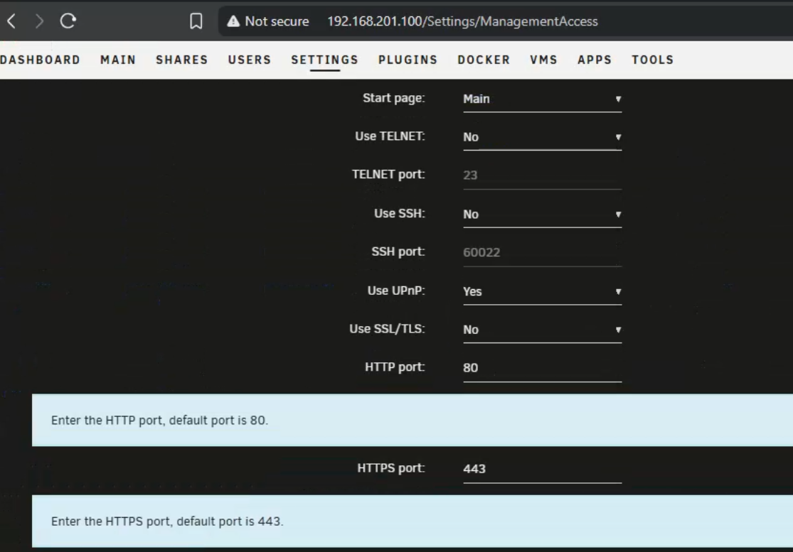

Option 2: Put NPM in a bridge or host network
  • This allows NPM to listen on the Unraid host's IP instead of an isolated VLAN.
  • Less secure but works for basic setups.
  • Requires moving host web ui porst in setting management
Option 3: Use ipvlan instead of macvlan
  • Requires deleing the docker network...
  • ipvlan allows Unraid host communication with the container.
  • Create Docker network with -d ipvlan and test connectivity.
    use ipvlan - though I'd recomed staing on macvlan
    docker network create -d ipvlan \
    --subnet=10.10.60.0/26 \
    --gateway=10.10.60.1 \
    -o parent=eth3.60 \
    vlan60_ipvlan

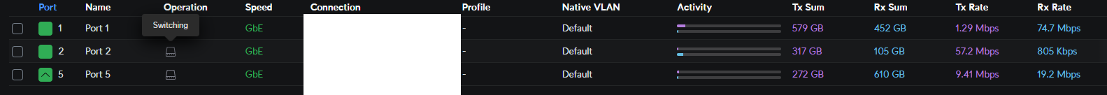

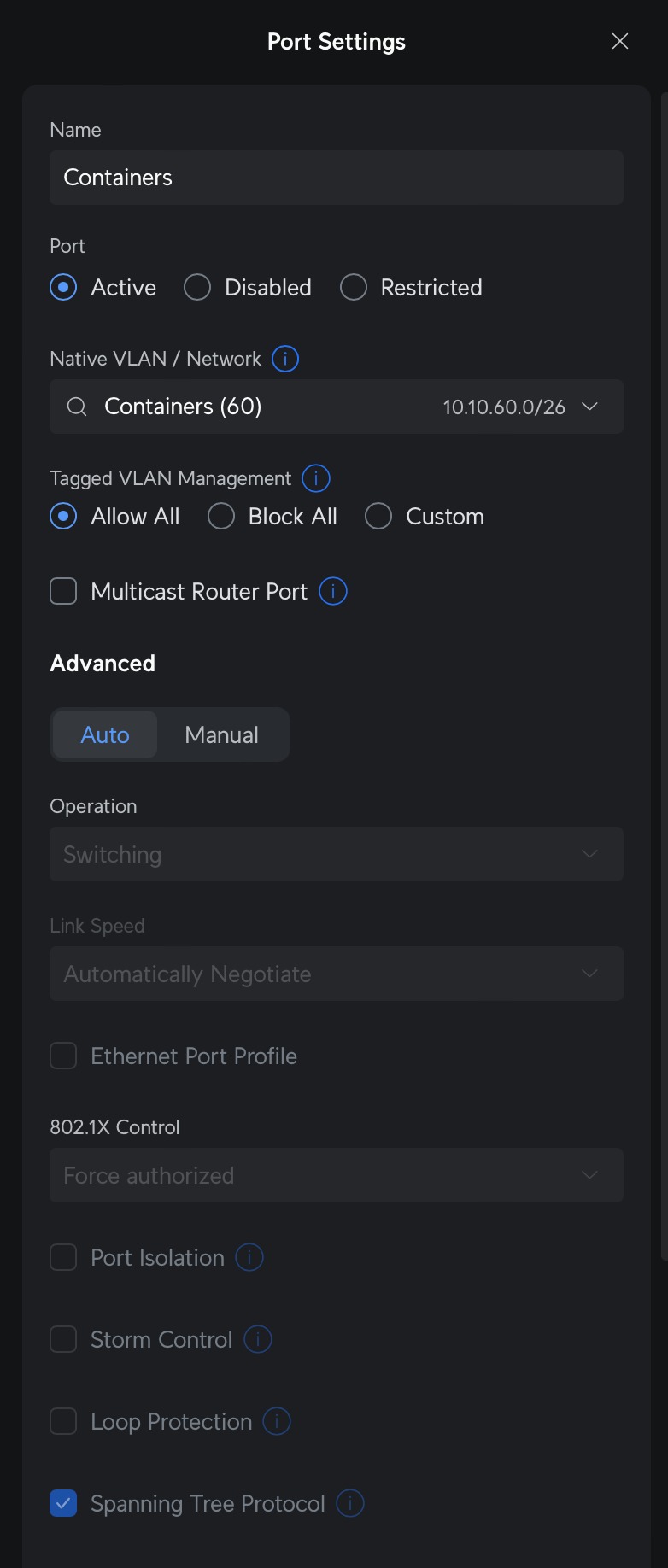

1 minute ago, Tucubanito07 said:
I have port 5 on Vlan 60
ok and a device conecte to port 5 ios getting a vlan60 ID
with the client device on vlan 60 gettign a 60.x can it ping the npm ip of the docker in that netwrok?
On this picture you can see that the network 10.10.60.1 on the network settings shows the gateway.
except vlan 60 is untaged...

I cna't guirantee that unriad is on nor using vlan 60 as eth3.60 done't exisit as a interface that tagets teh eth3 as a tage vlan for eth3.60
this means that unraid is using eth3 as a untaded valn and may be using teh default vlan for cros talk and using vlan id 1 over eth3
your unriad netork is still in a misconfigured setting...
You have
unif > vlan60 > xyz port 5? > ??? > unriad port 3 > untaged eth3 > dokcer network vlan60_macvlan > jellyfin/npm
when you need
unif > vlan60 > xyz port 5? > ??? > unriad port 3 > taged eth3.60 > dokcer network vlan60_macvlan > jellyfin/npm

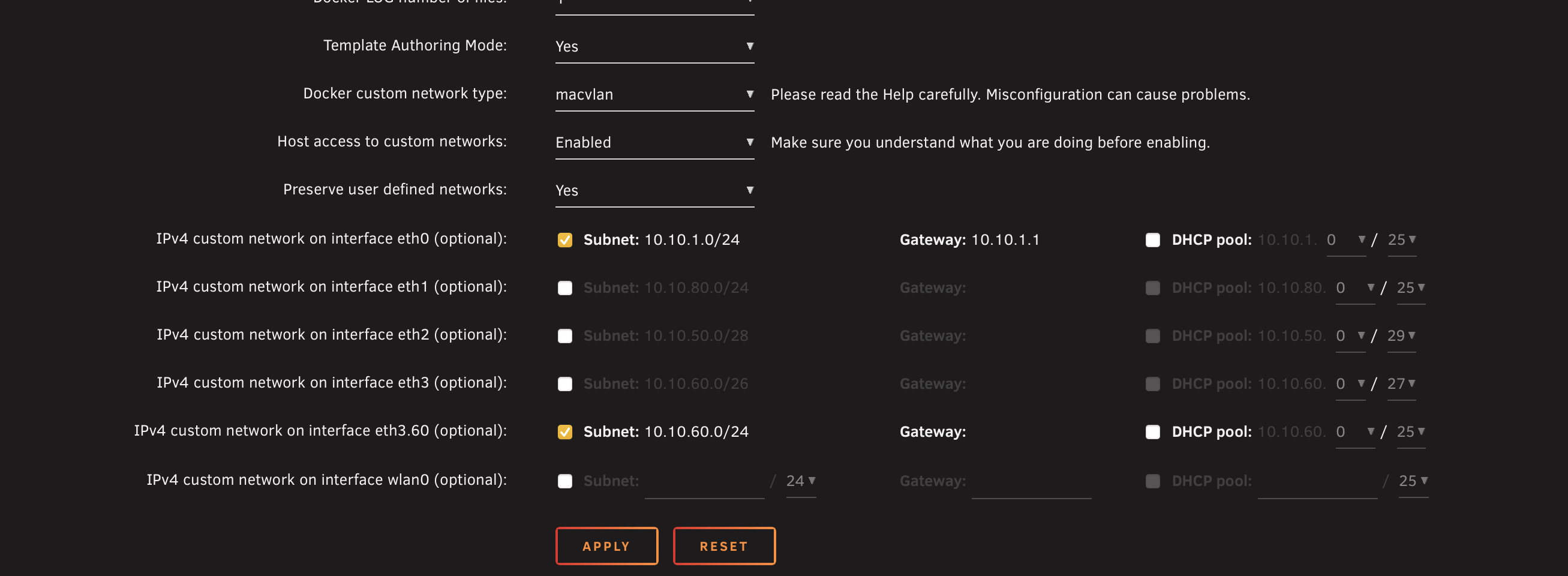

If I add the Vlan 60 in unraid it get again the 169.254 ip address.
Edited by Tucubanito07
I now see this.
NPM goes back to not working again.
I now see this.
perfect you need to make sure the docker network is using eth 3.60
docker netowrk inspect vlan60_macvlan
verify that the parent is teh nriad eth3.60
So when NPM is on the network. I click on the container and open console. In the console of the container I ping Jellyfin on 10.10.60.3 it is reachable. Now, I am not able to get into NPM because when I try to open the webui it goes to the unraid main ip 10.10.1.43 and I close it and then the NPM 10.10.60.2 opens but the username and password load and can't get it.
root@Tower:~# docker network inspect vlan60_macvlan
Error response from daemon: network vlan60_macvlan not found

YOU MUST CHANGE UNRAID WEB UI PORTS! and npm need port 80- and 443....
Setting > managment
