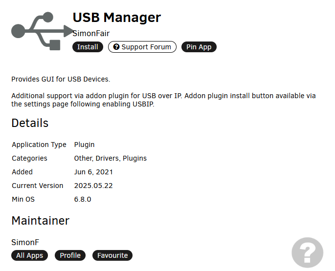

The second is more annoying. I have a device which is connected to the physical USB slot on the server. I pass that through to the VM by checking the box in the server config page. That makes the USB device available to the VM and everything works. But, again, if the machine is restarted, the USB selection is lost. Is that something I'm doing wrong, is that a bug, or is that expected behaviour?
Is the USB connected to another VM?
IF so when teh VM went off it was connected and now apart from another VM thus It was not avialable when that VM started...
Use the plugin USB Manger to assist with USB devices..
this will give you more otion at when this VM starts have xyz USB and vise versa... This seems more like mutiple USB added to mutiple VMs and not known what the device is connected to...
The USB at the bottom are "etherail" they exist and are 100% saved to teh XML like the disk drive early if they are not avilalbe when off they are in use else where...

I didn't know about the USB manager plug-in, I'll give that a shot and report back.
