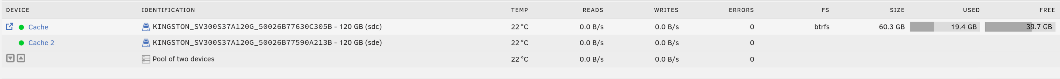

I don't understand why the second drive is showing up like that, this is how it looks in unraid dash:
Edited by djkato
Could it be because I pressed the balance button twice cuz UI didn't react, so it interrupted the first one only partially formatting it (that's the 600mb?) and on second press it locked up, now being confused?
I feel like just removing the drive and adding it again could work? I don't see a way to check if it has any data on that second drive though
22 minutes ago, djkato said:
600.00MiB
Btrfs is detecting this device as 600MB, not sure why, but the easiest way to resolve may be to copy all the data somewhere else, then recreate the pool, and see if the space is correctly detected.

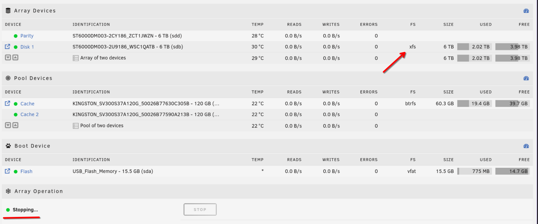

(edit, forum deleted all my text ?!) Hey, It's been trying to stop the array for almost an hour now. Not sure what to do? Or if force turning off the server is safe. The parody is apparently good.
Also, you said XFS is for single drive. Is it ok that my main drive is XFS, or is that a problem?
Edited by djkato
In the main array each drive is a self contained file system so any format is allowed. In pools you can only use xfs in single drive pools.
still isn't stopping sou... how do I stop it safely?
If it won’t stop by itself then normally all you can do is a forced stop by holding down the power button.
