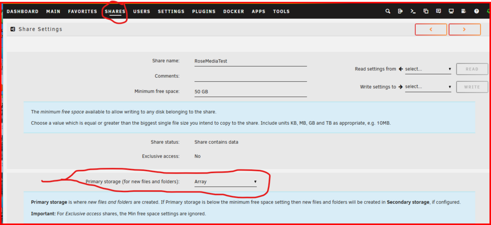

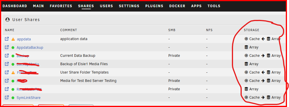

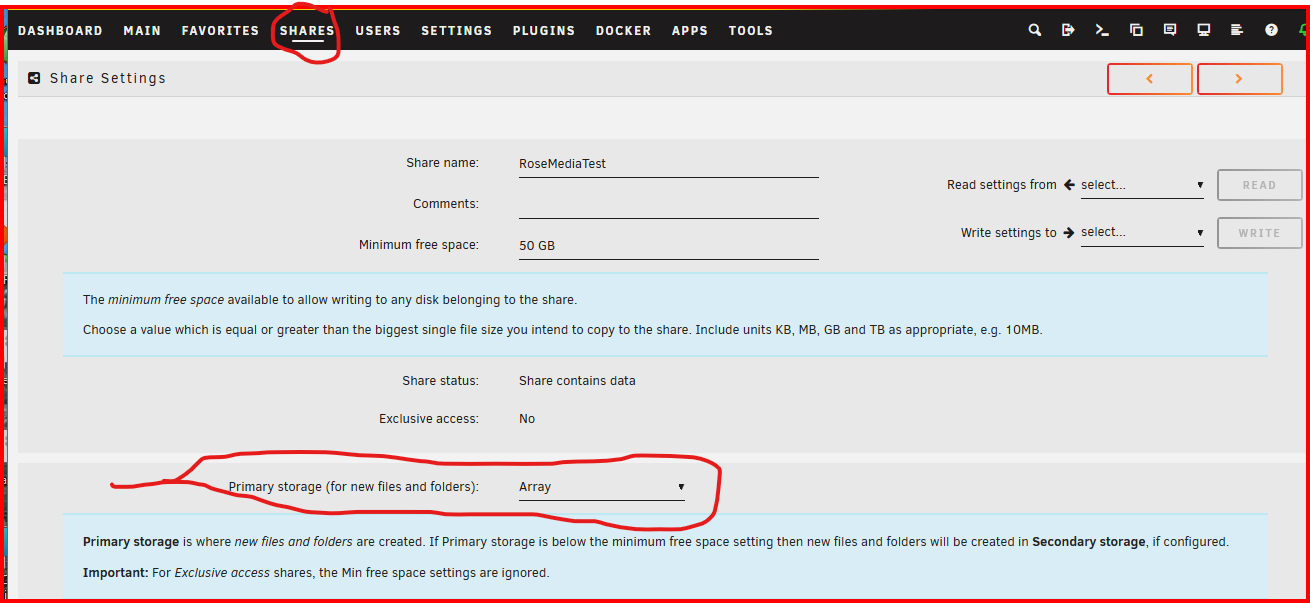

Make sure you have this setup for all your shares:
Once you have something besides 'Array' for Primary, you will be give a choice for a secondary location.
And you should see something like this:
All are currently set to Array. However even if I wanted to change the settings, on "Save" it reverts back to the way it was.
