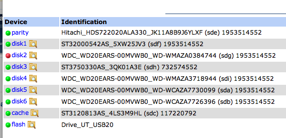

Hi guys,
    My wife informed me tonight that our server had crashed.  The web interface was not responding, and Samba advertised all of the user shares, but I was unable to browse them.  I proceded to follow the instructions on the wiki to shut down the array from the command line, but it hung.  After waiting 30 mins or so I ran reboot -n.
    When the box came back up my tower status was amber, and one of my data drives had a red indicator.  I then searched the forums and did some basic troubleshooting.  Powered down changed power/sata cables etc.. At this point I am ready to order a drive to replace the failed one and then troubleshoot that drive offline, and RMA it if I must... but I have one problem...
The problem:
I have a 2tb parity drive.  I would like to order a 3tb drive for the new drive, and swap the parity out... but I don't believe this is possible with the status of the array.  Is there any way that I could accomplish this with out having to bring a 2nd new drive into the equation?  Is there some way that I could copy the parity data to the new 3tb drive, so that I can use the current parity drive as a replacement of the bad data drive...?
Thanks!
PS: Odd thing is that drive seems to have passed the smartctl  (Ran while the indicator was red)

Hello,
Sorry for your trouble. Even though the smart was passed check out the reallocated sector counts. I think that drive is about done.

Thank you!  This will be a life saver....  I guess I can fire off this order from amazon it is going to hurt the wallet... a bit, but if it is as easy as that article is hopefully it will only be a pain there and nowhere else.
The failed drive is covered through 2013, so I will probably get it RMA'ed and have 2tb of more space...

The "swap-disabled" procedure will ONLY work if the disk you are replacing has been disabled first.  In your case, since the disk is "red," it has been disabled, so it should work as expected.
I mention this only because someone in the future might try to swap disks around just to install a larger parity disk in an array with all working drives.  That movement of two disks will probably not work as expected.
