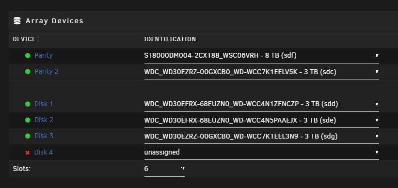

Disk 4 was sdc which is now parity 2. I took this screenshot today so I know the configuration.

Doesn't look like you started the array after the New Config.
Also, parity will not be valid without disk4.
So, uncheck the Parity Valid box, and start the array.

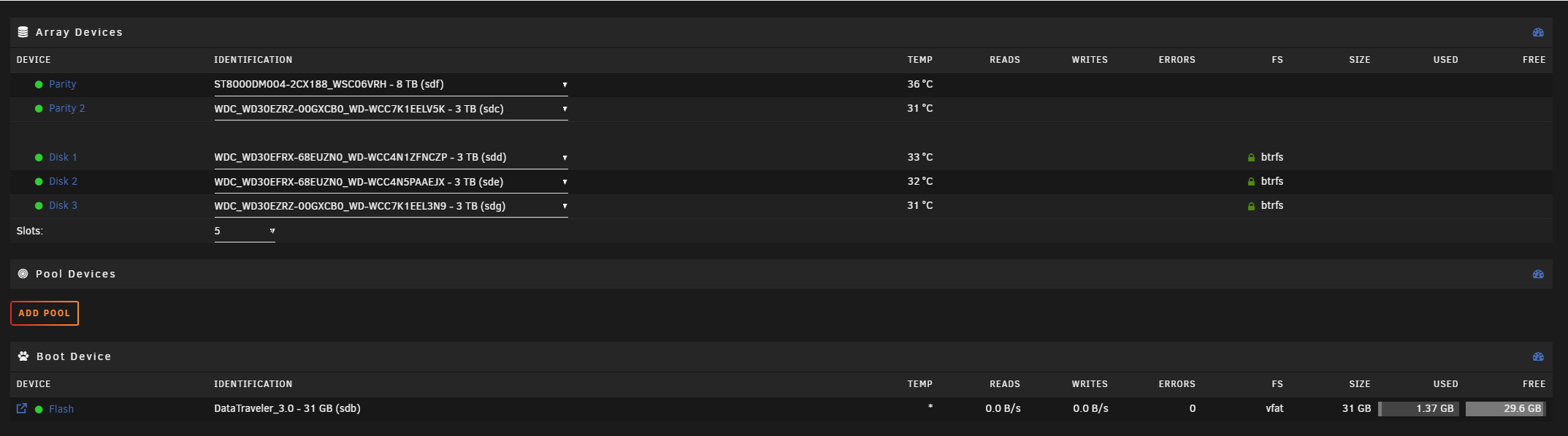

I am a little confused right now because I did start it. I just saw that something went very wrong and stopped it again to have a chance at recovering this mess.
I do not have the parity valid box anymore. This is what I am looking at right now:

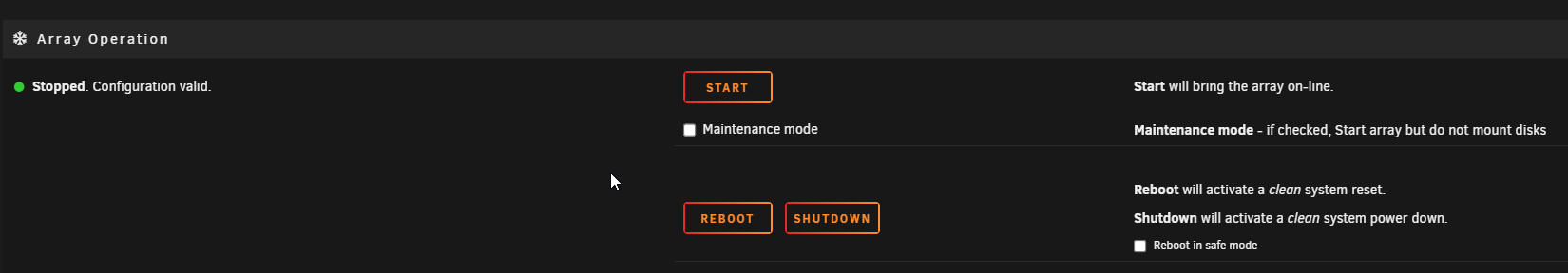

Just a normal start or should I start in maintenance mode?

If you start in maintenance mode, no disks are mounted, so no shares or anything else is accessible.
Start in normal (not maintenance) mode and post new diagnostics.

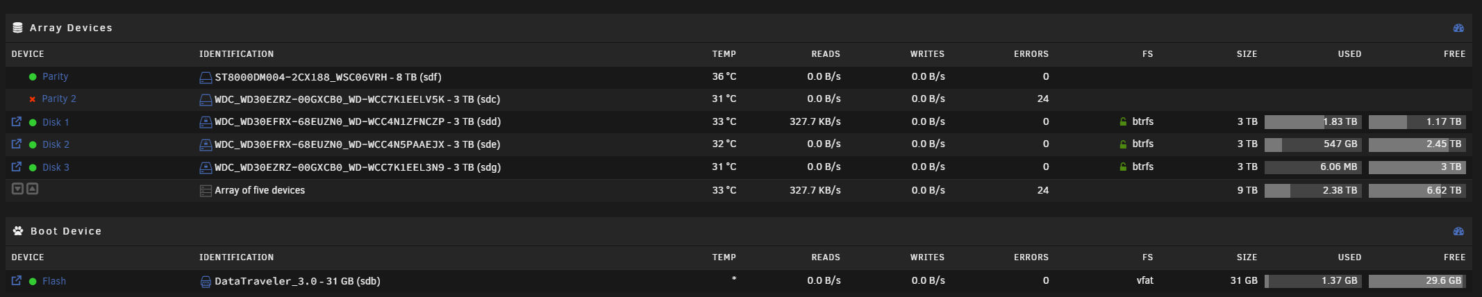

It started up and most shares are availible now, I probably started in maintenance mode before then. Now I feel stupid.
Parity 2 disk is shown as disabled, not quite sure what's up with that yet.

Shutdown, check connections on parity2, both ends, SATA and power. Then start again and post new diagnostics.

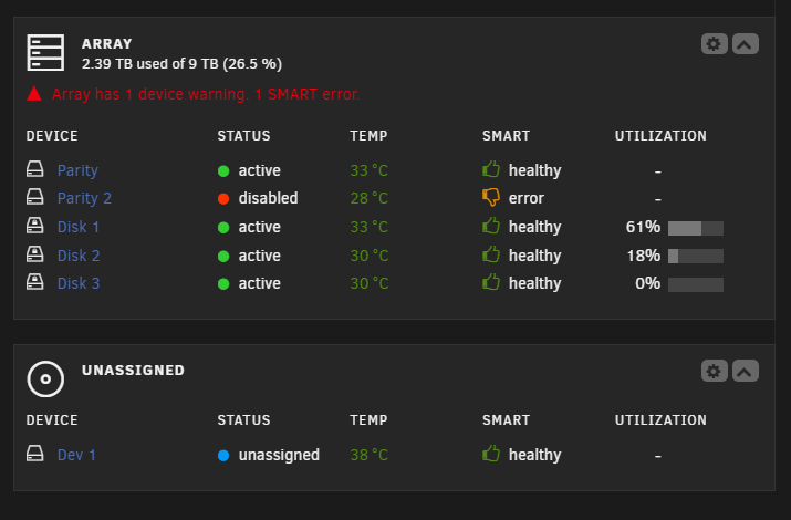

Yes, parity 2 shows the UDMA CRC errors that are common.

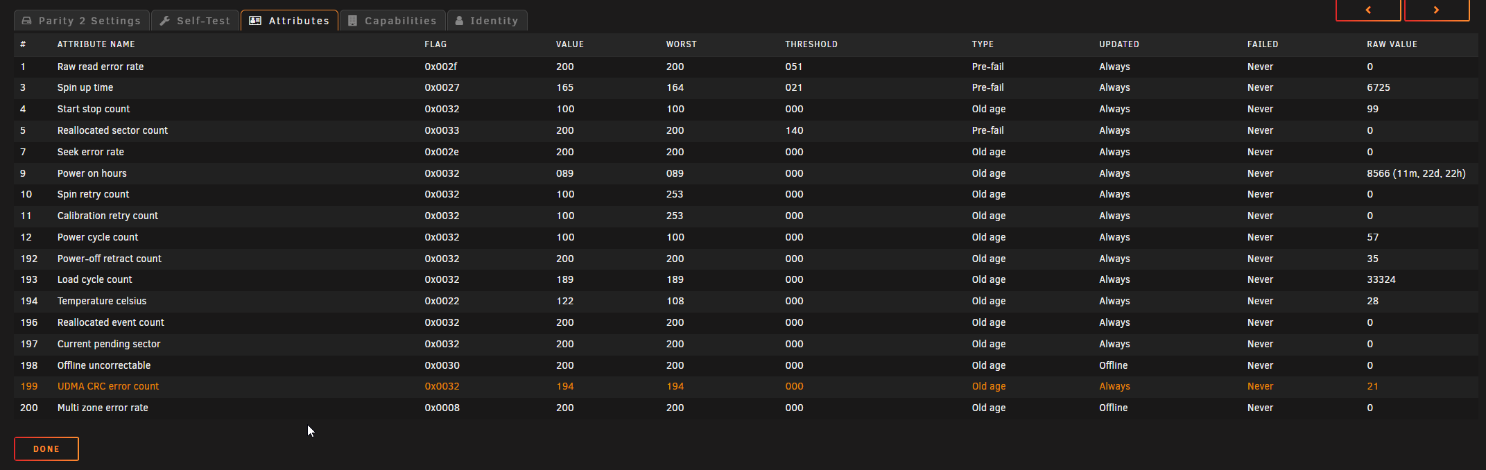

After clicking on attributes for that disk:
I also ran a short SMART test for that drive but I can do a long one too if that helps. littleboi-smart-20250530-1548.zip

Click on the SMART warning to Acknowledge, and it will warn again if it increases.

Yup, I acknowledged it. Now all drives show the green thumb up again.
