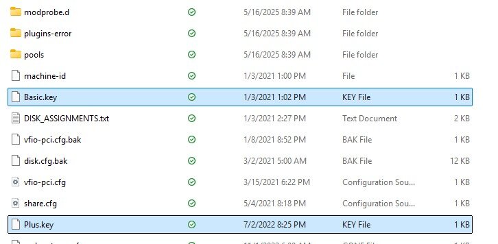

Long story short, I'm getting missing license errors now. Here's how it happened.
1) backed up USB on desktop
2) stopped array, zeroed my drives
3) formatted and rebuilt USB clean, dropped my Basic.key and Plus.key in the /config folder
4) rebuilt my server
5) everything went good for a few weeks, then it puked and says its missing the key.
6) login to my unraid acct, get the key URL, paste into console
7) mocks me with below screen shot
8) my PC allows me to look at my USB, but when I attempt to look at it in the unraid filemanager, it will not mount the USB
Edited by DaSlinky

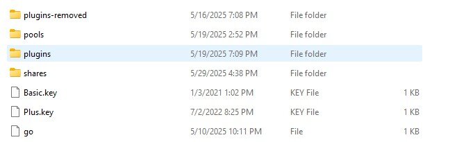

Only put the highest tier, looks like you upgraded at some point so get rid of that Basic.key, it's no longer needed.
But if the drive won't mount it's probably failing and needing replacement.
Edited by Kilrah
so, basic computing 098. a simple reboot resolved the issue. I was hesitant to do this because it said it wouldn't start the array if the issue wasn't resolved.
