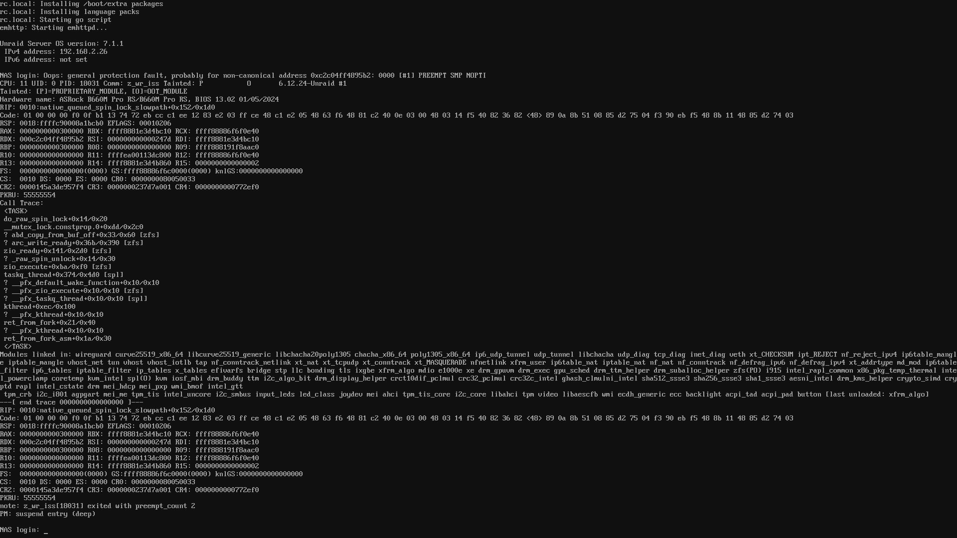

You may notice a time discrepancy in the log. This is the result of the server sleeping, I use the Dynamix S3 Sleep plugin. I'm attaching a screenshot of the console and the log.Console Screen Shot - TinyPilot-2025-06-02T14_44_37.172Z.jpgsyslog-NAS.log

There's a zfs related crash, suggesting a problem with the pool, or a hardware issue making zfs crash, post the diags mostly to see the hardware used, in cases there are any known issues.

41 minutes ago, Morris0 said:
For my education, what told you it's ZFS?
The call trace mentions zfs:
Jun 2 08:12:41 NAS kernel: ddt_enter+0xe/0x20 [zfs]
Jun 2 08:12:41 NAS kernel: zio_ddt_write+0x62/0x420 [zfs]
Jun 2 08:12:41 NAS kernel: ? zio_push_transform+0x34/0x80 [zfs]
Jun 2 08:12:41 NAS kernel: zio_execute+0xba/0xf0 [zfs]
I missed that on the screenshot before, since it's less visible.

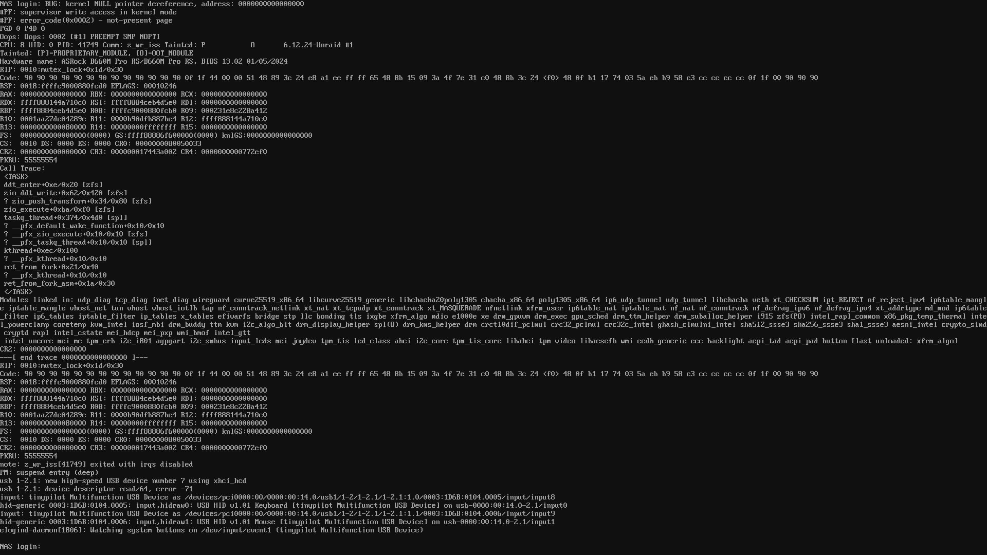

Even using zpool export -f hddpool I don't get the command prompt after. I restart the system and the pool is still there and I can't stop the aray. I observe an error on the console and I'm providing that as a screenshot and also the error log.
Uploading Attachment...Uploading Attachment...
I decided to come up in safe gui mode and that stopped the aray. I've recreated the pool and restarted. I no longer see the high CPU cores. I'm about to create shares. Wanted to let you know so you don't waste time looking at the log and screen shot. I'm probably good now. Will confirm in a little while
