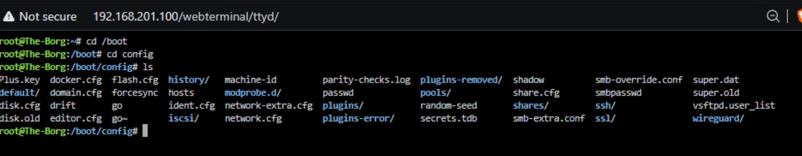

the only file I would want form the backup config folder for me to reuse my usb, license and no configurations is the *.key files in the config folder:
example of files you will see inthe config folder you need to copy off as a backup
