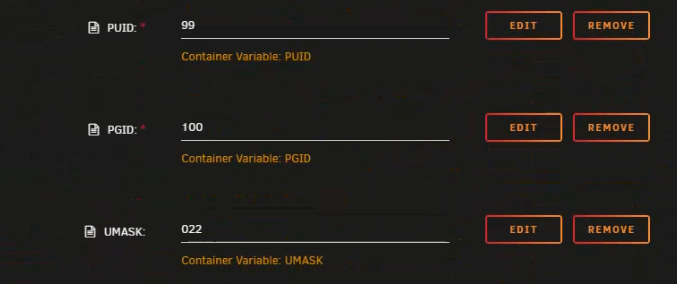

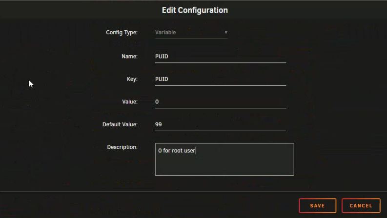

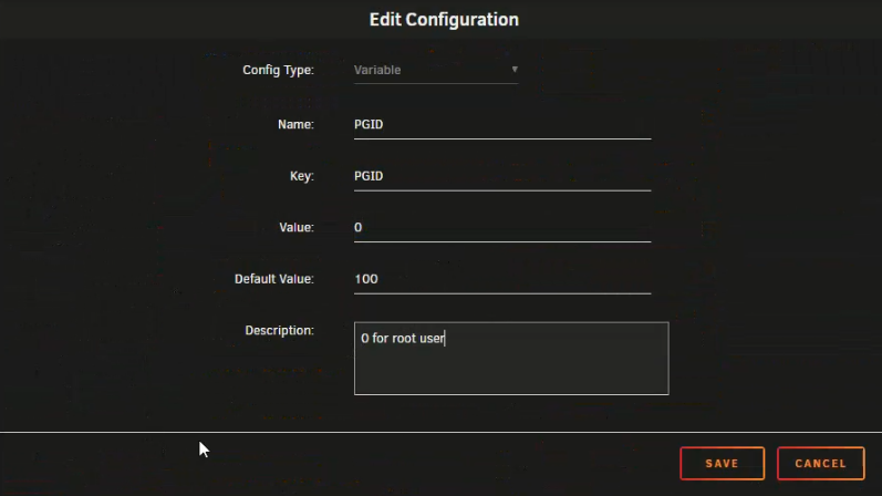

Jelly fin may require additional data such as PUID and PGID
this said due to general file access and permission sometimes that is not enuoth and there is a need to run as the root user... the pgid and puid is set to 0
