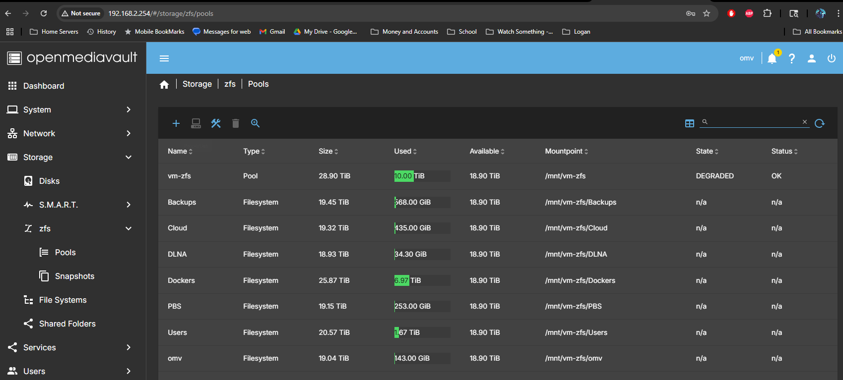

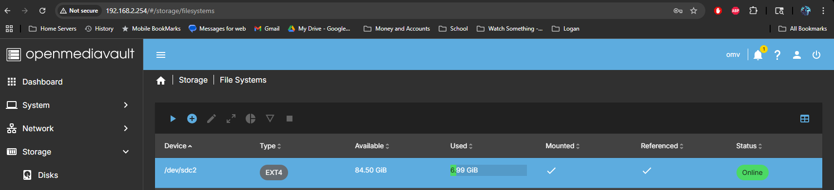

June 5, 20251 yr Community Expert 7 hours ago, ssmith369 said:Thank you both so much for the replies. I am going to give the bind option a try initially with one TV Show sub-folder to see how it works.@bmartino1 Regarding the OMV. does that boot from a USB in a similar way to Unraid? I am not sure if I can get the Zyxel NAS 542 to boot from a USB?Many thanksthe zyxel is kinda locked down.Yes and no. the usb/sd card becomes the OS install disk. Yes, the usb is like unraid on the zyzel where the os lies. no unraid loads in ram whereas OMV stay on physical media.Requires installing a kernel and flashing Debian to the flash drive and telling zyxel linux to boot the flash drive...More example non english (google translate to english from german)https://seafile.servator.de/nas/zyxel/images/nas5xx-debian-howto.txtAS it is a "Hack" to give the device more and better functionality (gets you out to the 16 TB volume issues...)https://forum.openmediavault.org/index.php?thread/5179-installing-omv-on-zyxel-nsa325-arm/as example, my OMV install is less then 10 GBthjis is runnin g docker with 3x 16 TB in a raid z1Similarly to edit the fstab for binds you have to run a hack to allow editing the fstab so a reboot will load your curent fstab and teh bind mount...the space makes it hard. that looks correct./i-data/c8c5d1df/video/TV Shows/Show 1 /i-data/a96dfbf8/video2/TVShows2/Show 1 none defaults,bind 0 0 ?i think the line would be:/i-data/a96dfbf8/video2/TVShows2/Show\0401 /i-data/c8c5d1df/video/TV\040Shows/Show\0401 none bind 0 0Notes:Use \040 in place of spaces (\040 is ASCII for a space).none bind is enough; no need for defaults.example of what it should look like now:zyxel nas fstab/dev/ram0 / ext2 defaults 0 0none /proc proc defaults 0 0none /sys sysfs defaults 0 0none /dev/pts devpts defaults 0 0# Bind mounts (below)# TV Show bind/i-data/a96dfbf8/video2/TVShows2/Show\0401 /i-data/c8c5d1df/video/TV\040Shows/Show\0401 none bind 0 0as Zyxel NAS runs a BusyBox Linux under the hood. To make your bind mounts persistent:*Make a boot script.../i-data/sysvol/.system/rc.d/S99bindmounts.sh#!/bin/sh# Bind mount TV shows on bootmount --bind "/i-data/a96dfbf8/video2/TVShows2/Show 1" "/i-data/c8c5d1df/video/TV Shows/Show 1"*Create a boot scriptCreate a file called something like S99bindmounts.sh in /i-data/sysvol/.system/rc.d/ (this path may vary slightly — check your actual volume).*make sure the script can run...chmod +x /i-data/sysvol/.system/rc.d/S99bindmounts.shat reboot make sure script ran / fstab stayed...cat /etc/fstabmount | grep video
