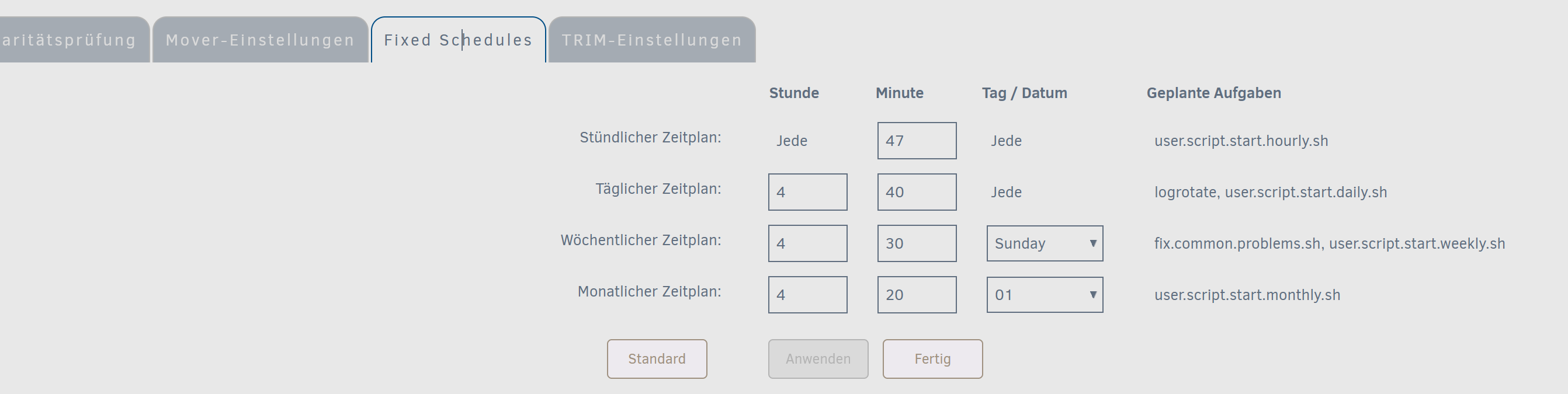

As I have told you, the standard UNRAID maintenance Job runs at that time (invisible to the user scripts).
As you can see: logrotate, user.scripts.start.daily.sh and so on.
So unless you have some user scripts, take a look at logrotate.

i must be missing where you see this in the gui i assume this is under schedule all i have is Parity, mover, and trim settings (no advanced tab). i am very gui dependent. i was running this through chat gpt and it was telling me to go through the terminal and look at the logrotate. i was looking at some of the code it was providing and running it through my test server, to see if the code is right. it was giving this as the code to run in terminal
Need to install the "Dynamix Schedules" plugin to see/edit those.
