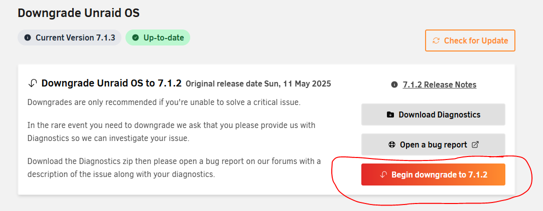

Click Tools - Downgrade OS then you should see the option to downgrade:
Unfortunately I don't have a gui so I can't get there
