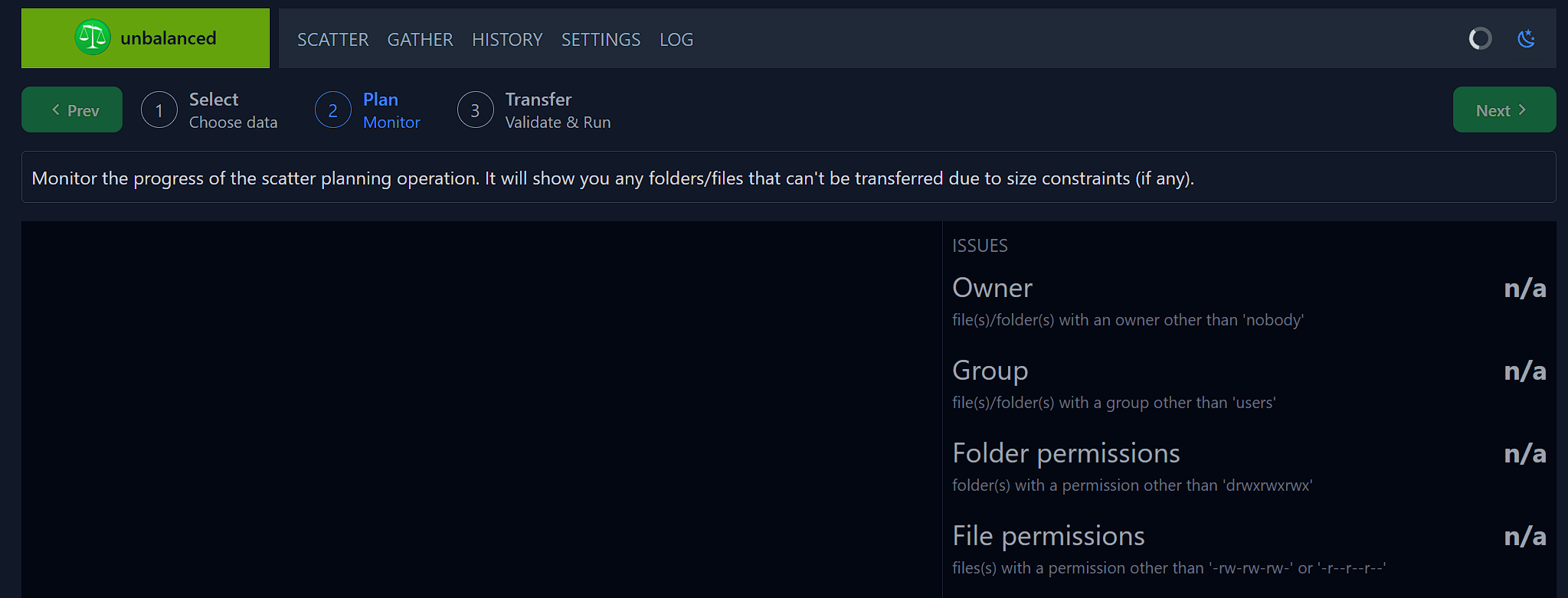

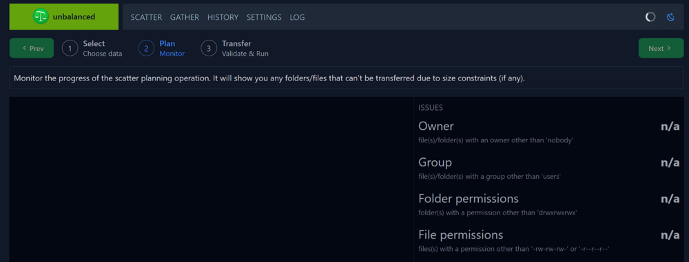

Edit 2: I am trying to move files from the failed/dead drive using Unbalanced. The Plan screen doesn't seem to be doing anything; the top right has a wheel that is spinning, but I don't really see any progress. How long does this step usually take? The dead drive has about 17TBs of data on it. Do I just need to wait it out? image.png
Edit 3: Yeah, it just took a while to complete, ~30 mins
