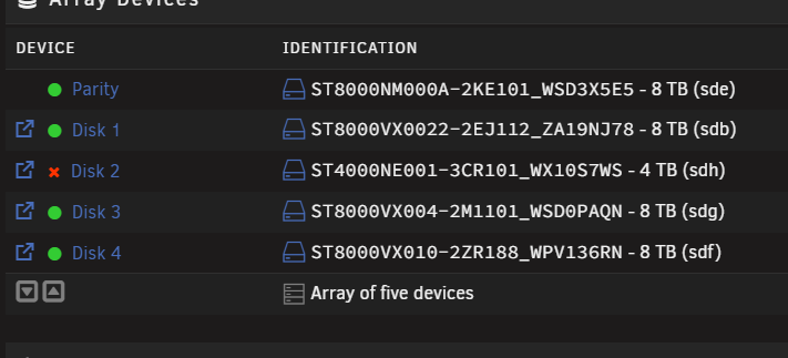

I wanted to run Parity Test, with correcting any found error's, but just after couple of minutes it stopped and Drive 3 has been disabled; so I look into our forum, for a solution and after couple of minutes I did this:
https://forums.unraid.net/topic/137130-device-is-disabled-contents-emulated-what-to-do/#comment-1247568
it recovered my data on Drive 3, so after that I wanted to check parity again, but it got even worse; after couple minutes same problem appeared with Drive 2, so again, I've tried with SYNC method, but it stops, and now it looks like this:
Im asking for a help; what steps should I do now, where to start?
Im completely have no clue with that. Thank You for Your understanding.

Looks more like a power/connection problem, cables, splitters, etc.

17 minutes ago, rogales said:
but after some time it restarts, and can't be accesibe - so it's completely random. I think that electric side of the drive is corrupted.
Did you try swapping cables/slot with a different disk to make sure the disk is really the problem?
