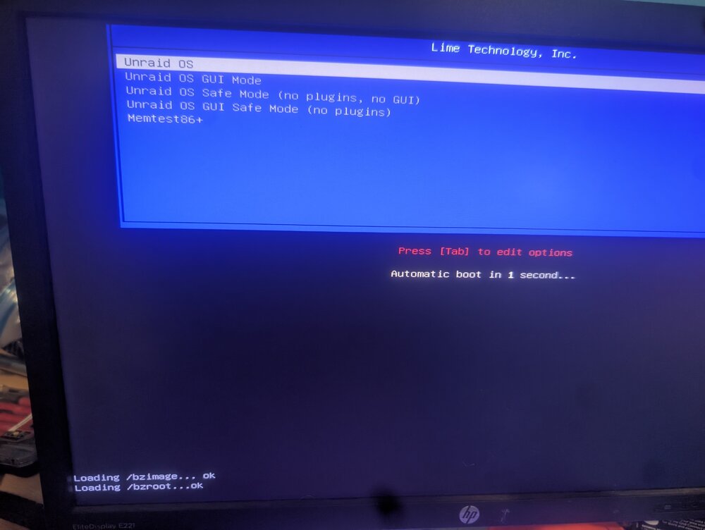

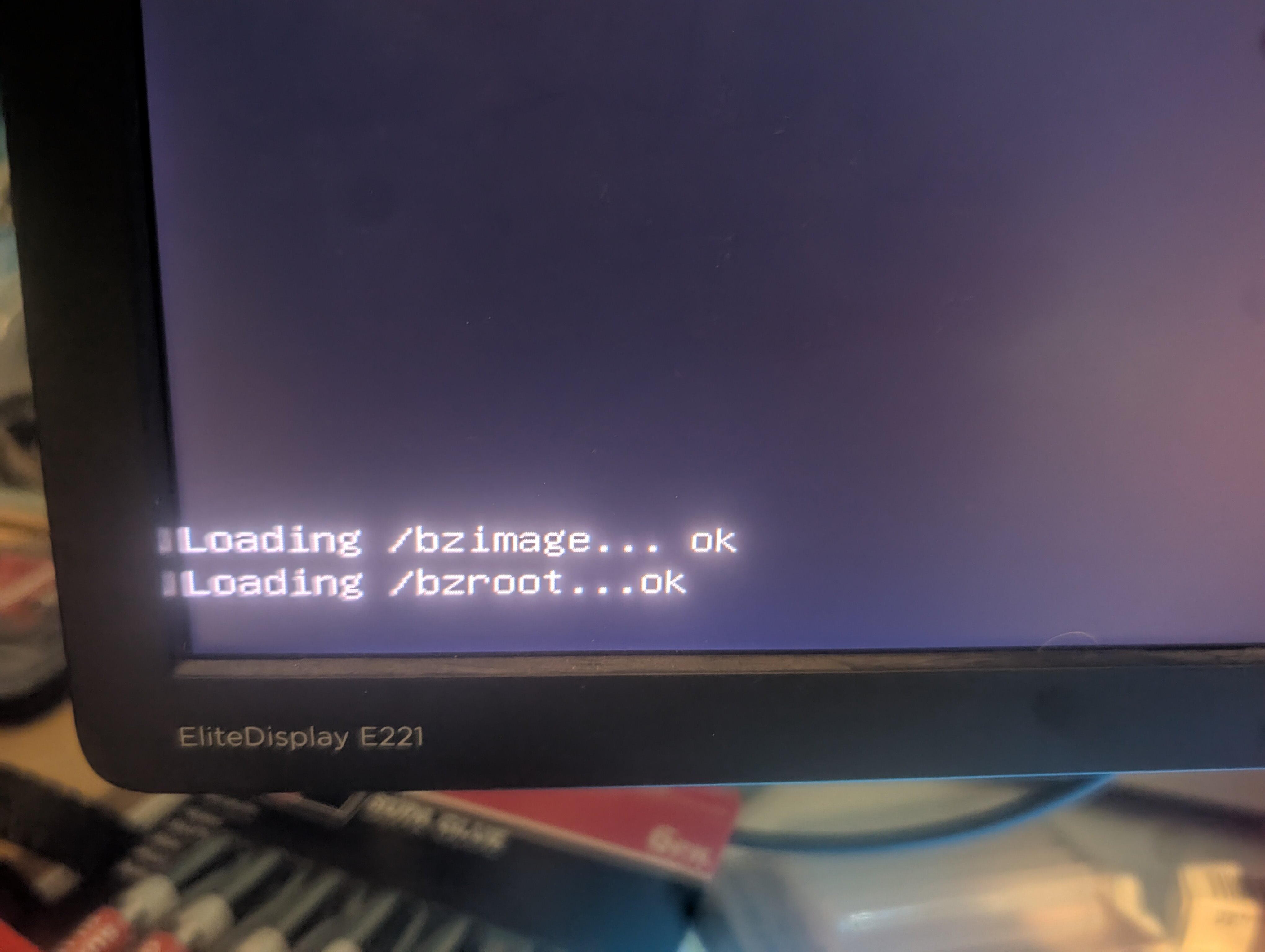

A couple hours ago I updated from 7.1.2 to 7.1.3. The upgrade went smoothly. I later noticed that there were a couple dockers waiting to be updated. I tried updating 2 of them, but each time it never actually updated. I waited a very long time before I moved to another screen within unRAID.
Then I tried installing an app. It showed that it downloaded stuff in the update window but it never actually finished. I remember it saying something about a file couldn't be find locally, it something similar to that. I'm the end the UI become unresponsive so I had to turn the server off and back on again, but now it won't boot up.

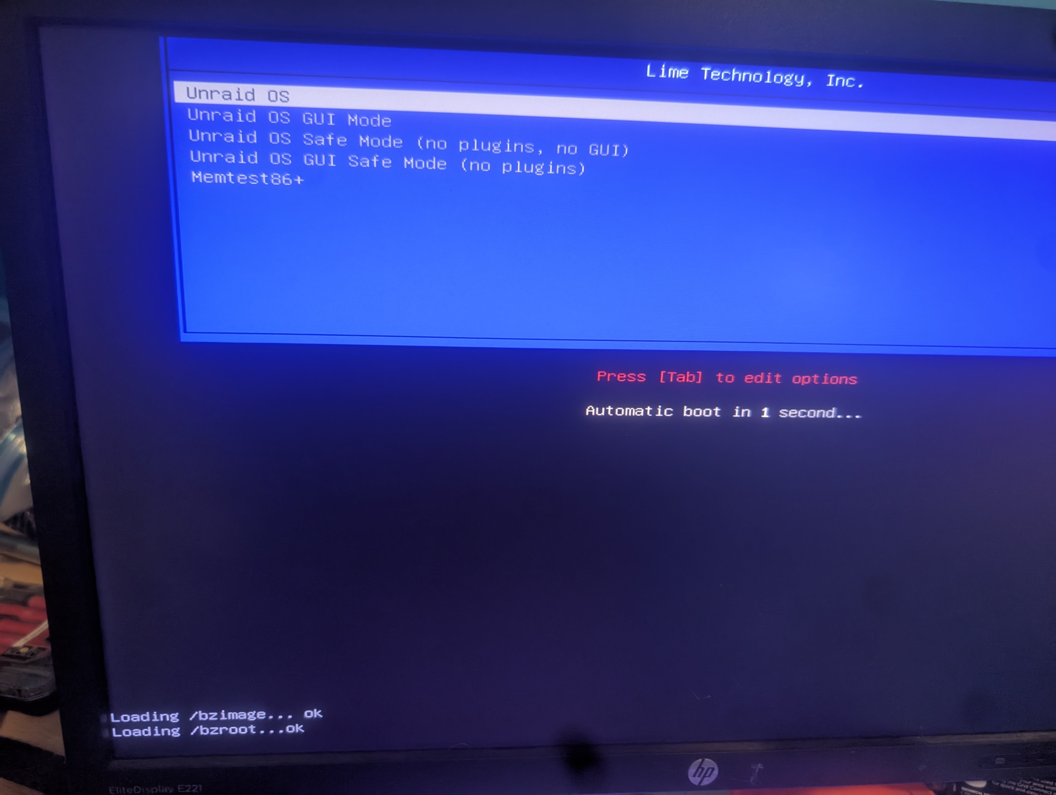

The server tries to start, but then gets stuck. I'll share two pics if what I see, my apologies for the quality, the camera part of my phone is damaged.

Try recreating the flash drive, first backup the current one, then recreate it using the USB tool, confirm the flash drive boots with the stock install, and if yes, restore only the /config folder from the backup overwriting any existing files.
