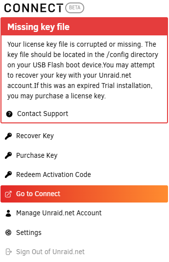

Since I turned my server back on, I've had this alert:

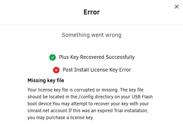

I tried to recover the key, but I got this error:
I have a valid key, I recently upgraded from Basic to Plus a few days ago and I had upgraded my key.
I've looked at the flash drive on my PC and I've got the /config folder with the key files in it.
What can I do?

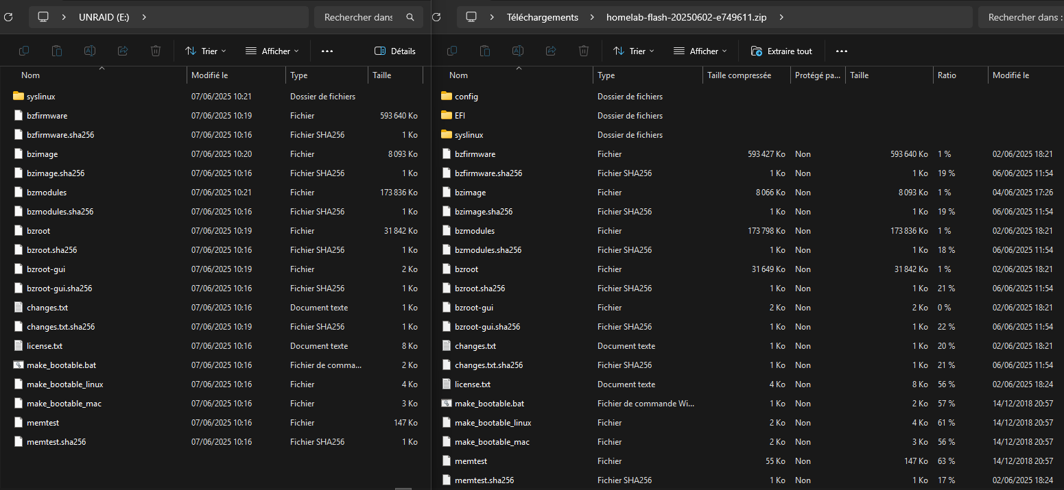

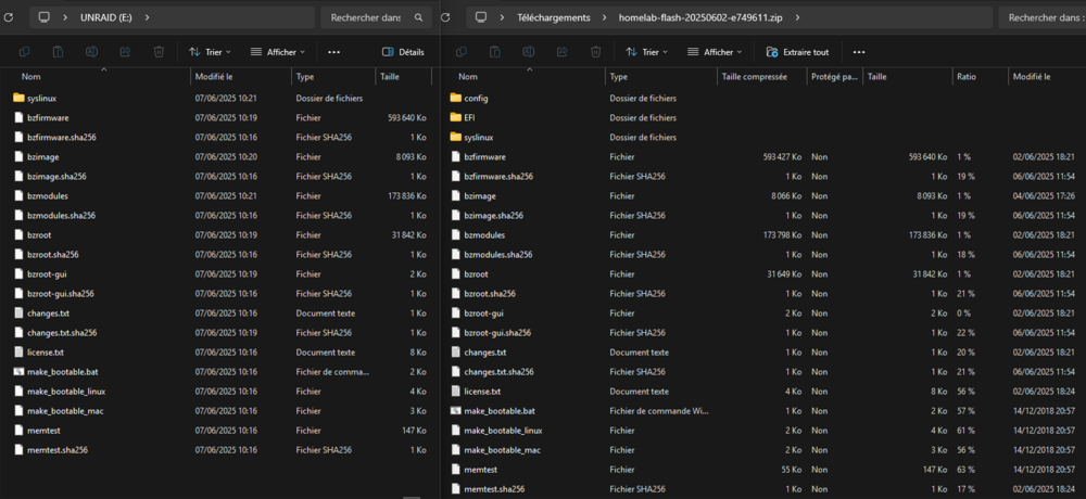

@JorgeB I have just tried to restore the same ZIP to another flash drive and same problem here, as you can see on my screenshot (at left the new flash drive, at right the content of the backup ZIP file):
/config and /EFI are missing, and those folders are not empty on the backup ZIP file.
Unraid USB Creator told me that the restoration was complete.
My key is 4GB, the backup is only 719MB. The other key is 256GB. So free space isn't the problem here.
