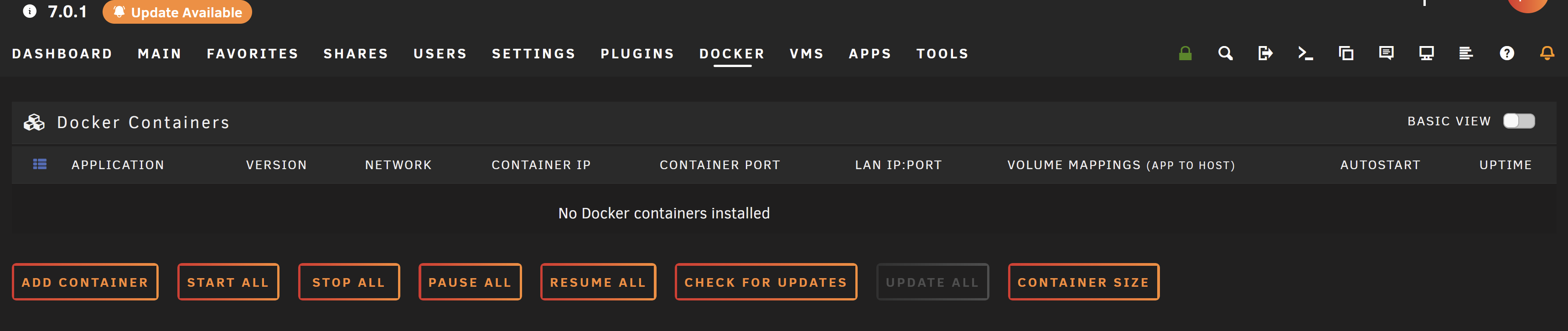

This is the second time all my docker apps have disappeared in the last year.
  • I was in the process of changing SMB settings in Unraid (enabling "hide "dot" files") so I was forced to restart the array.
  • The first time I tried to restart the array I got the usual error saying "Unmountable: Unsupported or no file system" on some of the drives. This has occurred before and I have never found a solution to it other than attempting to restart the array a couple of times. So I did a restart of the array through the GUI.
  • After restarting the array all my docker apps were gone:
WTF Unraid...
This is the second time this happened. 😵 Last time was after I upgraded from 7.0.1 to 7.0.2. I had to restore everything and spend two days on configuring it correctly.
I have attached the diagnostics.

  • I go to the docker tab and the same error "No docker containers installed".
I know I can re-install all the docker apps but to what end? I did that previously and here we are again. This is probably going to continue happening. What should I do?

Some pools showing up as unmountable is related to encryption, they are not being correctly detected sometimes, suggest updating to 7.1 and retesting, if it still happens you should create a bug report.
Regarding the missing containers, it's using a new docker image, it was created when the pool that had it didn't mount, when all the pools are mounting again, delete them all and recreate:
https://docs.unraid.net/unraid-os/manual/docker-management/#re-create-the-docker-image-file
Then:
https://docs.unraid.net/unraid-os/manual/docker-management/#re-installing-docker-applications
Also see below if you have any custom docker networks:
https://docs.unraid.net/unraid-os/manual/docker-management/#docker-custom-networks

As you said, cache and delta failed mounting earlier today. Since the cache disk holds the docker image the system could not find it and must have made a new docker image. But where?
For future readers here is the process I did:
  • I deleted the docker image at /mnt/user/system/docker/docker.img
  • I started the array. The system could not mount disk 1 and downloads so I tried to start the array again. This time all disks mounted successfully.
  • Now I see that the locations of appdata-share, the system-share and the vm-share is suddenly on a different disk, probably because the cache disk failed to mount previously.
  • I changed the location of these shares from downloads to cache in the share settings.
  • I see that I still have a 161 GB docker.img file in /mnt/downloads/system/docker). So I make a backup of it —just in case.
  • I also have a 161 GB docker.img file in /mnt/cache/system/docker/ So I make a backup of it —just in case.
  • Then I add /mnt/cache/system/docker/docker.img to the "Docker vDisk location".
  • I delete the appdata, system and vm in the downloads pool.
  • I enabled the Docker service again.
  • I go to the Docker-tab and all my dockers are back again 😃👍
