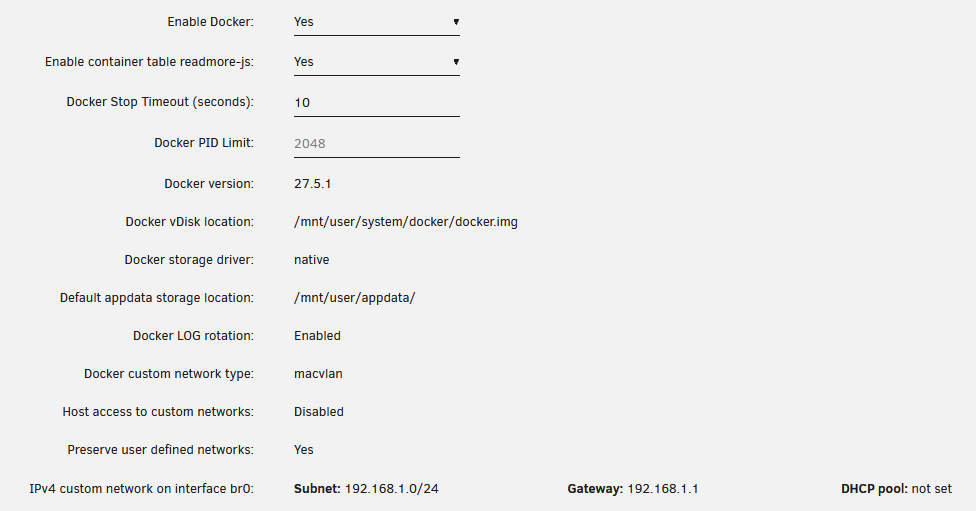

what are your docker settings and where is your docker vdisk
usualy unraid by default has a system share. the system share need to be set to a primary only. As this soud like mover is moving the docker image between disk and making a broken / corupted vdisk image between 2 disks.

Here are my docker settings. /appdata and /system shares are on Cache drive only.
