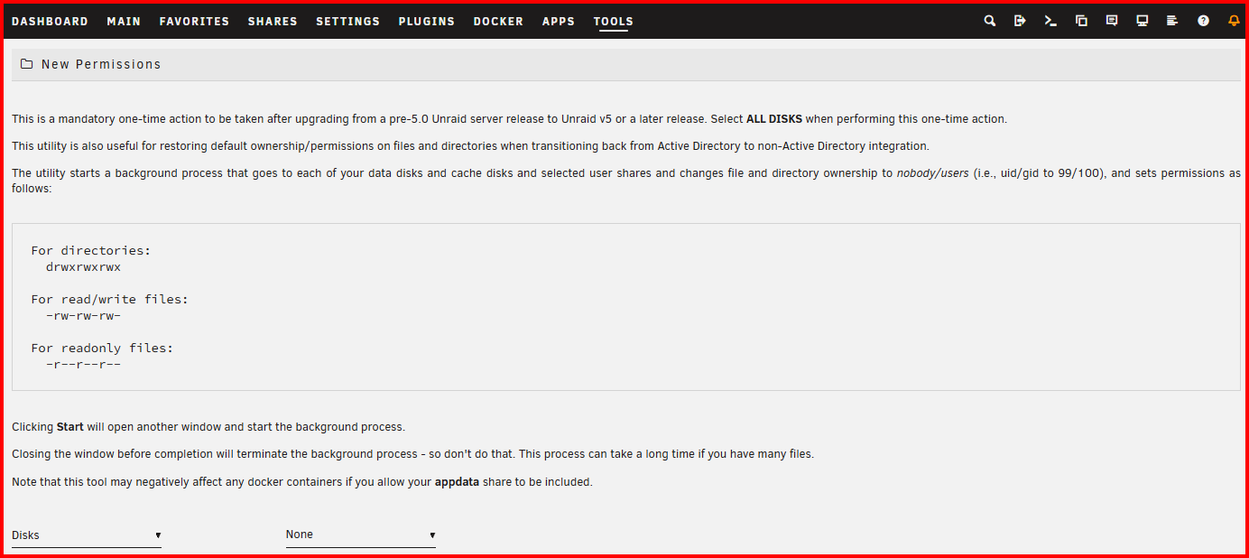

About the tool. Here is the screen, what changes would you suggest to the wording?

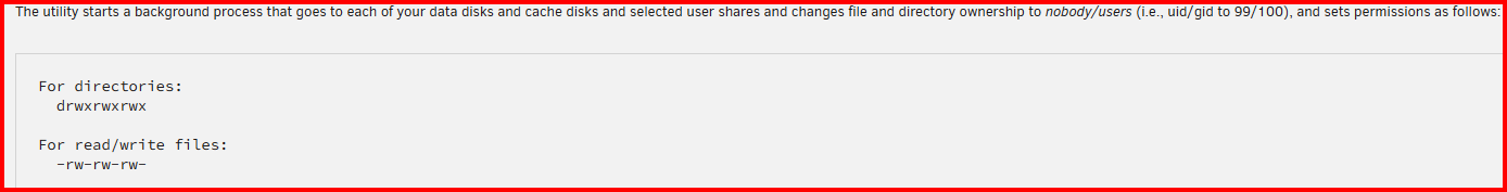

This section of the tool tells you what settings have to be to work.
There should be no read-only files in user Shares today and I have no idea why that carried over. (One piece of minor information, SMB will often set the 'x' bit for 'owner'. This is relativity harmless in the greater scheme of things except to the Linux purist.)
Thanks for your detailed response. You are correct, this is entirely my fault for running this on my cache drive and not on the downloads share - which would have helped. I suppose I'm more used to a UI holding your hand a little more, if it saw that you were going to run this on the appdata or system folder, maybe another warning would be useful? Maybe default to Shares as the first option - not Disks?
I agree with you on this one. Since you are the one who had a problem (squeaky wheel), I would suggest that you make a 'Feature Request' (about four subforums below this 'General Support' one) and ask that this be done and point back to this thread. And while you are about it, Under the 'Share' setting, suggest getting rid of the 'All' option!
