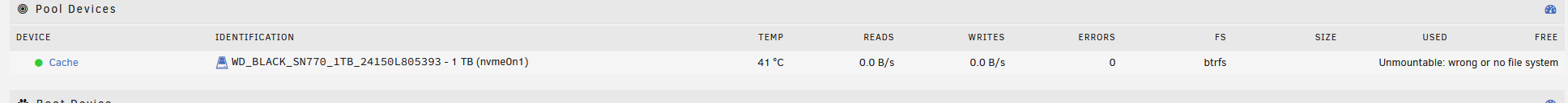

When it came back online, the cache drive was showing a size of 0B and a file system problem.

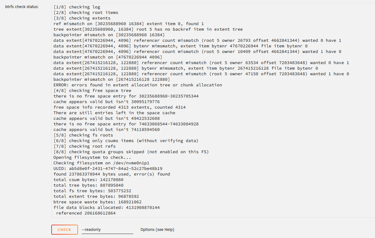

I stopped and started the array in maintenance mode to run a check on the drive.
It showed this:
The cache drive is NVME and formatted for btrfs.
Attached are the diagnostics.
Any advice on how to fix/recover the drive?

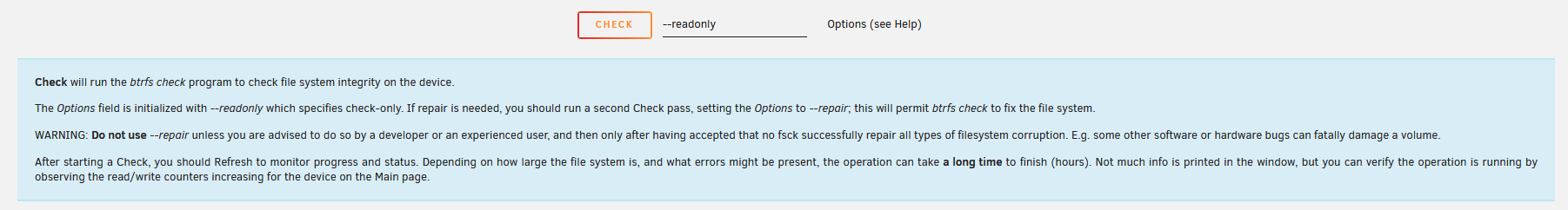

Reading the documentation here: https://docs.unraid.net/legacy/FAQ/check-disk-filesystems/
It states:
  1. If the file system is XFS or ReiserFS (but NOT BTRFS), then you must start the array in Maintenance mode, by clicking the Maintenance mode check box before clicking the Start button. This starts the Unraid driver but does not mount any of the drives.
  2. If the file system is BTRFS, then make sure the array is started, and NOT in Maintenance mode.
However, I am only able to run the check in maintenance mode, although it shows that the drive is btrfs.
That documentation also says that the scrub command should be used for btrfs, but I can't as it shows it is only available when the filesystem is mounted, and not being able to mount it is my problem.

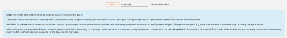

I'm given this warning about running the Check with --repair
But I can't find anything else that I can do. Is there any other step I can take before doing this?

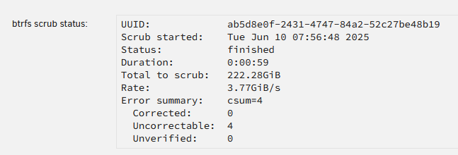

I ran the scrub and here are the results:
Attaching diagnostics just in case, because I'll be gone at work.

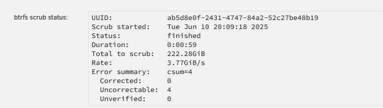

Ran the scrub again and looks the same:
What would the next step be?
11 hours ago, JorgeB said:
First thing to do it to fix the RAM, once that's resolved, scrub the pool again.
Look in the syslog for the list of corrupt file(s), they should have been logged during the scrub, those will need to be deleted/replaced from a backup, then run another scrub to confirm 0 errors.
