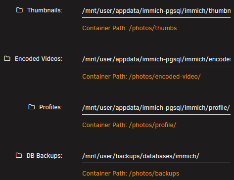

My Immich container is loosing mount points, I feel like an idiot and not sure what might be wrong:
This are my mount points:
They can be confirmed in the portainer(ignore extra ones):
And normally when I inspect the folder I should see something like below:
However, every single day I have immich issue in the log etc. saying that it cannot find "encoded-video" folder, then when I check what is in the folder:
Simple container restart fixes the issue, but why, and how is it possible that it loses the access?
I have 72 containers running, there are no issues with anything else, only with Immich.
My appdata is on zfs and files are not moved to the array, there is nothing else using these files, immich is running under 99 user and all files have proper rights. What is happening with this thing? Please advise.

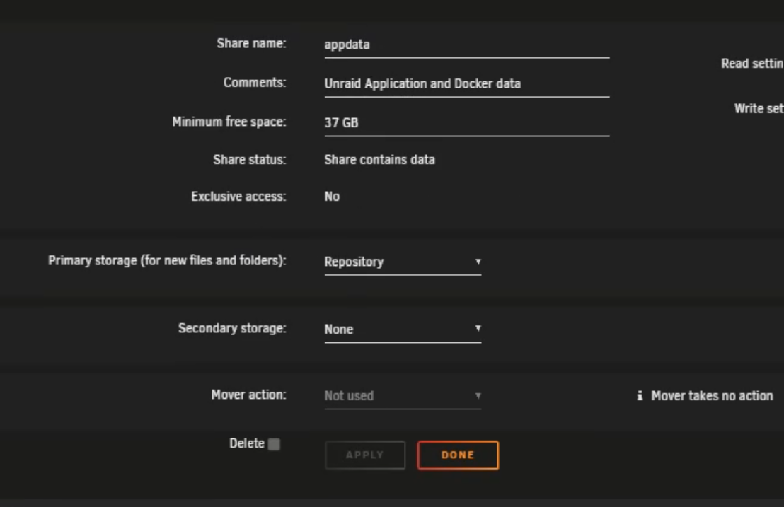

My appdata share was set in following way main storage - cache, secondary storage array, mover: cache<-array. So technically my files should not move from cache, especially when I have 2TB on the cache and it is never over 50% of utilisation. However anything was possible, hence why gents on discord advised to disable secondary storage, enable exclusive shares etc. And guess what, unfortunately same thing. The 3 folders were gone this morning and immich spammed me with issues.
My cache is using zfs mirror, hence why I said I might use /mnt/cache/appdata/etc... because that is the right direct path to the file, however what I have done this morning, I removed the affected 3 binds(left thumbs as there are no issues with it, and this one MUST be on nvme).

We solved the issue in discord, basically immich creates subfolders under it's preconfigued "photos" path. Those folders have to exist in their location regardless if you set their location to another share entirely.
For example, these folders cannot be deleted(left photo) otherwise the link is broken even though these folders have been set to a different location (right photo):
The OP seems to have mover deleting the empty folders (left photo) when mover is ran which results in a broken link.
Edited by MowMdown
Tested, folders moved to disk1, mover doesn't remove them anymore, link bewteen host and docker is no longer broken. Hopefully this might help someone in the future.
Keep in mind, do not keep dummy/empty folders created by immich on cache drive.

the issue is that you have secondary setup at all appdata should not and can't support this
""""""""secondary storage array, mover: cache<-array""""""""""
Remove secondary and make sure all files exist on 1 primary disk for data and location.
as new fiels are written to the primary disk and previous data doesn't exist on cache...
