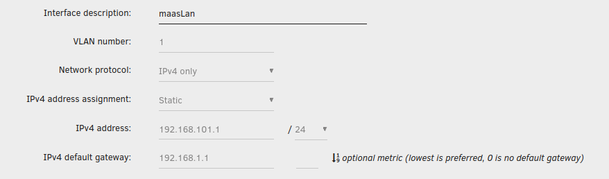

June 9, 20251 yr Trying to play around with some VMs and I'd like to create a group of VMs on their own network w/ static IP addresses. I've created a VLAN in the network settings page:I can assign this bridge network to the VM, manually configure an IP address (in this case 192.168.101.2) and gateway (192.168.1.1) but I still don't have internet connectivity. What am I doing wrong?

June 10, 20251 yr Author Using the above settings I can ping unraid on both 192.168.1.10 (my default IP) and 192.168.101.1 (the vlan IP) but I can't get any internet connectivity through my gateway (192.168.1.1) Should there be another rule added to the unraid routing table?
June 10, 20251 yr Community Expert 21 hours ago, Fffrank said:Trying to play around with some VMs and I'd like to create a group of VMs on their own network w/ static IP addresses. I've created a VLAN in the network settings page:I can assign this bridge network to the VM, manually configure an IP address (in this case 192.168.101.2) and gateway (192.168.1.1) but I still don't have internet connectivity. What am I doing wrong?The gateway is not in the subnet. You need a router between them. This is not an Unraid configuration would need to be a VM or physical device to link the two networks.
June 10, 20251 yr Author 3 minutes ago, SimonF said:The gateway is not in the subnet. You need a router between them. This is not an Unraid configuration would need to be a VM or physical device to link the two networks.So it's not possible to have two different isolated networks for VMs to live on without external routing?
