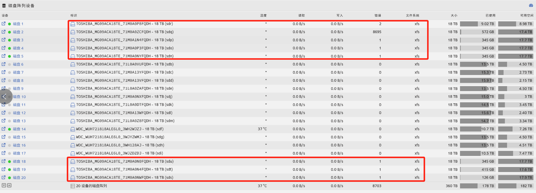

This is a previous webui screen snapshot.

All the external disks are dropping offline at exactly 4.00am, that suggests something automated cutting the power or similar to the enclosure.
Agree with Jorgeb. Curious your psu?
