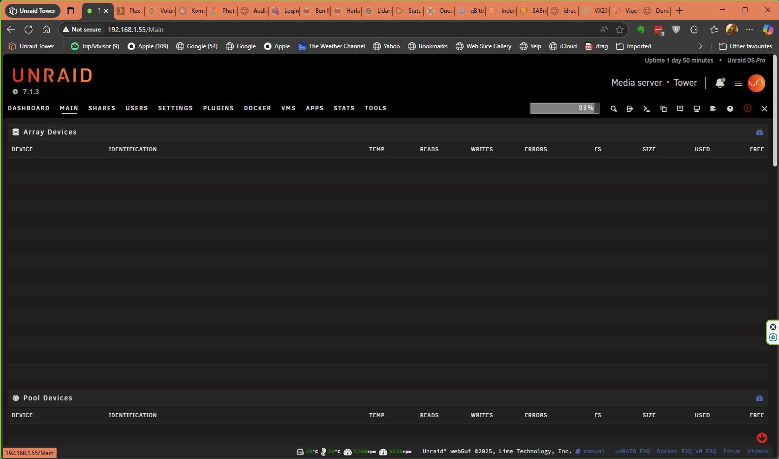

Some parts of the GUI are not showing text, the text is there but invisible. So For example on the main screen, the drive list is there but invisible, but the list of unmounted drives below is showing perfectly.

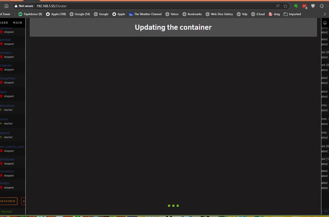

Other screens work perfectly, and some dialogue boxes are blank as well - such as updating dockers.

Diagnostics attached, but from the current boot where the text is all present. Screenshots showing the effect also attached.

Thank you for confirming its not cache and the use of another client matching showing the same. Then yes this is usual the early signs of ram issues and usb flash MTF with read write of a USB.
Unraid exist entirely in ram if the linux applications are reading and writing n a bad ram sector ths can cause webpage and text distortion.
at system boot I would suggest a mem test to rule or faulty system ram. while you can, I also suggest making a unriad flash drive backup.
The webpage your visiting are php runnign scripts and other so a verbose output not dispaly is some form of OS corruption. thus, i recommend checking ram.
