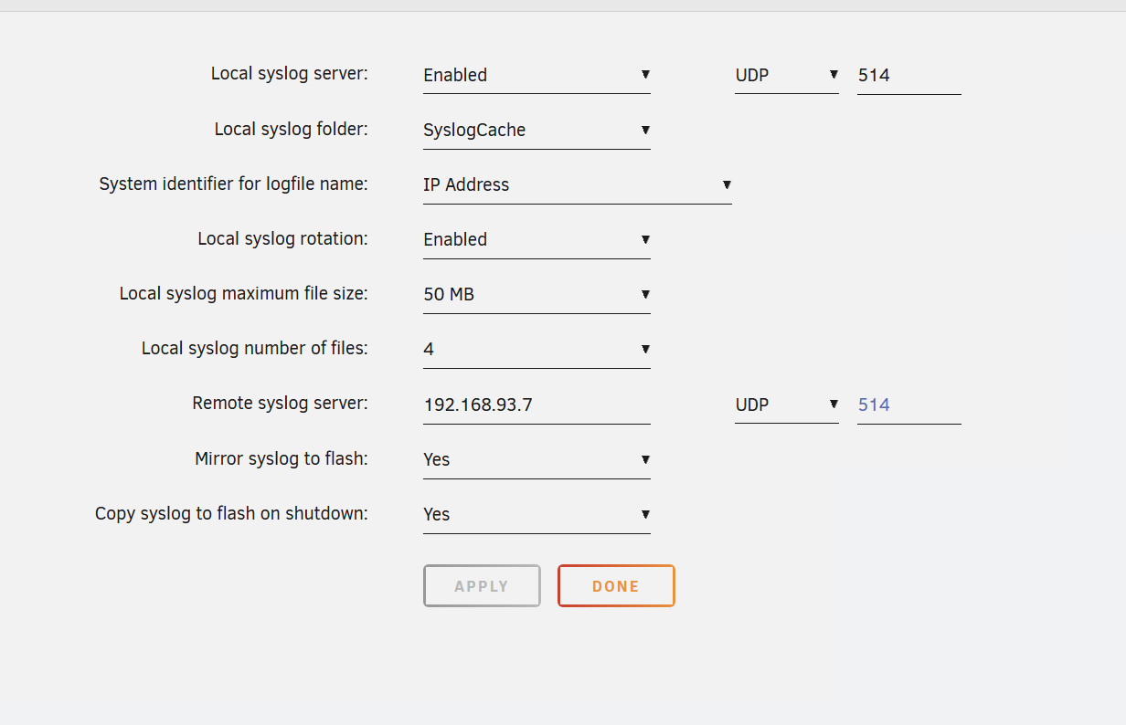

I think this is already enabled? The log is in the diagnostics as syslog-previous.txt.

Unfortunately, there's nothing relevant logged, this can also be a hardware issue, one thing you can try is to boot the server in safe mode with all docker containers/VMs disabled, let it run as a basic NAS for a few days, if it still crashes it's likely a hardware problem, if it doesn't start turning on the other services one by one, including the individual docker containers.
